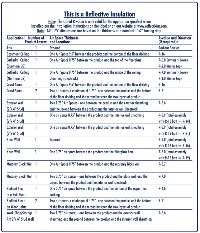

Moderators SeaDawg Posted June 7, 2022 Moderators Posted June 7, 2022 When we were building our sips home, LEED standards required insulating every solid wood component (headers, lvls, posts, etc) as a thermal break. We used reflectix. My LEED advisor said it added only r1, but it helped with sealing the structure. The firring strip interstitial space took the rvalue to maybe 6? If I remember correctly. An inch air gap between two layers of reflectix type insulation may help more. I don't know. Rvalues require testing, but not within my capability. I don't have any of your current insulation in my 2008 trailer, just air gaps, and I've been good into the high teens, if it warms above freezing daytime. I'm not a serious cold weather camper, so it works for me. Slideouts have always been problematic for us, in motorhomes. They leak cold or hot air, and allow the mosquitoes in, as well. 2 2008 Ram 1500 4 × 4 2008 Oliver Elite, Hull #12 Florida and Western North Carolina, or wherever the truck goes.... 400 watts solar. DC compressor fridge. No inverter. 2 x 105 ah agm batteries . Life is good.

Moderators SeaDawg Posted June 7, 2022 Moderators Posted June 7, 2022 Newer technology widows, properly sealed and installed, can have an r value of 5 maybe 6. My windows don't feel hot in the sun, even on the west and south sides. There's some really thin metallic layer in there, that blocks uv and heat, but barely changes visibility. Can't speak to the cold, as I live in Florida. I'd "guess" my Ollie double panes are much lower r value. The shades help. And, some hardy cold weather campers use reflectix to increase it. I have, in Alaska, with crappy single pane windows. Dual purpose-- let's me sleep at night, with the midnight sun. 1 2008 Ram 1500 4 × 4 2008 Oliver Elite, Hull #12 Florida and Western North Carolina, or wherever the truck goes.... 400 watts solar. DC compressor fridge. No inverter. 2 x 105 ah agm batteries . Life is good.

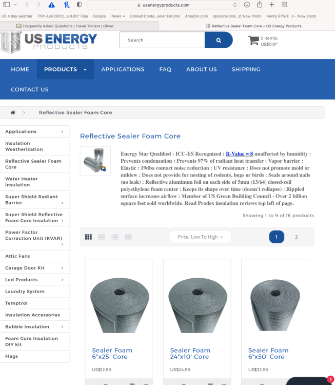

DanielBoondock Posted April 21 Posted April 21 (edited) On 6/7/2022 at 9:20 AM, John E Davies said: I don't know the brand they use I believe previously they used foil bubble wrap, but more recently (as of five years ago it seems) they're using Protex AD10 10mm 1/5” R22 insulation. This was taken from the following long video playlist with nerdy construction details. The bottom outer is wrapped, and the upper inner. Additionally for (all - some?) of the trailer there is an internal honeycomb material that is spray and fabric fiberglassed. This will have some R value due to those dead air pockets. As an engineer type I've thought about this design, it's interesting. Conventionally in a structure you want a single vaporbarrier with two climate zones. But having the double hull they have three, in trailer, in wall, and outside. This means that the between hull space is it's own climate and can potentially have condensation issues of it's own. This is why they added the drain holes along both sides. Normally that would be a poor design, but if you think about it, it's not much different from your attic or crawlspace. Both need air vents (ridge/soffet vents and foundation vents) to prevent humidity buildup, but also provide an insulation 'barrier zone'. In summer my roof will get to 100+ degrees, but I measure less than that in the attic. If I had a Protex barrier glued between the rafters, it should be roughly air temperature, which in a sense buffers the temperature from the roof which acts like a heat sink. For comparison consider, of all things, the James Webb Telescope design with it's five layers sun shield Quote Why does the sunshield have five layers instead of just a single thick one? Each successive layer of the sunshield is cooler than the one below. The heat radiates out from between the layers, and the vacuum between the layers is a very good insulator. One big thick sunshield would conduct the heat from the bottom to the top more than five layers separated by vacuum. Now the inner space is heat conducting air and not insulation vacuum, but I'd think at least that should provide some buffering of the temperature gradient. Additionally, since the ducted heating runs along the water pipes below, during the winter at least that waste head isn't wasted - it goes into warming up the inner wall. And during the summer months, the outer takes the brutal heating from the sun which should be a lot of radiative, and the double foil deals with that. tl/dr ... basically I think it's possible it comes to some pretty high insulation R value given all these factors, maybe even R22. A test would be something like putting a trailer in some hot desert and seeing how long it takes to warm up an insulated box which is pressed/taped against the wall. It would give you a rough idea at least, should be pretty good I'd think. Edited April 21 by DanielBoondock 2 Oliver Elite II Twin (order late summer for MY2026)
