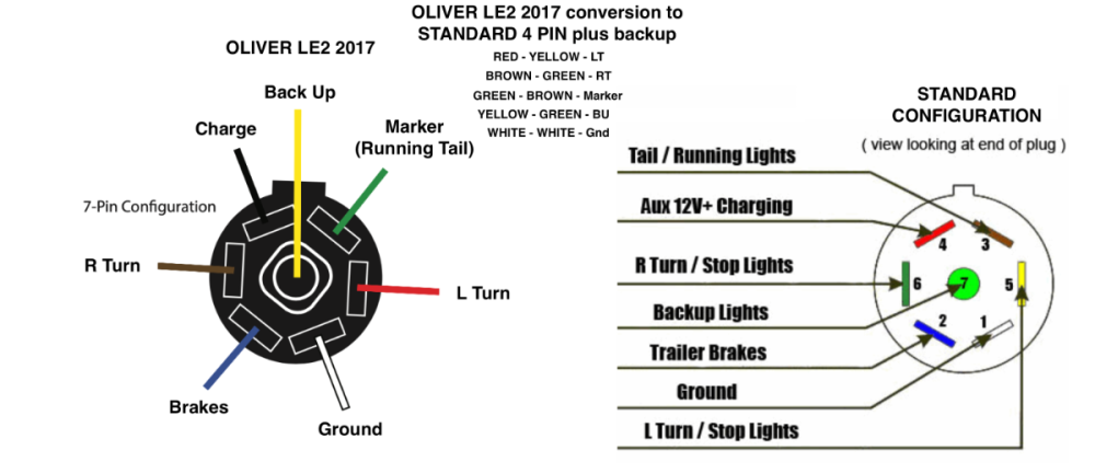

We had a camping van with multiple electrical problems. Several RV service departments looked at our electrical system and couldn’t figure out the problem. After several months, our local service station ended up solving our mystery. An electrical wire ran part way across our floor, under the tough vinyl flooring and over two or three years the insulation had worn through. The symptoms varied, I believe, based on how much weight was on the wire and how good the connection was from the wire to the frame.  I have very little experience with electronics, but maybe some else can chime in on weather a similar worn or damaged wire could be causing your problems. Good luck! Carrie and I definitely can relate to your situation.
Kirk

If Oliver used industry standard color coding on the wires, it would not be a big deal, but they do not!  This is crazy, they changed four of the five colors to the rear lights:
This is possible, the wiring on Olivers is very good compared to the SOB trailers in terms of protected harnesses and looms, but to the best of my knowledge they still do not secure the loose wires properly at the terminal ends, the connections. This results in wires falling off the water pump, for example. So while we are not literally “walking on wires” there could be failure points. My trailer Hull 216 had completely unprotected main battery cables, the soft rubber insulation was wearing away from chafing the steel battery tray. It was a serious fire hazard. Having to string a new wire to bypass an unknown fault is not something a tech or owner wants to do, but it could be necessary if detailed methodical troubleshooting and physical inspection doesn’t find the cause…😳
