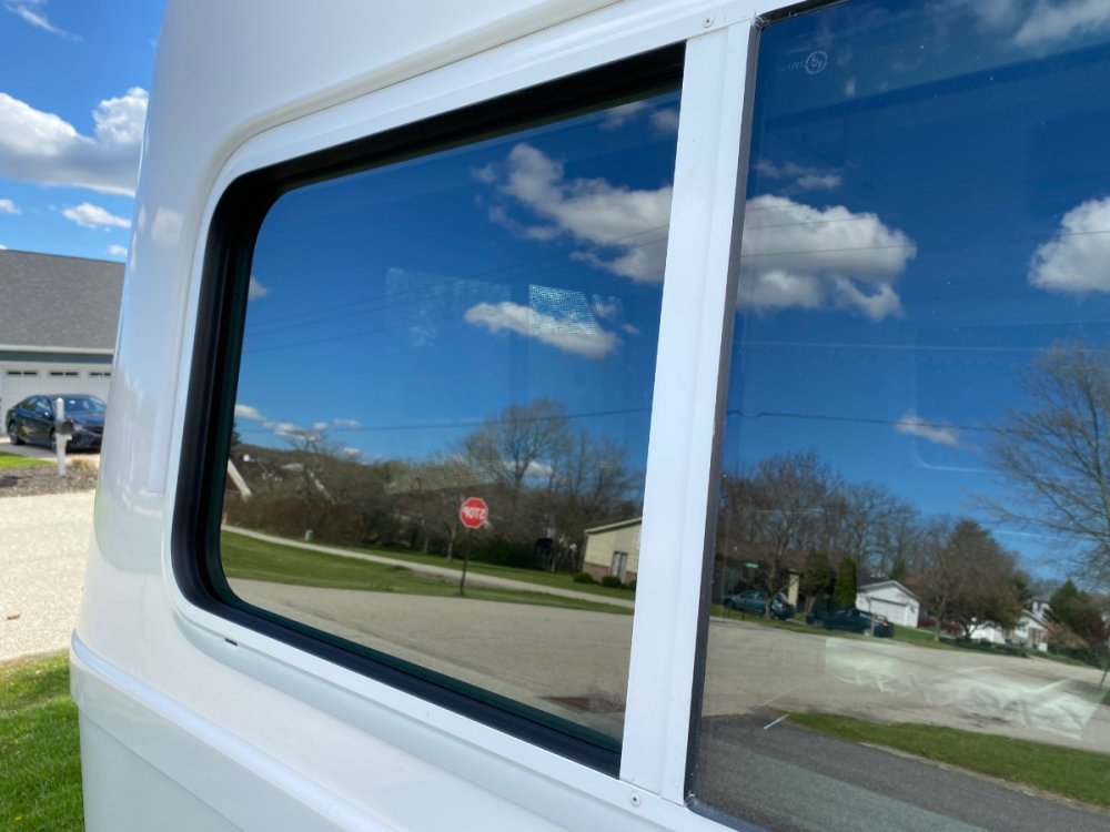

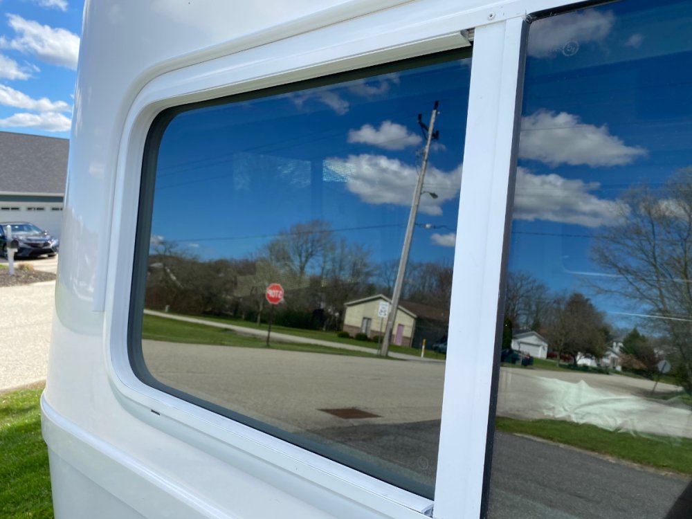

Frank C Posted November 20, 2022 Posted November 20, 2022 20 minutes ago, Jenna said: Of those who switched from white to black, have you had any issues with streaking? I changed our Oliver window seals from white to black a couple years ago. Here are the before and after photos. I haven’t had any streaking from the black seals. 6

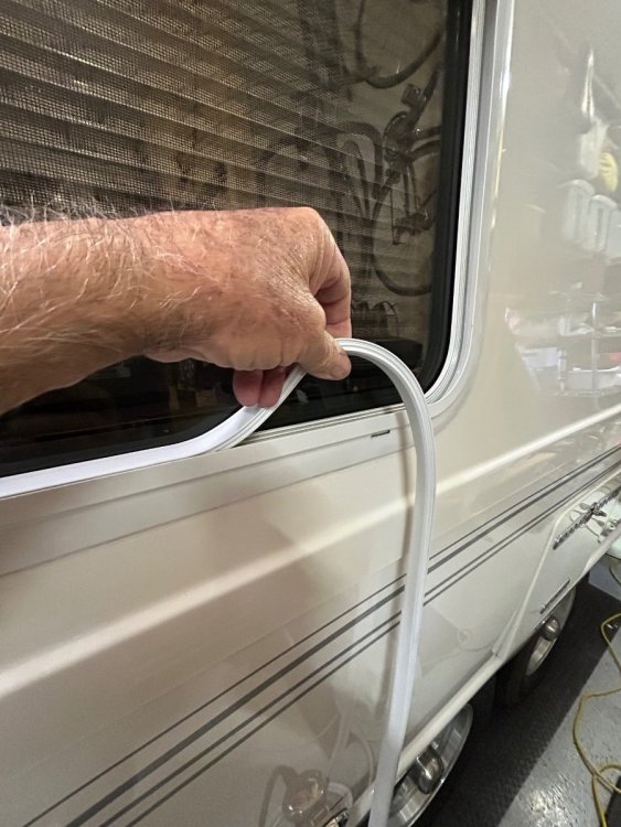

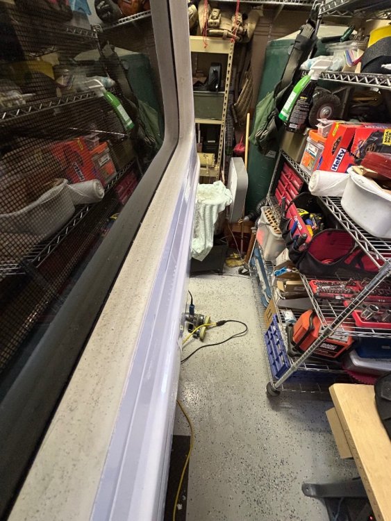

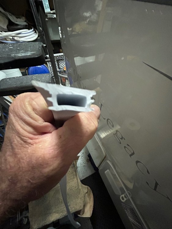

MAX Burner Posted March 21, 2023 Posted March 21, 2023 We had the dark blotches on our window glaze also...(1st pic) Judging by the debris found in the track, it appears the PO never cleaned the glaze or removed them to clean the tracks (we've only owned our Hull #226 for a few weeks, FYI.). After soaking in bleach over night most of the blotches were dissolved, but the glazing still didn't look fresh. In addition, over time, the strips tend to shrink which caused 1/4" - 3/8" gaps on either end (see second pic). Decided to replace the glaze strips with new white ones... Could've gone black, but we'll see - maybe change them in a few years, who knows. There's definitely an "inside" and "outside" of the glaze strip to consider when installing. See pic #3 - the longer edge goes toward window ("inside")while the shorter lip orients to "outside." Pic #4: shows new glazing being installed into the window sill track... The plan is to simply keep the glaze strips on a regular maintenance schedule and keep them from "blotching" as long a possible. R&R of the strips was definitely an opportune time to clean out the debris collected in the tracks! 3 Art, Diane, Magnus & Oscar (double-Aaarrf!) (SOLD) 2022 TUNDRA (SOLD) 2017 LE II; Hull #226 "Casablanca" HAM call-sign: W0ABX
