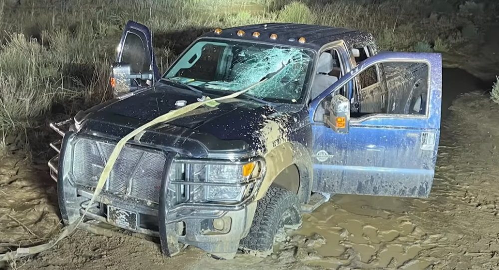

The Good Samaritan apparently had looped their tow strap over their truck’s trailer ball and ran the tow strap to the tow hooks (Apparently below the cow catcher in the mud) of this Super Duty Ford.

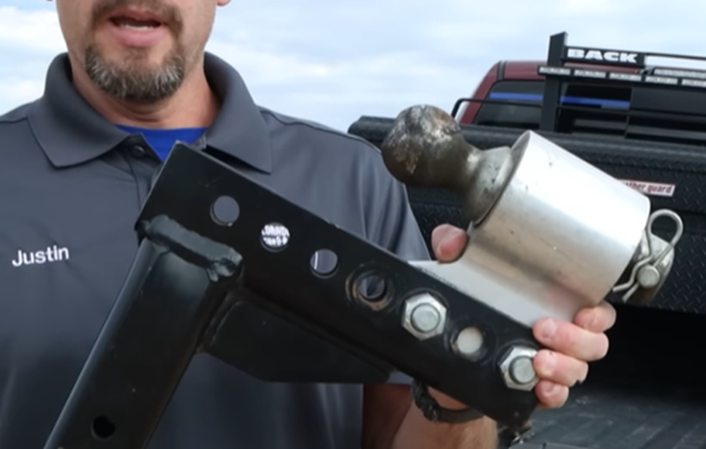

 According to the video, the Good Samaritan’s truck was using an “Anderson Style” drop hitch and 2” receiver such as this one.
 In this case, the hitch failed at the truck receiver.
But, as the video advises, there are several other potential failure points that could have resulted in the fatality.  In this incident, It appears that the entire hitch assembly aft of the truck became a missile that killed Mr. Woods.  It could have been the ball itself, or the shank pin, or the tow strap, or the tow hook(s) on the stuck vehicle.  I think that the central point of the video is that all elements of a vehicle recovery system need to have the necessary ratings for the task involved.

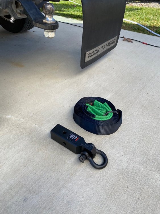

 I was strongly biased to purchasing a K.E. style system due to their effectiveness.  However, after watching the above two video’s, I changed my mind for many reasons. After many hours of research and soul searching, now I am following Frank C.’s lead in preparing for “minor emergency towing situations”.   To that which he posted, I added two soft Shackles to facilitate connection at the stuck vehicle end without creating a heavy missile.  I also went with a 30’ tow strap to allow for more options.  To be clear, this is a static/low energy set-up and will only be used as such.
The Rhino gear I chose is on-sale (Pre Thanksgiving 2022) at the Rhino web site.  The sale cost plus free shipping and a Muddy10 (10%) discount is less costly than Amazon Prime at this time.
I am interested in your comments and thoughts.  Mahalo, GJ
Rhino Kit:  30' Tow Strap, Hitch Receiver, Shackle Kit:
7/16" Synthetic Soft Shackles (2 Pack)
