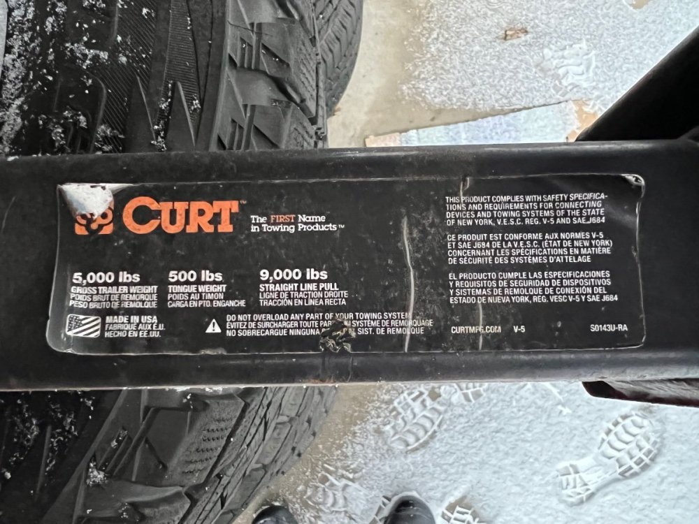

On 11/13/2022 at 10:40 AM, Steve and Deb said:
Curt #31198? That's the only front mount I've found for the LC. Thanks!
The attached photo is the only markings on the hitch.  In order to make it fit, you’ll need to trim a little of the plastic around the front recovery points.  DON'T drive off-road with this particular hitch in place.  It rides too low.  On pavement it’d barely be okay. I forgot it was there when going down a logging road once while bird hunting.  I came over a rise that quickly dropped down into a deep hole on the other side.  The front hitch caught the far edge of the hole and face planted the whole rig.  The guns, gear, and hot coffee from friends in the backseat all ended up in the front seat.  A couple of dollars at the car wash and a high pressure hose wasn’t enough to clean up the muddy mess under the truck.  I had to put it on a lift at work and remove all the front skid plates to clean out all of the impacted mud.  Fortunately nothing was bent or broke.
This past year I came into a small three cylinder diesel tractor with a front end loader.  It’s got a spot for a hitch ball on the edge of the bucket.  I’m going to use the tractor, bucket, and ball to place the trailer in its tight winter resting spot under the back garage car port once I quit ruffed grouse hunting in a few weeks.  With the super short wheelbase, it should make it even easier than the front hitch on the Land Cruiser.
Thanks for the heads up Ken. From the Etrailer photos on the Tundra and Sequoia it looked pretty tucked underneath. I don’t have my trailer yet, and not sure where I’m going to park it at this point, either. So I may not need one anyway.
