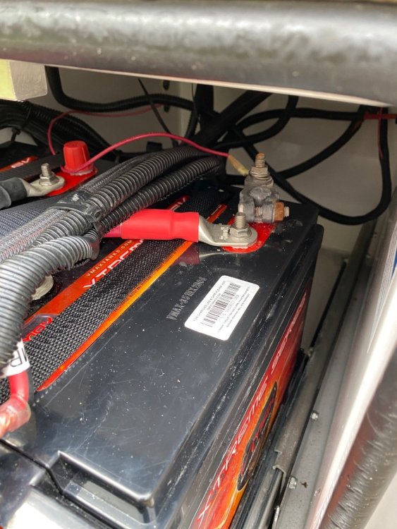

We received our VMAX batteries today.  They are a tight fit in our 2019 LEII battery tray so I will need to use a different tie down strap.  The metal hook for the tray is just a might too wide.  I may go with an alternative looped strap instead or modify the existing strap.  I also will have to order 2 new 4/0 gauge battery cables to allow sufficient bend of the cable because the M8 post and normal post are closer together so it is hard to fit the adapter Oliver used on the post far enough down on the post to insure it will stay pit.  I only have this issue on the positive sides of the parallel connection but it is recommended that the interconnect always be the same gauge and length.  After I finish the install I will attach a picture of the final install.

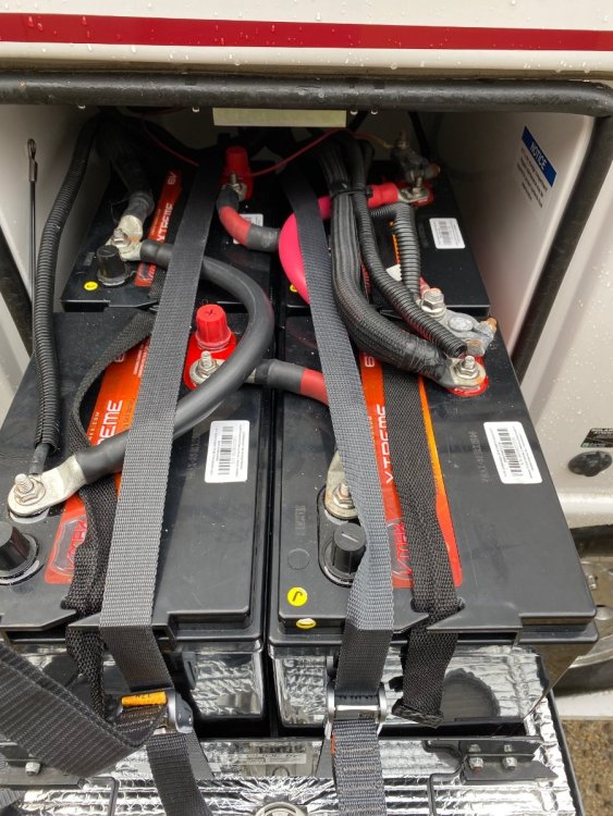

I completed the installation of my new VMAX   AGM batteries.  There are 4 - 6V 237Ah batteries.  Due to the very slightly dimension difference I eliminated the straps that clipped on the battery tray and use two heavy Nite EZ cargo straps that each hold down 2 batteries.   After testing I feel confident we are back to normal when we don’t have shore power overnight during the heating season.  I drew the batteries down almost 70Ah and still had a 93 SOC.  FA81FDD3-F1AE-4FA7-B601-7AE8B9A4E54B.thumb.jpeg.47803124de974372ad350ff89e901075.jpeg647868FF-FADB-41DF-8B13-32AB6E7C5A71.thumb.jpeg.17c805834e3431f6d74a38592be07d17.jpeg

I thought I responded to this query, so I apologize for the delay.  We bought the VMAX XTR-235AH marine batteries and they did fit in our 2019 LEII battery tray but required me to strap the long way on the battery tray as indicated in our posted pictures.  I purchased directly from the VMAX distributor in Michigan and order on Monday or Tuesday and received the batteries on Thursday or Friday of the same week.  I did take the time to insure they were fully charged before installing including letting them sit for 24 hours.  The batteries have only gotten stronger since the install.  I did do a test early on to insure that I wouldn't have a recurrence of the issue running the furnace for several days after a full charge.  They worked well.  I am also going to try to keep the SOC above 80 percent to make sure we get the number of cycles expected.  This important for AGM or VRLA deep cycle batteries.

Nice install!  I may get a couple of your straps for my battery compartment.  Two thoughts:
To keep the batteries in place requires a significant amount of tension.  Hence your heavy duty straps.
When in motion, energy pulses from the suspension system imparts to the frame, and then to the metal plate that supports the battery bay.  Fortunately with EZ Flex and four shocks, these pulses are significantly reduced... but not eliminated.  The result is varying tension of the straps.  Higher pressure when the pulses are up, and lower when they are down.  In essence your cables will be acting like super strong springs between the straps and the AGM's.  That over time, the spring movement (Cables) will impact the crimped connections and possibly effectiveness of the system itself.
In short, I recommend running the straps under the battery cables.  Thus forces of the straps on the batteries will not have nearly as much on the cables and connections.
Secondly, if you do not already have a Master Battery Switch, I would certainly suggest your getting one.  BlueSeas 350 amp is a great one that many of us use.
