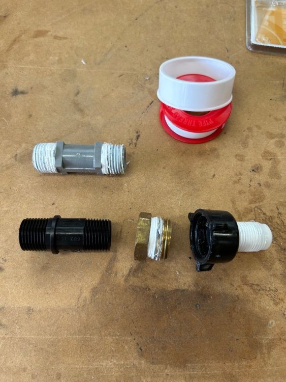

DonnaDuane Posted January 4, 2023 Author Share Posted January 4, 2023 I did learn that the Black Tank Flush line has a check valve that requires one to pump hard to get antifreeze past it. 2018 Elite TV - Audi Q5 3.0 TDI Link to comment Share on other sites More sharing options...

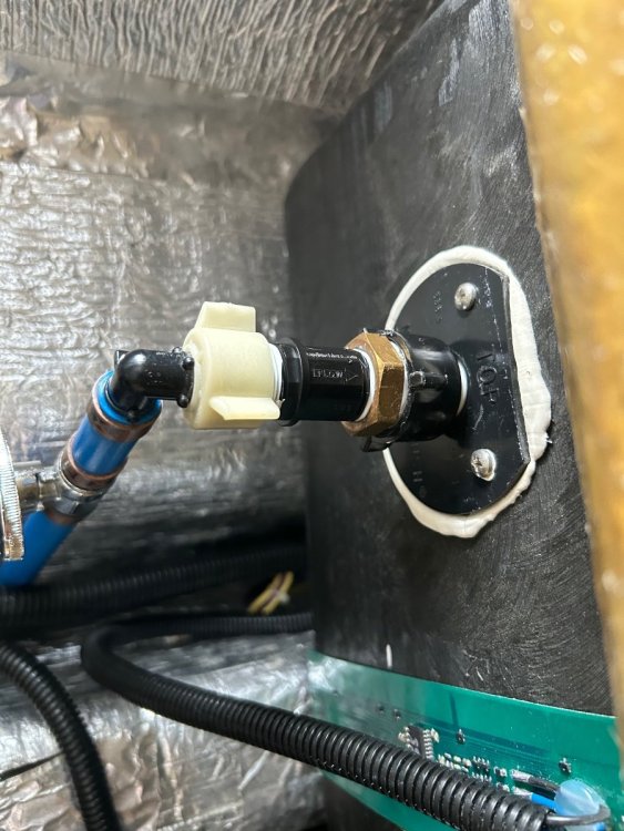

Moderators Mike and Carol Posted January 4, 2023 Moderators Share Posted January 4, 2023 2 hours ago, DonnaDuane said: Got antifreeze to interior faucets and toilet, and a dribble to outside shower, but when I attempted to fill the Black Tank Flush line, it seemed to not go in. Much of the antifreeze squirted out where the hose connects to the Ollie. Thoughts? You might have a bad Black flush backflow valve. I did. I replaced it and now the flush into the black tank works fine. If you hook a hose to your black tank flush does it fill your black tank? This is from under the dinette seat near the bath. The flush line is on the left, the black tank and backflow valves on the right. This is the assembly detached from the black tank with the new valve I got from Amazon. There are two backflow valves on my trailer (2016). The white part on the right is in the tank. The gray part is the valve that failed. Replaced it with the Thetford above. The bad valve is the gray thing. The black piece under it on the left is the new valve. 3 Texas Hill Country | 2016 Elite II #135 | 2020 Ram 2500 6.7L Link to comment Share on other sites More sharing options...

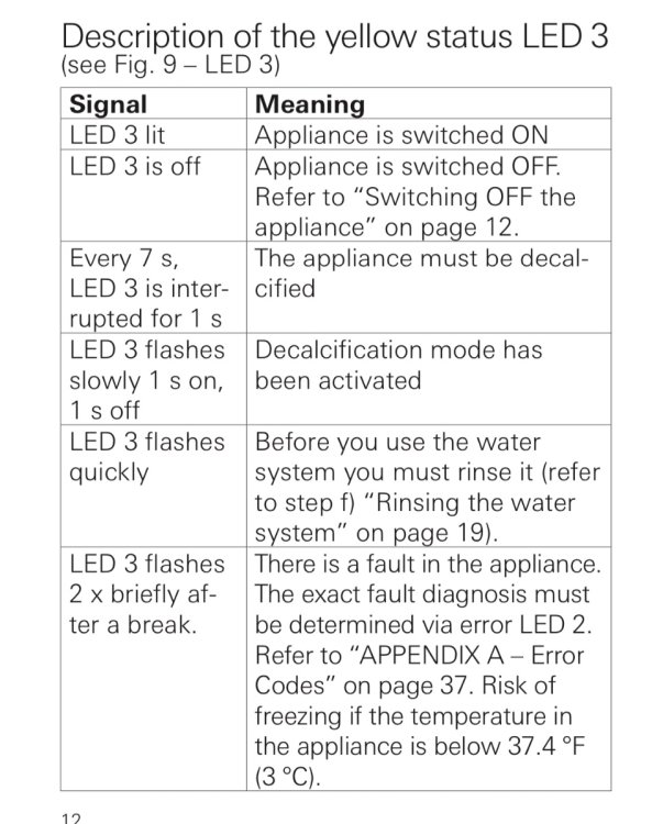

bhncb Posted January 4, 2023 Share Posted January 4, 2023 4 hours ago, DonnaDuane said: It turns out that both shower faucets were closed, so that's not the cause of my lukewarm water. Any other ideas? How long has it been since your Aquago was decalcified? 1 1 Link to comment Share on other sites More sharing options...
Rivernerd Posted January 4, 2023 Share Posted January 4, 2023 2 hours ago, DonnaDuane said: I've never put it in Clean/Decalcify mode. Is it possible it could got there on it's own? Yes. The wall control can get accidentally bumped into clean mode. Once that happens, the Aquago will stay in clean mode until the sequence detailed in my earlier post is followed. The question asked by bhncb above is also relevant. In your shoes, unless you have recently done so, I would get some Truma decalcification tablets, run the clean cycle and see if that solves the problem. 3 Hull #1291 Central Idaho 2022 Elite II Tow Vehicle: 2019 Tundra Double Cab 4x4, 5.7L with tow package Link to comment Share on other sites More sharing options...
Frank C Posted January 4, 2023 Share Posted January 4, 2023 12 hours ago, DonnaDuane said: I've never put it in Clean/Decalcify mode. Is it possible it could got there on it's own? If it was stuck in Clean/De-Calcify mode that would be indicated on the control panel inside the trailer with the LED blinking slowly, even if you turned the knob back to the normal mode, and you’d have to do the procedure that Rivernerd mentioned. If the LED on the interior control panel is illuminated solid when in the Normal or ECO mode and not blinking any error code pattern that means the Truma controller thinks everything is ok so the problem may be elsewhere. Double check all your water valves under the bed to make sure they are all in the correct normal position. Does the lack of hot water issue happen both when hooked to city water and when using the fresh tank & pump? You mentioned that you are winterizing also. Did you bypass the Truma as required when you winterized? This is very important! And since you have an older Ollie it may be overdue for a decalcification. 5 Link to comment Share on other sites More sharing options...
