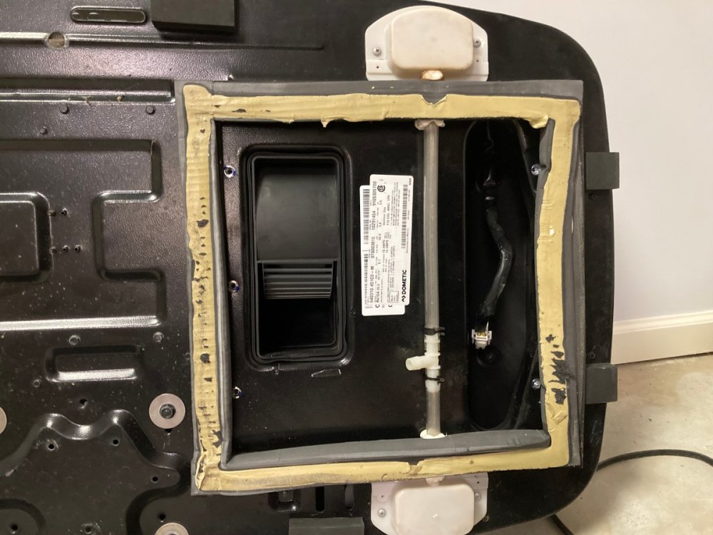

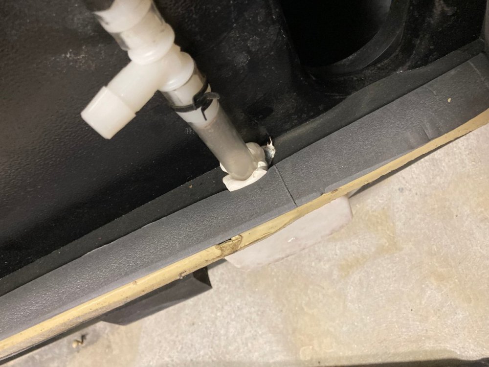

Some pics of my Dometic.......recently uninstalled. Maybe this helps. In the pics you will see there are two layers of foam gasket plus the butyl tape that seals the AC to the roof.  The tube penetrates the foam gasket attached directly to the AC. The penetrations are sealed with not butyl tape but something that feels like expandable foam....not sticky at all.
When my LE2 was new the AC leaked condensate into the trailer. A repairman determined it was leaking at the "T" connection because of a miss applied clamp. It took him <30 minute to repair. Oliver paid for the repair.
Let me know if you need more pics. (this unit is for sale)
Steve

Thanks for the pictures. They are very helpful. It looks like that expandable foam that seals the tube as it goes through the foam gaskets present on your AC, is not on ours. Not sure why. Condensate is definitely backing up from the cup, and following the tube into the trailer. Thanks again for the pictures. We’ll keep investigating.
David

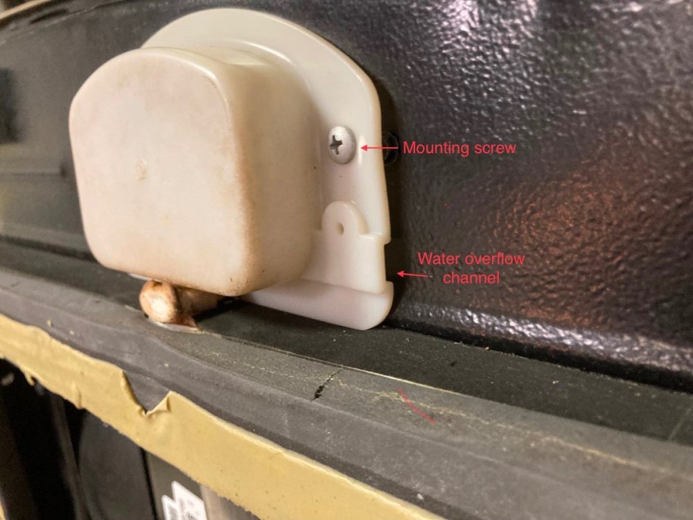

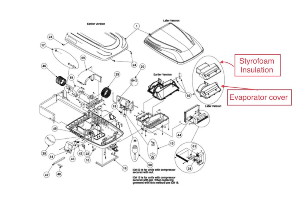

Yes it does need to be raised enough to remove the screws that the cups are attached with.  You can see the screws in Steve’s picture.  I flipped mine over on its back while it was still on the roof.  That made it a little easier to remove the old gasket and sealant.  But before removing or raising the AC, you should remove the plastic evaporator cover under the foam insulation.  That will allow you troubleshoot a little further.  It is attached with press in tabs around the perimeter and a few screws.  I was then able to use a measuring cup to put water into the drain channels to pinpoint the leak.
