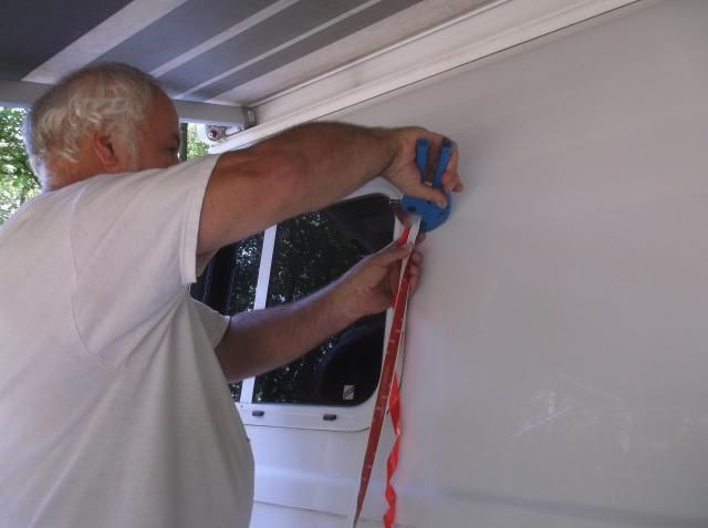

He reported that the material was really easy to work with, after leaving it in the sun for thirty minutes or so. Sticks like crazy with 3m adhesive already applied. I think he did a very professional job. Under my supervision, of course. :D
It's really a one person job, but he let me help. Hand me the alchohol, I need another paper towel, hand me the pvc cutters, please etc... Makes me feel useful. Probably would have been faster if he worked alone. Oh, well.

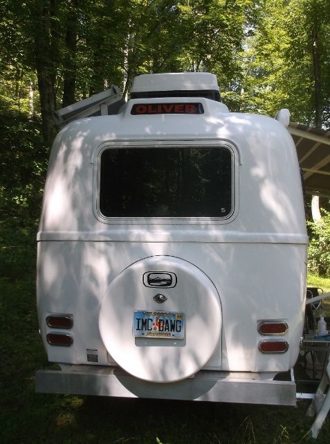

Well, let's see if the resizing worked and this will upload:
this is the rear of our Oliver with the new EZE RV gutter.
Resizing didn't work for me. I resorted back to photobucket free account.
Sherry
Well, that worked, so we'll try a couple more:

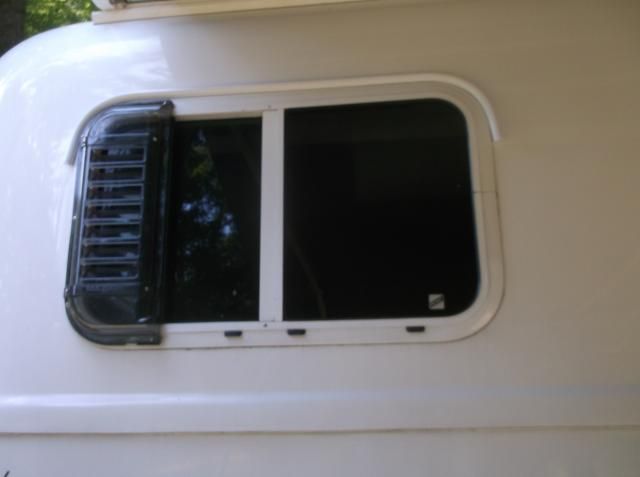

Paul working on curbside window.
Curbside window complete

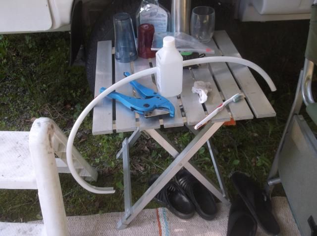

The tools of application.
(minus the beer..., optional, but recommended...)

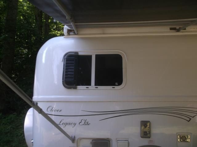

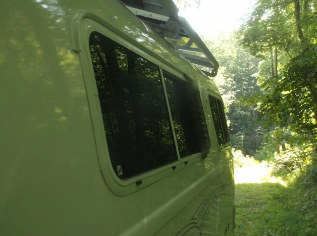

The roadside windows
Nope, not moldy. Just reflecting all the green on a beautiful July afternoon...
Take a break and enjoy the rhodos!

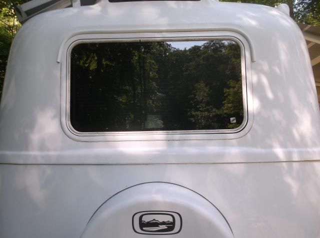

Rear window reflecting the trees. Nice job on the gutter, Paul.
