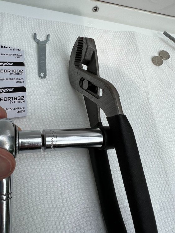

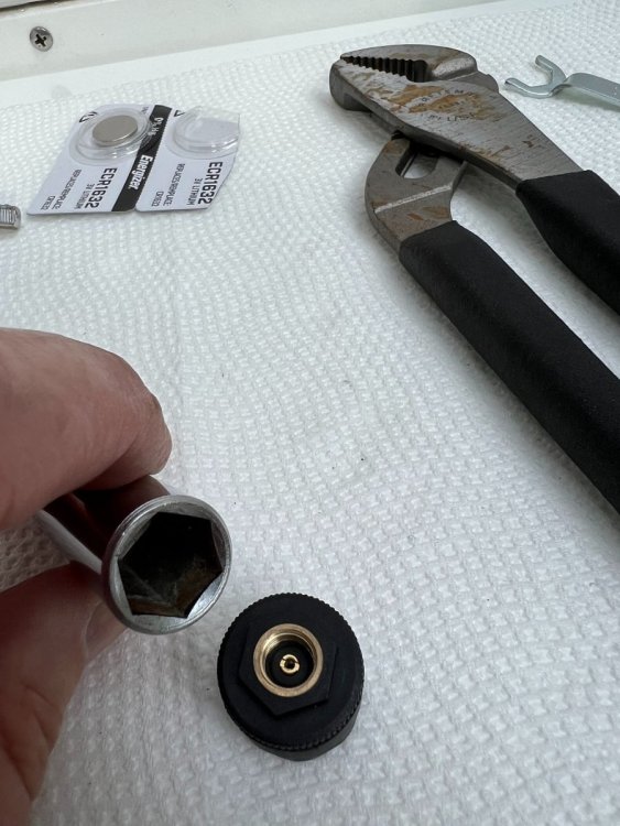

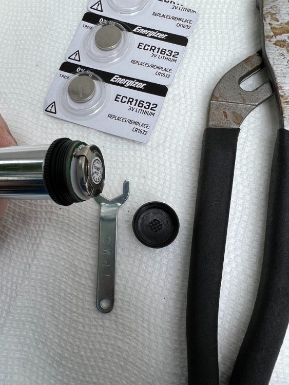

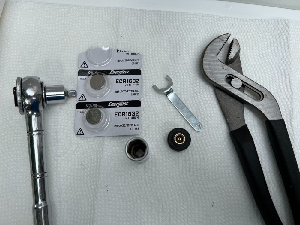

I thought that I'd post this in case anyone else runs into the situation that I did whereby the TPM sensor battery compartment was unable to be removed with the supplied stamped sheet metal wrench.  In my case the battery compartment was so stuck on that the supplied wrench began rounding off the plastic hex nut profile of the sensor, had I gone any further the sensor would have been ruined.  I ended up using a 1/2 inch six-sided socket that provided much more surface area contact than the wrench and the socket did not mar the surface of the plastic nut; even doing that I was unable to grasp the barrel end of the sensor with enough force using my hand to unscrew the barrel from the sensor until I squeezed the barrel between the padded hand grips of my channel-lock pliers ( don't use the jaw end or you'll risk crushing the barrel ).
Curiously ProSmart used to ship a tool that more accurately fit the profile of the sensor but have included only the stamped sheet metal wrench in the current kits which provides significantly less surface area contact leading to the possibility of destroying the plastic nut profile.
