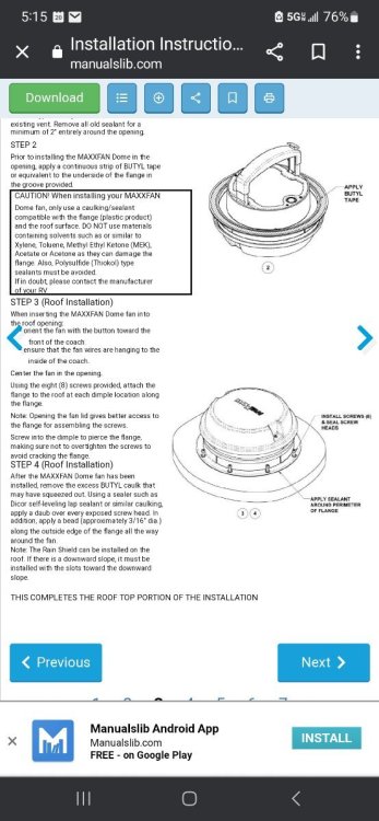

I'm seriously wondering if those who have issues have fans installed, 180 degrees wrong way. Maybe vent/drain holes  are  backwards?

It's right there in the instructions: "Orient the fan with the button toward the front of the coach." OTT installed ours backwards. Probably why it pops open. Another QC fail.
  • Sad 1
On mine, the black button on the handle IS oriented towards the front of the trailer!
