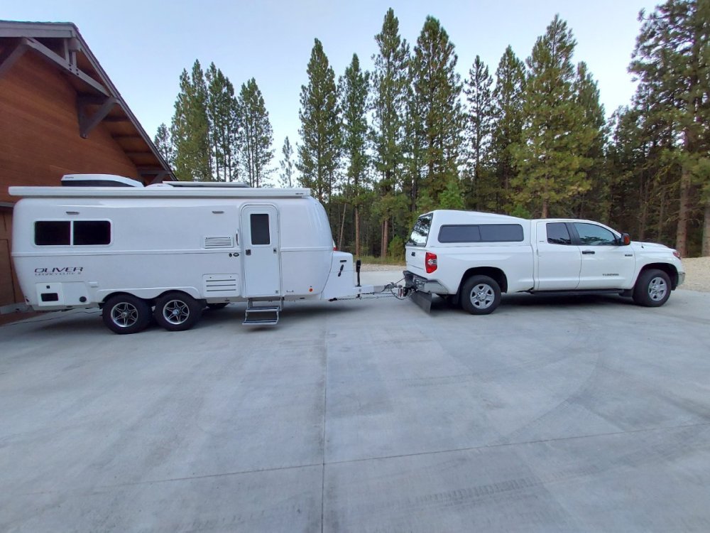

The rear air bags are now installed.  As advised by posters on this forum, the air bags are presently set at about 25 PSI.  Our next 4-day camping adventure, starting tomorrow, will provide a good opportunity to determine if the towing experience feels any different than before airbag installation.  But one difference became quite noticeable when I hooked up the trailer:  the rear of the Tundra sat higher, causing the trailer to sit "nose up" when hitched.
Because I am compulsive about towing with my trailers as level as possible, I switched the Andersen WD hitch mount from the "up" position (where the ball assembly had been bolted in the lowest position) to the "down" position, with the ball assembly bolted into the top position.  Because of the design of the Andersen hitch mount, this resulted in the trailer coupler sitting about 1.5" lower than before.  As  you can see from the photos below, the trailer once again sits close to level when hitched.  The first ("before") photo was taken last April.  The second ("after") photo was taken today.  Note that in the April photo, the rear truck fender well clearance is less than the front fender well clearance.  In the August photo, rear fender well clearance is actually greater than front fender well clearance.  So, the airbags are, indeed, preventing "squat" with the trailer attached.  Notably, our Tundra came from the factory with rear fender well clearance about 1-1/2" higher than front fender well clearance (37"--front; 38-1/2" rear).  I wondered if this was designed to compensate for "squat" when towing a trailer?  With the air bags now installed, the truck fender well clearances, with the trailer attached, are the same as the factory clearances with no trailer: 37" front, 38-1/2" rear.  BeforeAirBags_AndersenHitchUp.thumb.jpg.c875710df7cc8d429a09ad350160fd84.jpgWithAirBags_AndersenHitchDown.thumb.jpg.da1b12fd06b4af627234f5ea330c7b23.jpg
I will report our observations of any difference in trailer handling after we return home this weekend.
Hope this helps someone choosing to install airbags/helper springs on a Tundra.
