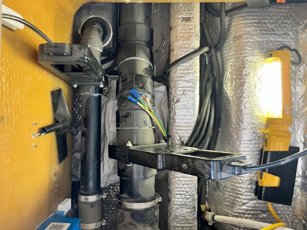

I went into the bowels of the front dinette seat, to have a look at the Black Blade Valve.  Besides being a bit difficult to pull/push from the outside it appears to not seat all the way when pushed in.  I have followed other threads which discuss this topic, so I "Know what I have to end up doing".
However I cannot seem to get my 2XL hands in there to properly access the bottom nuts/bolts no matter how I try to squeeze in there.
Maggie was observing all this as I tried many different angles and she saw my struggles.  I told her what I really needed was a ¼” drive socket set so I could get the proper access for inspection and possible replacement done.  She suspected I just wanted an excuse to buy more tools for SNYSDUP…  I then mentioned to her that her hands were much smaller than mine and could easily fit between the piping.  After a very short discussion, I believe I will now be buying a ¼” drive socket set.

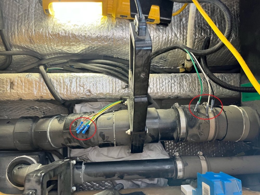

The 2nd picture shows two (red circles) bundle of electrical splice connections that are open.  Am I wrong to assume they are for options we did not choose, but were wired-in if we want any of those options added in in the future.
The question I have is, Can anyone tell me what the 2 groups of wire connectors would be connected to, so I might label them.

We had the same issues with our black tank valve a few years ago. Poured Thetford drain valve lubricant in the black tank, but still continued to have the problems. Lubricated the push/pull cables and did not correct the valve bypass issue, but cable worked easier. Going from memory. Used valve lubricant on the valve during reassembly. Also used 1/4" drive set with long extension, and tape on my finger to hold one nut during reassembly. I cannot speak to the wires.
It was a few years ago, but kept photos of the job. Black tank valve still working without issues.
Believe I had to loosen the hose clamps and slid pipe back a little while removing & installing new valve.

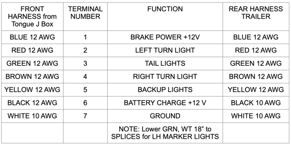

Have you verified that your trailer turn, backup and running lights work when your 7-pin is connected to your tow vehicle?  My first impression when viewing your posted photo is that some of those wires may be designed to be connected to each other, to enable your rear trailer lights to function.
All lights associated with 7pin work as they should. (verified earlier today)
My best guess is that those wires would power/operate the optional Barker electric dump valves.
