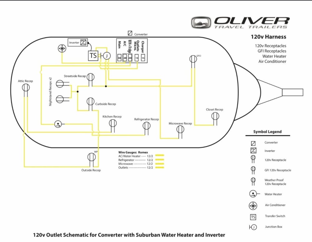

I know you have completed some initial troubleshooting and I would like a clarification on your statement above.  Does it mean that you have used a 120V outlet tester which would test the output of the receptacle or have you removed the outlet cover and tested for voltage at the receptacle/wire connection which would test the input to the receptacle?  If there isn’t any input voltage at the receptacle then as has been mentioned above, the problem is up stream and the junction box near the transfer switch would be the next test point.  Then the transfer switch.  The picture attached is from a 2017 LEII, but should be a fair representation of the components involved.  Please let us know if you have solved your issue or if we can be of further assistance.
