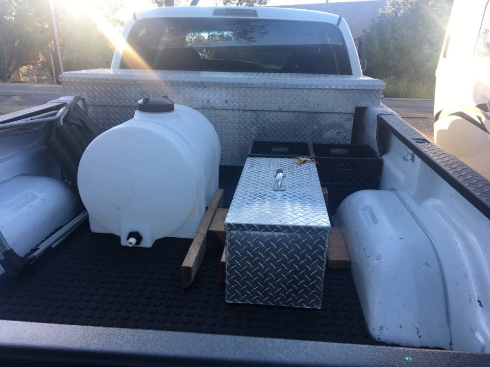

My weights are in the middle. 13,220 lbs. truck and trailer, with fresh tank full and another 35 gal in the truck bed (yes, life out in the SW requires 580 LB in water, try that in an SUV), Truck alone was 7220 LB on 8800 GVWR, and our Oliver weighed right at 6000 lbs. We have room in both. If we were to go on a 4-week trip, I could see adding another 1000 lbs. I like these numbers. We had a class-C RV and were always fighting 14K LB GVWR.
Just got a truck toolbox on Craigs. It's deep and can hold our Coleman grill with its stand, trailer jack, a jack stand, emergency triangles, all my tools and more. These are the kinds of things you may need. Check out my new layout. The small toolbox is for camping/cooking equipment. Toolboxes and water tank will be mounted soon, each is evenly spaced out, so lawn chairs and the like can fit between. Also, there is room for 8 FT lengths of lumber (where you see the scrap wood), for if I have to get supplies.
One thing that may be hard to see in the pic, is the back half of the 8 FT truck bed is still empty! 😊
