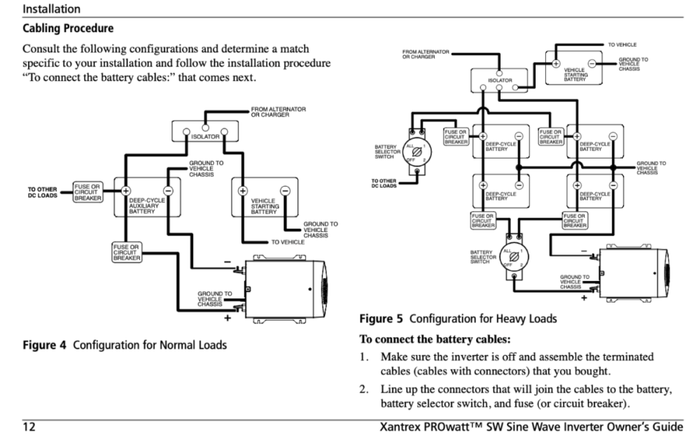

Can you tell me how the PROWatt is connected to the AC outlets and accessories? Perhaps a photo? Thanks.
Our ProWatt is connected to the main DC bus and the Automatic Transfer Switch.  When connected to shore power/GENSET, the ATS distributes incoming AC power to the outlets and AC accessories via the AC distribution panel.  When not connected to shore power/GENSET the ATS distributes the AC power from the ProWatt to the AC distribution panel then to the AC loads.  Like @John E Davies mentioned, the DC connections from the battery bank are recommended by Xantrex to be at least 0/0 for a  run that's 6 feet due to DC line loss and high current loads.  Our's are upgraded to 1/0 gauge wire.  A photo wouldn't show much of the detail.
Here's the Xantrex cabling diagram for standard and heavy AC loads:

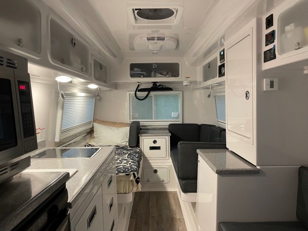

The interior - such as it is at present 🙂
2023 Chevrolet Express 4x4 - 2019 Oliver Legacy Elite II - Hull 529 - Roaming the Western US with Skye (my dog) (and at times my Canadian partner).
Ah, so the AC from the inverter is physically connected to the ATS. Looking at the manual, the AC output of the ProWatt is a built-in GFCI outlet. So is the connection a grounded plug attached to a Romex cable at the inverter end?
10 hours ago, Rivernerd said:
Your photo depicts the inverter wall-mounted remote in your 2022, not the actual inverter
Sorry — I thought they were looking for the control to turn it on?
my Oliver has camped here
He was, til he discovered he didn't have an inverter. Thanks for trying.

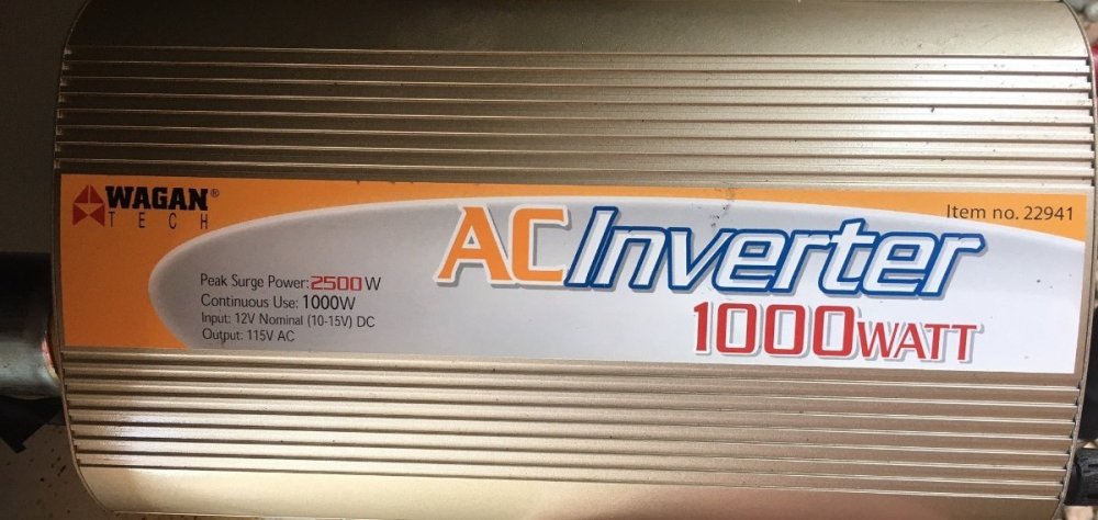

You may or may not want to add an inverter, if you mostly boondock, and have 4 t105 batteries.
In 2010 or so, we added a small inverter (1000 watts), because we only had 2 x 105 ah agm group 31 batteries, primarily to charge our laptop. (Could power some small devices, not much else.)
Replaced the laptop with a tablet (12v charger) , rarely needed anything that wasn't 12v, and wanted the space the inverter used. So, it was gone.
Much depends on your camping style, and your battery power.
If we really need 110, a generator handles the need. We can also use the small genset to charge our agm batteries.
We don't have a microwave, and we tend to enjoy living without a lot of extra 110 power "stuff."
Everyone has a different camping style. It's nice to be able to design your system based on your style.

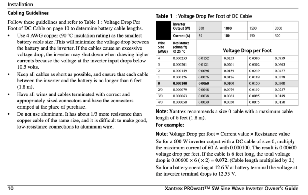

  • For the battery to inverter cable run, you need to use 4/0 AWG.  For the DC to DC cable runs #4 AWG minimum.

  • For the battery to inverter cable run, you need to use 6/0 AWG.  For the DC to DC cable runs #4 AWG minimum.

17 hours ago, Cort said:
6/0 AWG
My typo.  I have edited my quoted post.  The main battery cable to Inverter should be 4/0.  This will allow for reuse for either 2,000 or 3,000 watt inverters.  Also be sure to add a second auto transfer switch dedicated to the A/C.  See John Davies post on this topic for info.  Doing so allows you full capability of a 3,000 watt converter to power up the A/C and most other loads.
On 11/14/2023 at 7:09 PM, SeaDawg said:
we added a small inverter (1000 watts), because we only had 2 x 105 ah agm group 31 batteries, primarily to charge our laptop...
We're glad solar and 2000W inverter was factory installed by OTT in our hull. We likely would not have bought our older used Oliver without it.
Like Seadawg, we had a 1000W inverter before (for us, in a previous RV). We used it for 1-2 years (prior to me installing an integrated 2KW unit). It ran my entire large-screen A/V system and coffee in the morning, an 1100W coffee pot or other small appliance, multiple computer adapters, all while watching the morning news). These are cheap and relatively easy to install, if just wired to 1-2 dedicated 120V outlets. I believe mine had 4GA battery cables only 3-4 FT long.
You could install one under the dinette rear seat, short cable run to the batteries. It would be easy to run an outlet under the table for a coffee pot or toaster. It's right there on the other wall! A second run to the rear attic is not as simple, but for an experienced installer it would take 30 minutes. For us, I would build in a 3KW inverter system and upgrade the A/C too, but this could be done quickly for a few hundred dollars. Nobody likes running generators.
Like SeaDawg wrote, "Much depends on your camping style, and your battery power.🙂
