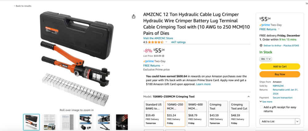

MAX Burner Posted November 29, 2023 Posted November 29, 2023 14 hours ago, Rivernerd said: any additional 4/0 or 6AWG wire needed for the rewire should also be available at any Home Depot retail store), you should be good to go. @Rivernerd's suggestion is spot-on. Renogy products are top-notch, IMO. Making the 4/0 (pronounced, "FOUR-Ought") and 6AWG (American Wire Gauge) cables for your new 12vDC battery bank is not difficult, if you've got the tools for it and your engineer grandson is experienced in such matters. Cable cutters, a crimper tool, terminals, cable material, and proper heat shrink material are available from Amazon (no surprise there). Custom-fit cables are efficient in terms of the space they'll occupy in the tight quarters of the battery box - plus, they make the array appear neat and tidy. Being the Christmas Season, these tools would be nice stocking stuffers (get a big sock) for your engineer grandson if he doesn't already have them! HO, Ho, ho! Cheers! 1 3 Art, Diane, Magnus & Oscar (double-Aaarrf!) (SOLD) 2022 TUNDRA (SOLD) 2017 LE II; Hull #226 "Casablanca" HAM call-sign: W0ABX
