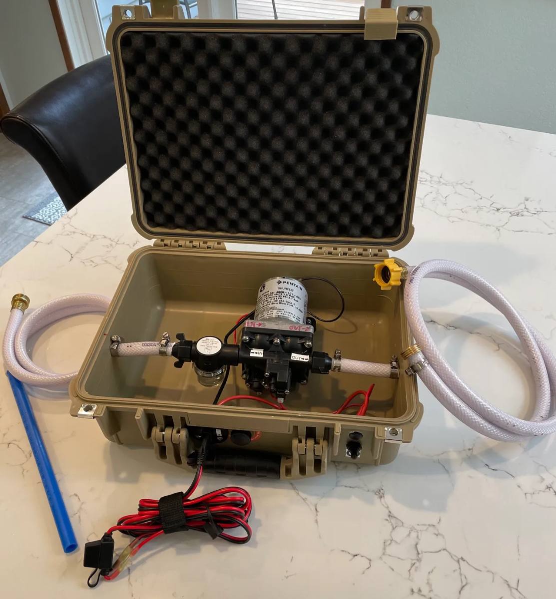

I carry a backup pump and have had to use it to fill through the normal fill port (not the rear suction port.) If you ever want to build a backup pump system...here's our article on that topic. Backup Water Pump Hope some of the comments (like the one above about checking for air leaks have helped. Let us know your outcome.
