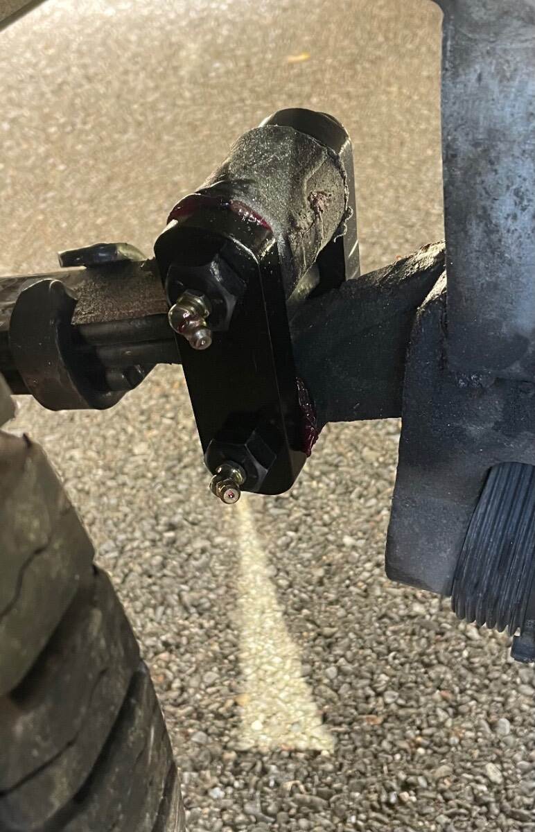

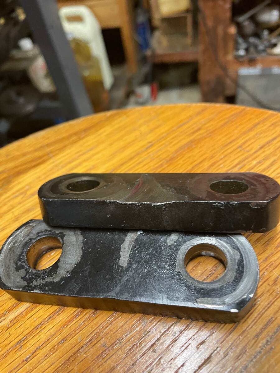

Shackle holes on the Alcan shackles measure .589" to .590". Dexter shackle holes measure .569" to .570". Both Dexter bolts and Alcan bolts spin freely in the Alcan shackles. -

Additional observations. A common thread after installation of the Alcan springs and spring shackles, (with the Alcan non shoulder bolts), is a really rough ride for the first few hundred miles. If you really think about that, it can easily be due to the pinching of the spring ends to the shackles and the shackles to the easy flex arms. Those items MUST break free before the ez flex can do it's job. Those first few bumps must be epic in their effect on the items in the trailer! No matter how well greased those bolts and bushings are, the pinch on the axle ends and ez flex arms has to be overcome before the suspension can even begin do it's job. I do not even want to think about the long term wear effect. -

After I posted the above i went out and dug our the Dexter parts and the Alcan parts. (My axles are not in yet, so I have all parts waiting on Dexter.) I continue to be a believer in the Alcan springs, but now have my doubts about their shackles and shackle bolts. The Dexter bolts are designed to be torqued to their shoulder. That will allow full rotation and flex of the EZ Flex and Spring ends which go to the Shackle. The Alcan bolts put full clamping force on the EZ Flex and the spring end of the shackles. I cannot see how that is a good idea. It resists rotation and flex... Comments please... -

I noticed that the splines on the Alcan bolts do NOT engage the holes of the slightly longer shackles they provide. I asked Alcan about it and they do NOT want the shackles locked to one end of the bolts. The way they accomplish this is to drill the holes in their shackles slightly larger than the holes in the Dexter Shackles. I am still not sure I want to use the Alcan shackles and bolts. In any case do not mix and match Alcan and Dexter shackles and bolts.They are engineered differently and not designed to mix. -
