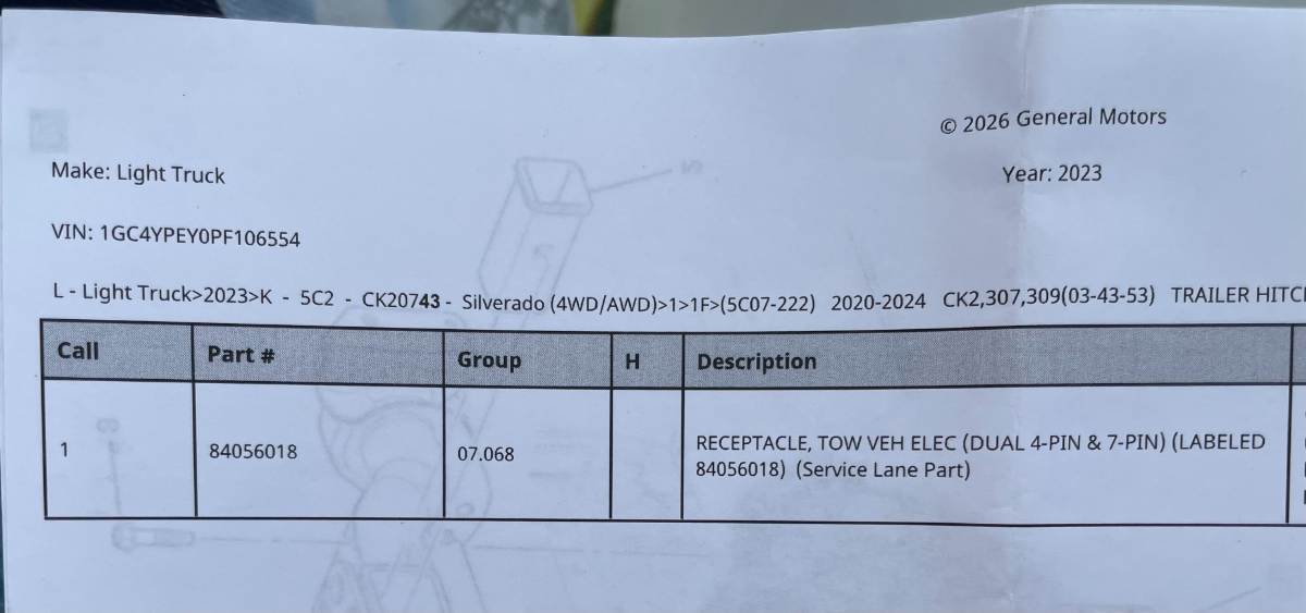

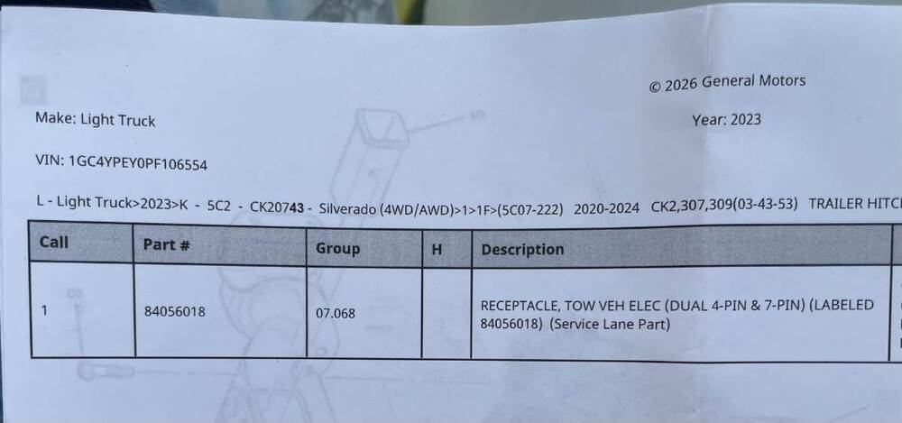

I need to hit the road so don't have a lot of time to respond here, but will try to answer some of your questions. My photo of the junction box was made in a hurry, leaning over the mechanic's shoulder; didn't see exactly what he did to fix it (wishing I had inspected before he buttoned it up). When I open it back up (likely at Lake Catherine SP) I will take more photos. I don't know what that means. Many times, I have checked my lights by jumping in and out of the vehicle. Then I discovered the "Test Lights" function on the TV center console (how convenient!) and all lights function. A few times I have had someone around to just walk behind while I engage breaks, backup, running and signals and all lights seem to work all the time. I haven't seen any malfunction of the lights on TV or TT *** EXCEPT!! Shoot -- Did I fail to mention that when the TT is connected by 7-pin cable, even when the TV is turned off, the trailer lights SOMETIMES flicker? I made a video of that; sorry if I failed to mention it before. It stops when I use the key fob and LOCK the truck. One guy said it's just low power to features (like the lights for seeing the ground at night), other guys said it was something wrong. I described it as looking like a SHORT IN THE WIRING. *** ... so besides that detail, the only malfunction I have experienced (beyond the warning lights on dash) has been intermittent NO BRAKES -- I test this using the Brake Gain Control on the center console at low speed; it also brings up information on the driver dash location that shows +2.5 or +3.0 etc -- when the brakes are not functioning that information show dashed lines in lieu of the moving blue bar on the indicator (brought to us by human factors engineering, right? so we humans can trust that something is happening there, but not actually connected in any mechanical way). I am learning to feel whether the brakes are working or not. Quite a few times, they start out not working and then they kick in. It seems to be related to vibration; a lot of times the warning lights begin after I have come to a full stop (traffic light, railroad crossing) and then I start out again and they start dinging away. I have spare wago connectors (recommended for my tool kit by Mothership) but no butt connectors, on crimping tool. I will order a new 7 pin connector. ** somewhere online Chevy says to "be certain to use the correct 7 pin connector" for this vehicle. When I asked the dealership, they kept telling me they don't sell those. I said, I want the part number of the one installed by factory on my truck so I can find correct matching end; it took them 10 minutes to understand me. I don't know how important that is -- Non-Chevy people (including OTT) say it doesn't matter, but I wonder about the control modules and how persnickety they are ** HOWEVER, since my Oliver operated without a hitch for three years, I figure whatever OTT installed was fine. (haha pun intended) I agree. Nothing worse than a ghost. I plan to do the U-Haul test. Might not even need to leave their parking lot, but I hope to get some sightseeing in while there (if I can manage working around the deluge that is coming). I will also look for an ammeter; it might also be useful to me for radio work. There seem to be quite a few different types, so if you can, recommend some minimum qualities (clamp-on, I see). Will order this. I can ship to my friend (fellow Oliver owner) in Cimarron. Gotta go. Thanks to all for the continuing help.
