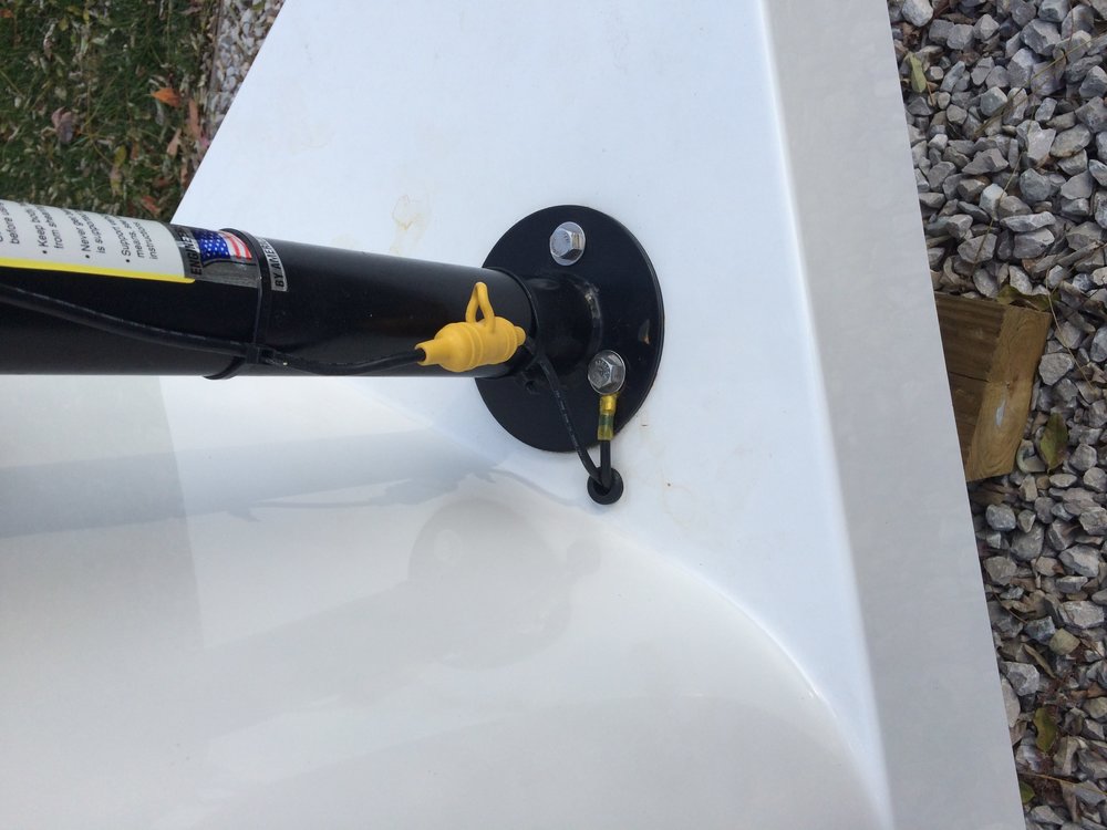

Front Jack Motor Not Working
STEVEnBETTY replied to Commanche's topic in Mechanical & Technical Tips
Here's the pictures of the ground wire I ran for my front jack, the wire is an 8 ga multi strand. [attachment file=IMG_0473.JPG] -
Try running an additional ground wire from the frame to the base of the jack, we had a similar problem, while operating the jack I heard a popping sound ( it sounded like an electrical arc), the jack quit working but the courtesy light still came on, both fuses were good, turn out to be insufficient ground. -

Try running a separate ground to the jack.
