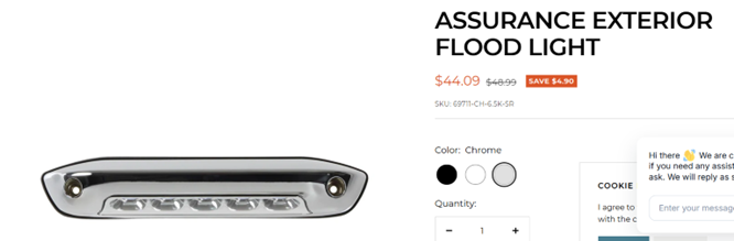

JD: Great post. Seriously like, and am considering at least the front light install. I would prefer not to have unplug when removing the cover. I have a"glam cam" thru the hull for my DC to DC cables, and the under sink portal hatch. Combined they appear to provide an access pathway. For reference, the belly band is well below the sink cabinet top. What do you think about using the light switch circuit of the jack to provide power to the front light location. Tap the load side of the jack light switch, add fuse and run power under the doghouse area to a cable glam, then inside up into the under sink, and thru the hull to mount just above the belly band? Would it worth the extra effort and possible to do? Thanks GJ -
