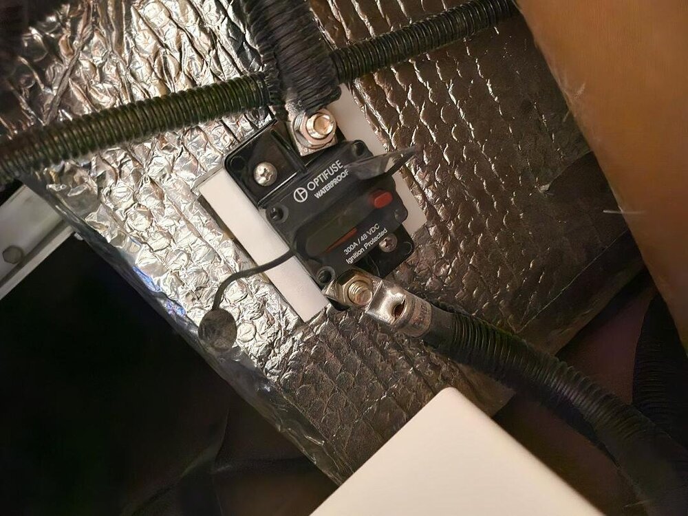

As per Jason ("I would just make sure the inverter is off and the shore power is disconnected. When you connect the wires make sure the breaker itself is tripped. Once all connections are good you can reset and verify it is working properly.") I installed/replaced the Optifuse breaker. After a few test discharge/recharges all appears to be working correctly...finally! I also worked with Xantrex and Lithionics call reps and made some small adjustments to the controls via the apps. Jason also added "We no longer use them (Optfuse breakers) as the system was changed in the '23 models with busbars and an ANL fuse & cutoff." Thanks for all the prior input & thoughts. -

I have been chasing (previous post) some problems charging my batteries. The saga continues. Xantrex now suggests that my DC breaker, which often breaks while charging may be the problem and should be replaced. I have done a fair amount of my own house electrical work so the process of replacing is not a concern. However my knowledge of the Oliver electrical system is less. The question, and request for advice,is other than, turning off the big red solar dial, unplugging the 120 line and manually setting off both breakers what else should I do to be safe and sure no current exists? As an aside, has anyone else replaced the 300v inverter/charger breaker? Thanks (Hopefully this solves the problem,,,)

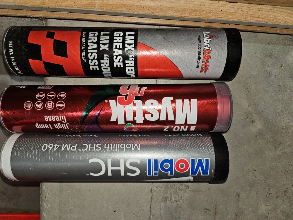

I have purchased three different greases for my Oliver; see attached photo. My uses from left to right are... Far left; under hull zerks Center: top of front jack Far right: gears of all three jacks Is this correct? Also, if necessary can far left be used on the top of the front jack? Your thoughts are appreciated
