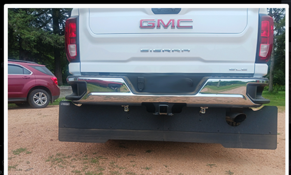

HDRider Posted March 28, 2024 Posted March 28, 2024 I like my Rock Stars from https://www.agricover.com/mud-flaps/ 2 Jeff & Cindy - NE Arkansas - 2023 Legacy Elite II - Twin Bed - Hull #1423 TV - 2015 Silverado 2500 Duramax 4x4
