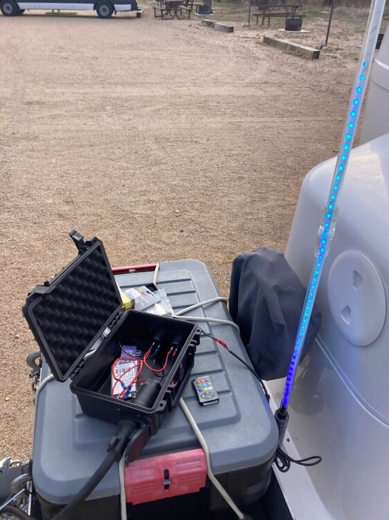

I mounted a led light whip to the front storage basket for “flair” but most importantly for ease of finding my way back to the Ollie in the desert at night. The whip is only 4’ tall but it displays strobing multi-colors so it makes for a nice homing beacon. To power its 12v power needs I built a 12v power source inside a small Harbor Freight “Pelican” case using a female 7 pin plug into which I plug my trailer’s male 7 pin plug (I wired the 12v and ground to a fused 12v female lighter socket and female usb combo).  Works great for powering 12v devices and the led whip from outside and at the front of the Ollie.
A bit off topic, but the spring-mounted LED whip alerted me to a broken leaf spring when it started swaying from side to side. A bonus, unintended consequence of its installation
