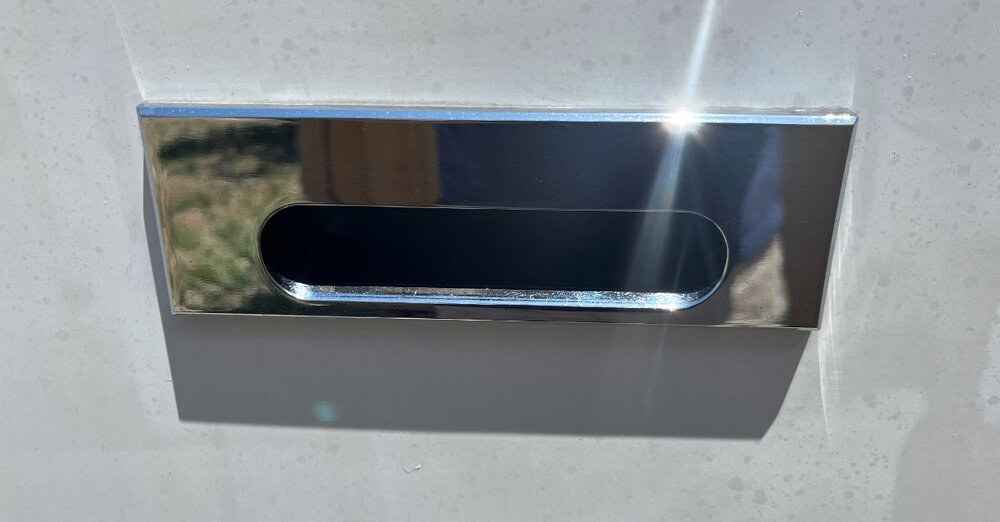

1 hour ago, jd1923 said:
If you're going to replace all of those, you might as well replace the handles on the propane cover too.  It's just chromed pot metal and while it works fine indoors in the Oliver kitchen, it's very susceptible to corrosion outdoors due to getting blasted by winter road brine if towing during fall or winter.
I bought mine from Oliver, but if you type the part number off of the back of the pull into a search engine you'll get a few options for purchase.  They are very easy to replace.  Just unbolt and bolt the new one on.  No sealant or anything.
A photo is attached to show how bad my handles had corroded.

When I used to restore old cars, before working on the paint (which I jobbed out), I would remove EVERY piece of trim. Now it appears I am in the restoration hobby again with an old Oliver! The 2nd pic is the rear of my '59 300E (owned it 1992-2010). All trim, all stainless, all chrome, everything was removed. Then it only cost me $200 (1996 dollars) to get the paint buffed/detailed, on a 10-year-old lacquer repaint. It did cost 1000s more to rework the stainless, chrome the bumpers, purchase NOS lenses, etc. and likely 1000 hours of sweat equity (don't have that energy anymore, half-day labor now vs. a 10-hour day was normal back then).
When I get around to paying $$$$ to get the exterior fiberglass redone professionally, I will remove many trim pieces like this, so they can hit the whole panel with a buffing wheel. Until that day, ours will get duller as I collect parts like these, prioritizing jobs like a new AC unit.
Check out the doghouse handle on your hull a 2018 vs. ours a 2016 life in the southwest! I will remove these handles for the finish work, use a light polishing wax and remount them.

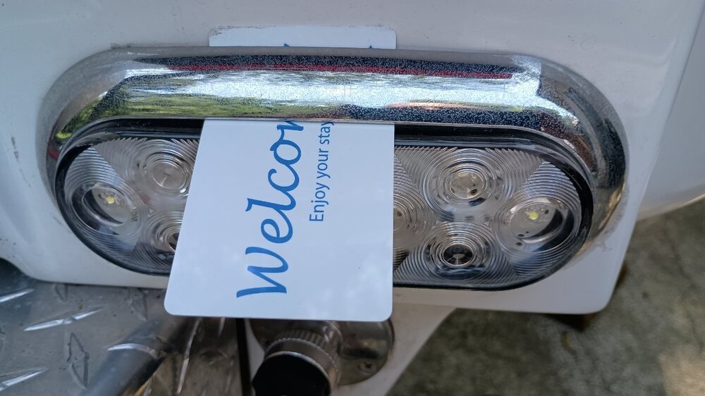

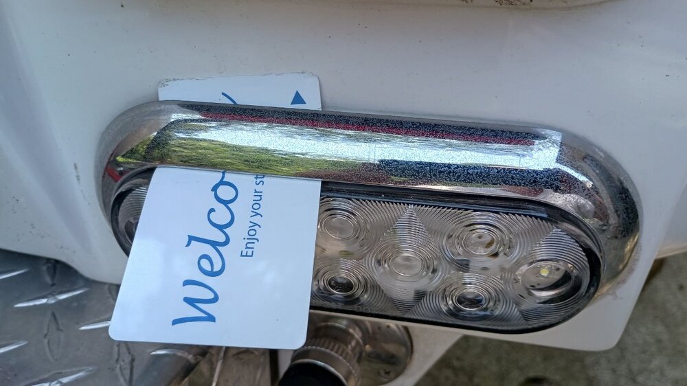

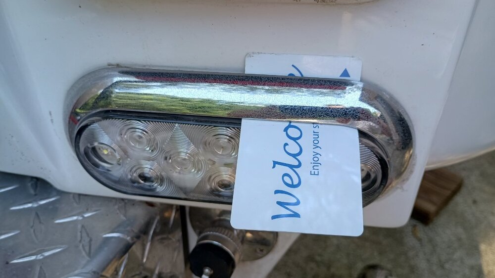

Thought I would post this in case anyone else was reluctant to remove the bezel with metal tools and risk buggering up the light or gelcoat. This involves using an old credit card, or hotel key.
First slide the card between the light and bezel in the center. Next slide the card from side to side to release the clips. Sometimes there’s a click. Now the bezel can be gently pulled off. I didn’t find it necessary to release the clips on both sides but that could be the case at times.
