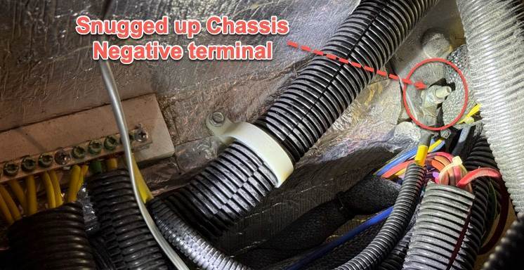

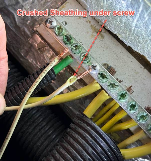

Well, I cannot believe it took me this long to find the issue with my intermittent brakes after Oliver failed to put on new axles for me last year.  Since then I've been dealing with my RAM disabling the brakes periodically.  No rhyme or reason... (known to me).
At least three or four of you folks here would have found this sooner than me, I'm sure of it.  As suggested by some, I verified all ground wires going inside the trailer from the brake bundle on the drivers side (only for snugness). I have even replaced all brake bundle connectors, some I did twice just to be sure (today).
But the good thing is I learned a great deal, and I found a ton of wire connector corrosion along the way. Even the 7-pin connector (now replaced) was not looking good.
But what I DID NOT check was the actual copper wire condition going INTO the negative/ground bus-bar inside the trailer.  Well, after checking, re-checking, re-checking again all brake connectors today, and verified voltage to all brakes, I think I found what someone at Oliver had done.
See, when they initially removed my axles from #110 last year, in hopes that the new axles would fit my frame (that's another thread), they slapped my old axles back on, and hence re-ran the wires back into the trailer (creating the new issue).
Sure I checked for snug negative screws, but I never actually pulled out the wire from the bus-bar.  Look what I found today.
After fixing this "mess", and ensuring the sheathing was not inside the bus bar, my third test drive for the day was a success, but who knows, I've driven four hours in the past, before my truck was bitching about low voltage for the brakes. This had to be the issue, I hope.
I was also able to snug up the main nut to the chassis ground, although I know that was not the primary issue.
Sigh!

On all my trailers I cut the ground wire and bolt it to the frame not far from the hitch. Makes it easy to test and repair when brake and/or lights issues arise.
1 hour ago, Wayfinder said:
the negative bus-bar inside the trailer.
Chris, you may want to do what I did to #113, now that our hulls are 10 years old! And your grounds look more corroded, seeing the color of the copper. I removed each and every one, trimmed the wires back 1/2” and stripped them for clean fresh copper, retighten good!
The intermittent brake disconnect issue drove me crazy for a couple of years.  I had my Ram checked and rechecked, I rewired the 7 pin connector, and had a couple of different technicians go over the trailer.  Finally pulled the brake wires out of the axle and there it was, bare wires from bouncing around inside the axles for 100k miles.  Frustration!
