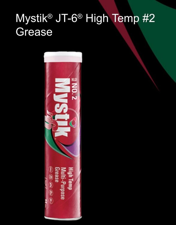

Townesw Posted August 7, 2024 Posted August 7, 2024 I’ve used Mystik JT-6 since the trailer was new. I use it to pack the wheel bearings also. It’s what they were using at the factory when we picked up hull 313 in March 2018. I think you can get it at TSC. Use a good grease and use it often. 3 Bill and Martha 2018 LEII Hull 313 Original owners 3/14/2018 2019 Chevrolet 2500HD Duramax

Geronimo John Posted August 8, 2024 Posted August 8, 2024 14 hours ago, Townesw said: I’ve used Mystik JT-6 since the trailer was new. I use it to pack the wheel bearings also. It’s what they were using at the factory when we picked up hull 313 in March 2018. Like several others, I use CV2 for bearings and Mystic. kfor the suspension. GJ 2 TV: 2019 F-150 SuperCrew Lariat, 3.5L EcoBoost, 10 Speed Trans, Max Tow, FX-4, Rear Locker OLLIE: 2018 OE2 Hull 342, Twin Bed. OLLIE DIY’s: Timken Bearings, BB LiFePO4's, Victron 712 Smart, 350 Amp Master Switch, Houghton 3400, Victron Orion DC - DC, 3000-Watt Renogy Inverter, P.D. 60-amp Converter, Frig Dual Exhaust Fans, Kitchen Drawer Straps. Front Wardrobe Shelves, Snuggle Shelf. TV DIY’s: 2 5/16" Anderson System, Nitto recon’s, Firestone Rear Air Bags, Bilstein 5100’s, Mud Flaps & Weather Tech all, installed Ham Radio (WH6JPR).
