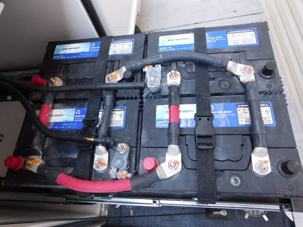

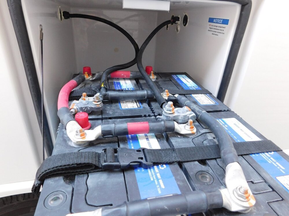

Looks like you have four 82AH 12V lead-acid batteries wired in parallel for 368 AH total. You could be making a pot of coffee say two mornings if the third morning you would be back to shore power to recharge. However, it appears you have no battery monitor so no way to tell where you stand on state-of-charge (SOC).
Taking a close look at your pictures, it's very odd that a 2022 model with no solar or inverter would have multiple extra holes drilled into the battery bay. Also, it looks like you have 4/0 cables between the batteries yet a smaller gauge leaving the bay. These would likely have to be upgraded to operate an inverter, though not sure without truly knowing the AWG.

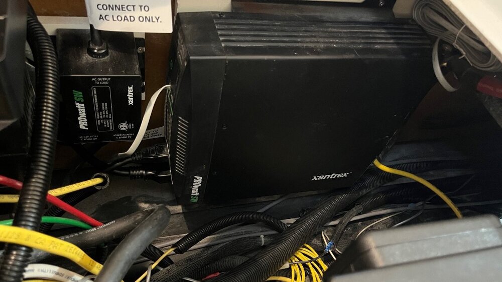

OTT mounted our 2KW Xantrex inverter under the rear dinette seat and when I replaced it, with the much larger 3KVA Victron MP2 it had to go under the rear streetside bed (see pic of OTT OEM install). BTW, this working 2KW setup is for sale cheap if interested. Our OEM installation also came with 340AH rooftop solar and we could run many appliances, including the microwave, except on truly overcast days (then LP for coffee).

I agree on the multiple extra holes drilled into the battery bay is strange, maybe the original owners backed out of solor when ordered, to bad for me!

How OTT wired the 2KW Xantrex (pictured above) was as follows. 4/0 battery cables (2/0 is actually enough) go to the inverter first and then they used 6 AWG cables to power secondary 12VDC needs. The automatic transfer switch (ATS), is shown center of picture. Notice the label "connect to AC load only" which was wired to the one 120VAC breaker that handles the microwave and 110V outlets (make coffee, watch TV, etc.). The ATS allows this circuit(s) to be run on shore power OR inverter. The wiring is relatively simple.
Besides an inverter with ATS, perhaps longer/heavier cables, I would suggest getting a shunt-battery monitor, so you would know when the inverter had used enough power to require recharging (50% SOC for lead acid). We have the tank level monitor too, but I never use it. I added one of these for reading amps and AH used, besides SOC. The VictronConnect app makes it so you can read this data via Bluetooth. It's good to know when parking/leaving your Oliver whether you forgot/left something on that would drain SOC, check the -Amps reading which should be very low. Hope this helps!

The filled in holes were done at the factory where they removed the inverter/charger. You’ll probably find an empty used mount board where they yanked out the unit.
I wouldn’t waste my time with those batteries. The reserve capacity is so low the inverter will quickly deplete them. Buy one or two new lithium units, run new wiring, and install an inverter/charger.

OTT should realize regardless of customer choices in solar/inverter/battery options, only two holes into the battery bay for +/- battery cables are necessary.
