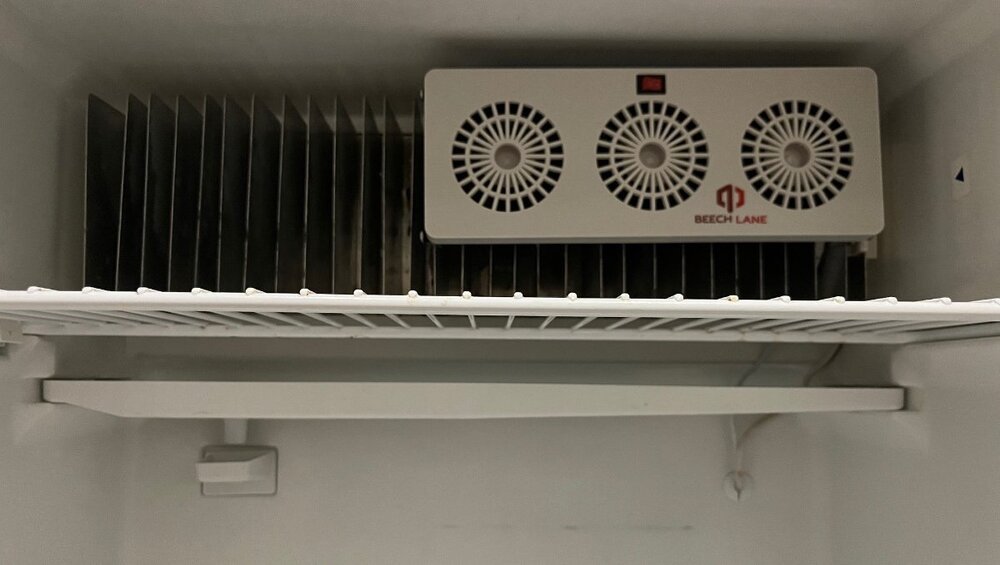

The inside fan for air circulation really helped in spreading the cold and maintaining a more consistent temperature.

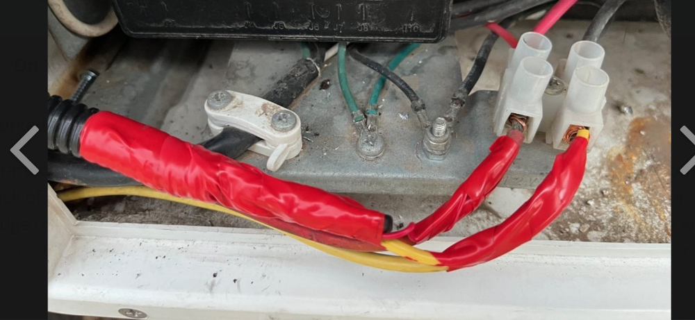

The interior fin fan wire was routed through an existing port in my Norcold, as seen in the above pic. The wire was then connected to a constant power source behind the fridge. You may recall that I tapped into the Oliver’s 12V DC to create two sets of lead lines, one for the interior fin fan another for the exterior exhaust fans (first pic). In your installation of the exterior fans the existing small block was used to provide power (second pic). Simply connect the interior fin fan leads to that block, as well.

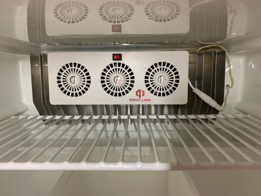

Got ours installed yesterday and with Ron's advice, I now have the same two Beech Lane exterior and interior fans. I had some trouble fishing the wire down. I fed a length of coaxial cable as a fish tape, and it kept getting coiled up and caught halfway. Eventually, I used a mirror and hook to pull it down, and still only about 30 minutes total.
I'm not sure of our make/model. It's a 3-way fridge with 5 vs. 10 cold settings and the fin length appears twice as wide vs. the picture Ron shared. Notice the fan on the coils, drip tray below and grommet below that. I used a leather punch tool, to punch a second hole in the grommet just fitting the second wire.
Turned it on at 7 PM last night, put a tray of ice cubes to freeze and 6 bottles of water inside. Started it in DC mode and it consistently pulled 15A, close to 17A total with the Victron MP2 running and other peristatic draw. 17A over 15 hours = 255AH. SOC was 99% so I figured I should see 56% SOC now with 600AH batteries and that was very close to the SOC reading at 10 AM today on the Victron SmartShunt.
I taped two Ruuvi Sensors in place. One to the interior freezer door and another in the top furthest corner of the fridge door. This morning the freezer was at 10F and the fridge 46F. Turned to interior fan on and off and have not yet noted a difference. It's hard to tell as these temp numbers change slowly. The exterior fan set at 90F has been running regularly at low speed.
The fridge sensor was installed on the outer door in the warmest corner of the fridge. I'm going to move it today, tape it under the upper fridge shelf to get a better average internal reading. A proper fridge should get down to 38F or lower, though we do not store dairy products or anything perishable for more than 2-3 days. The temp should improve with the new sensor location and 3/4 filled with food. Chris is filling the fridge with foods today. We're leaving tomorrow morning, starting our road trip to Texas. We'll see some of you there!

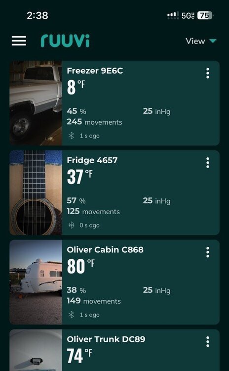

Wow, those temps are almost too good. You should probably run it a lower setting. Ours is set on 4 out of 5. Update on our fridge, now half full of food. I moved the Ruuvi sensor from the far corner of the door to under the drip tray. Read the labels in the picture. I had these in my garage and guitar cabinet, hence the pics. It's been a semi-cloudy day and rooftop solar is keeping up with the fridge on DC mode. Warmer in the cabin than the trunk, cause the windows are closed and no A/C on. Very happy with these temps now.
