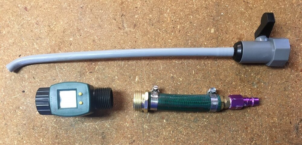

I rinse the Oliver Suburban HWH 2-3 times a year. In a way it's good the calcium ends up here vs. in the plumbing. Get one of these wands to rinse thoroughly. The soft plastic wand can't hurt anything. Push it all the way in and out, turning it 360 degrees to get everywhere you can.

I made another tool for rinsing the HWH. The anode, with all its weight, is not easy to level and thread properly. I recently replaced the anode with a new one. I sawed the anode off the old one to create a simple drain bolt. This is handy for when you just want to fill the HWH, heat the water, and drain again.
