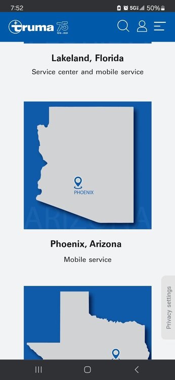

, there is no Truma and no OTT dealers in the state of Arizona. Two strong reasons.
There is truma mobile  service based in Phoenix.

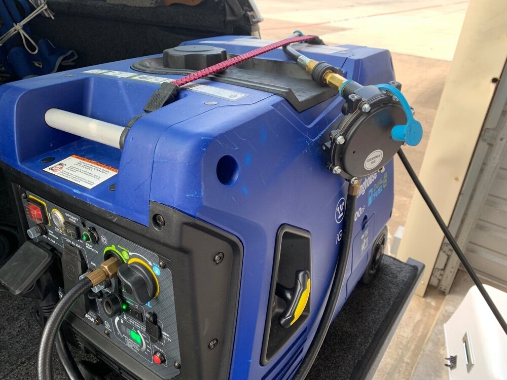

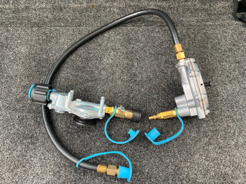

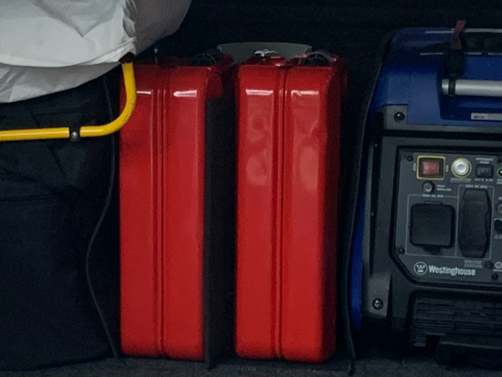

I have two dual fuel generators and generally only run them on propane. The exception would be during hurricane evacuations when our Oliver becomes an escape pod; it is more cost effective to run the Westinghouse 4500W on gasoline for continuous 24-hour durations for several days. Run time is 16 hours on a tank of gas with a/c on. I always carry two WAVIAN (NATO-style) jerrycans, one with ethanol gasoline for the TV and other with non-ethanol for the generator(s), as needed. I have made use of these fuel reserves on several occasions when the TV’s low fuel indicator light comes on; yep, that happens, drives my wife nuts! My SOP is to routinely rotate said fuels rather than stabilize with an additive. Regarding the jerrycans, I have never smelled any fumes, even when enclosed under cap in my former TV and currently inside our Savana van. To your point however, gasoline or any residue in a generator fuel system will reek, so another practice is to run the carb dry, drain the tank and throughly air it out, as necessary. Fuel transfer, especially into a vehicle, can be cumbersome and messy, but I resolved both issues with a portable rechargeable pump. Simply set the gas can on the ground, deploy the pump/hose, flip the switch, easy-peasy! Better yet, once done I let it air out before stowing away in a small Pelican Case to conceal any residual odor.
I have my generators set up to either run directly from a dedicated propane tank or utilizing the Oliver’s QC ports. By dedicated, I mean either a spare propane tank carried in the TV or one of the trailer-mounted tanks, in which case the regulator hose would be disconnected. In this instance, remote regulators (primary and secondary) would be utilized. However, if connected to one of the Oliver LP ports, only the secondary regulator comes into play. I modified one of the generator supplied regulators with QC fittings between the two sections, thus enabling multiple usages.
Use of secondary regulator only when running from the Oliver QC port.
Use of both primary and secondary regulators when running from a dedicated propane tank.
I installed GasStop automatic shut-off safety devices on all tanks, great for gauging, as well as priming! Note the propane hose draped over the tank housing at bottom pic.

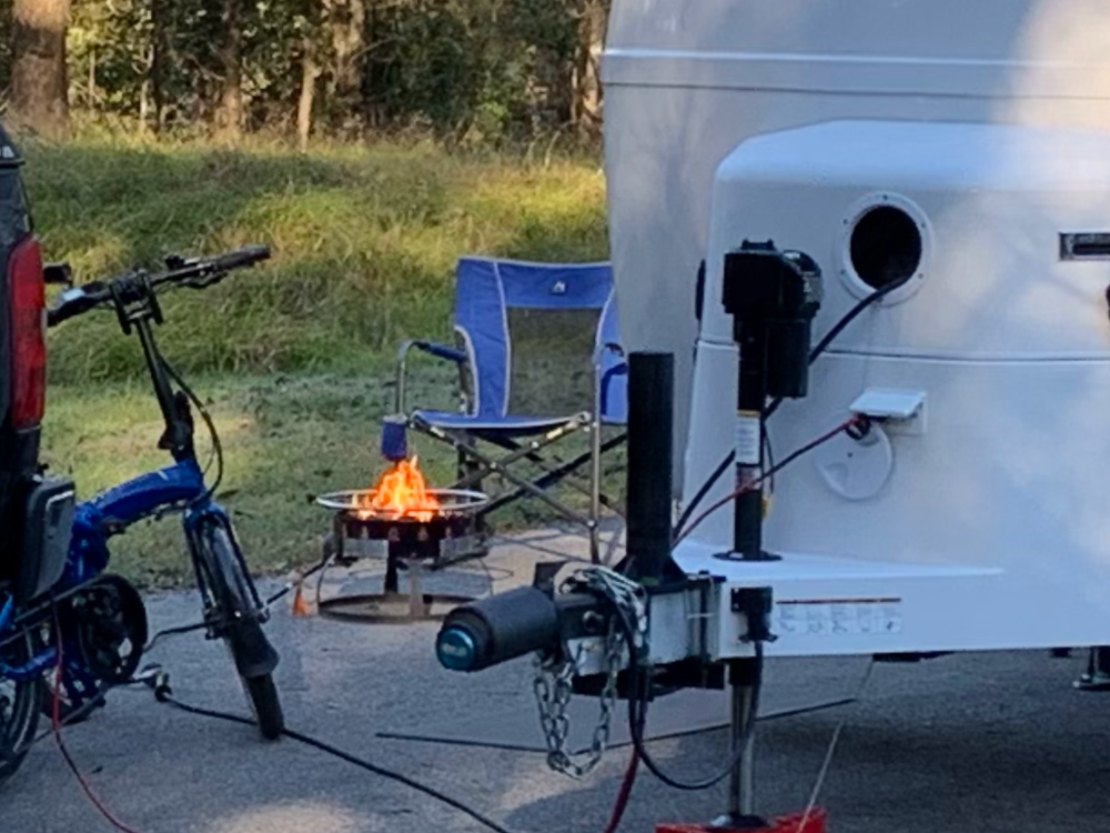

Aforementioned propane hose is tapped into the forward QC port for better access. I didn’t like having to get down on my knees to hookup. This is a 10’ hose extension.
Extension hose stowed on top of tank and can be deployed via the screw port for added convenience.
This hose also serves use of my fire pit.
