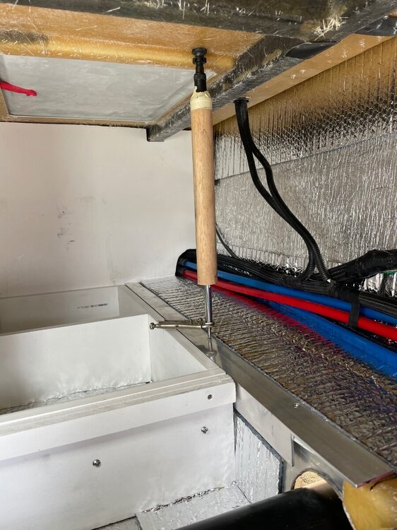

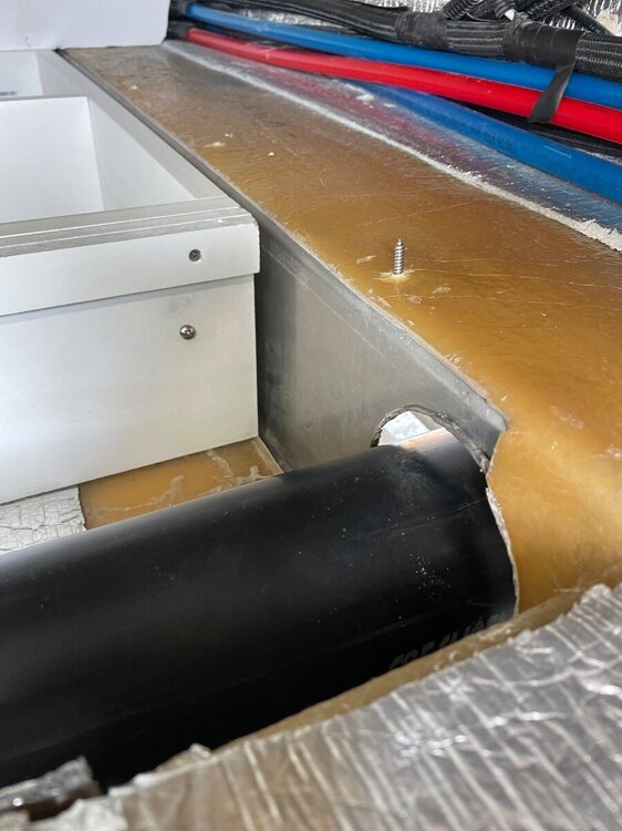

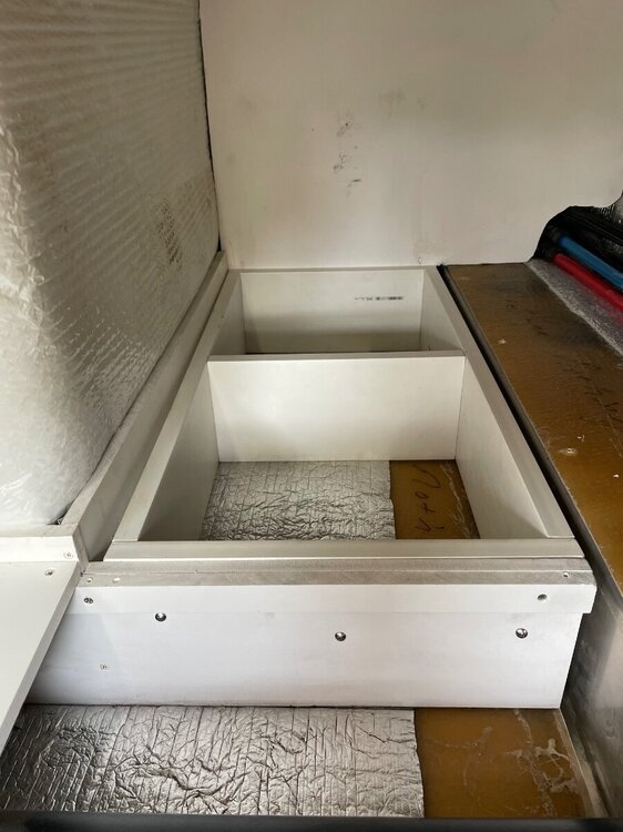

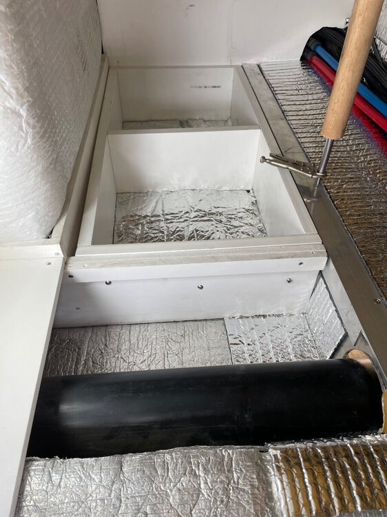

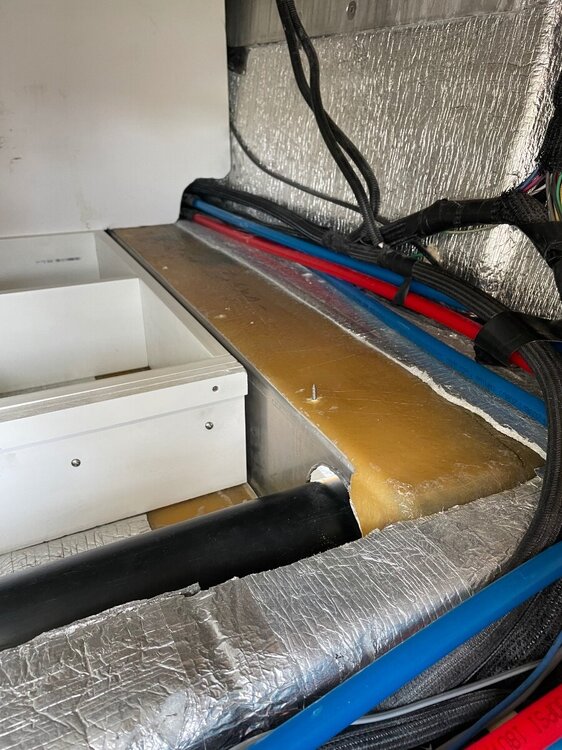

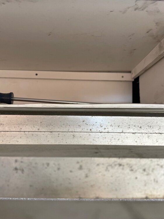

I’ve had a similar issue since the camper was new. A couple of years ago I removed the aluminum Z shaped panel that closes off the rear of the trailer. This panel is located deep inside the rear bumper and the sewer drain passes through it. Mine was not sealed at all and the rubber seal around the sewer line was loose. To do a thorough job of sealing the panel you’ll need to go into the basement area as well. In doing this I also found a large area in the basement area with no insulation, especially the aluminum panel had no insulation. I used butyl tape caulk all around the aluminum panel and a long piece of angle aluminum to stabilize the raw fiberglass edge around the upper edge and stainless screws/self locking nuts through the fiberglass and the panel. The wooden dowel/screwdriver/vise grip pliers was used to hold the screws in place while I tightened the nylock nut from the outside. I also added insulation everywhere I could. Just a suggestion.IMG_1199.thumb.jpeg.bdaa1f4558303714e1622ead5a2d7b2b.jpegIMG_1192.thumb.jpeg.cdfd9cf3208623c105f122517e09c8ed.jpegIMG_1190.thumb.jpeg.4a5f9ae09a44e321af04d2029a6fe704.jpegIMG_1187.thumb.jpeg.d4c787f046e601de33bc19c3505a21c2.jpegIMG_1186.thumb.jpeg.5555c92ee27f126bc996abbffe3890a1.jpeg
DEFINITELY worth looking into MountainOliver!

I forgot to mention the reasons that prompted my basement exploration. The floor had collapsed and upon inspection I found that the floor supports were only held in place by a few screws that only were about 1/4 inch into the side supports. I was also getting propane exhaust fumes into the trailer when the water heater was running. Anyway, in checking out the collapsed floor and the carbon monoxide issue I discovered the air leaks and lack of insulation.
Hopefully something Oliver beefed up on later hulls!
