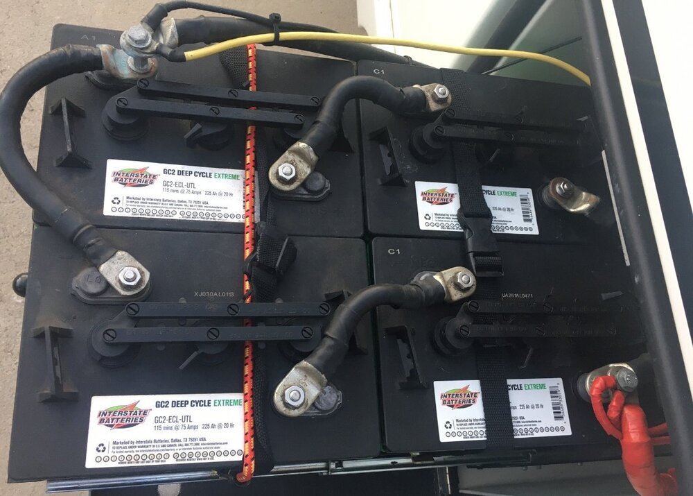

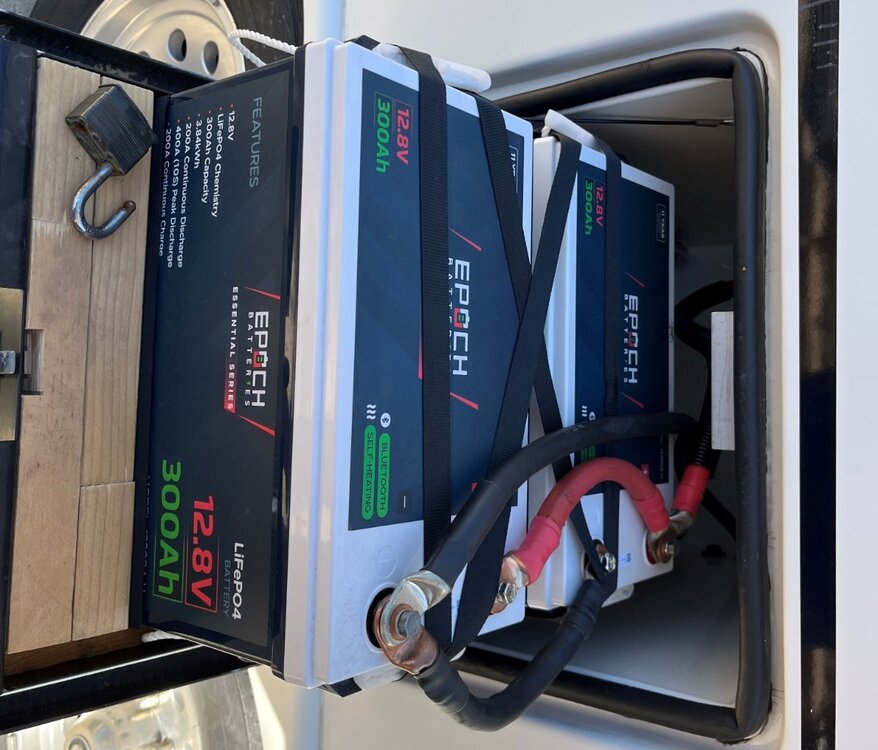

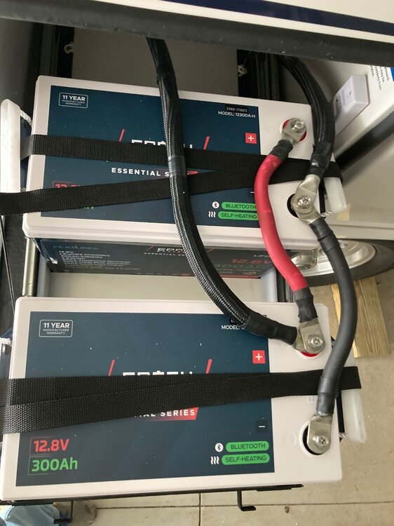

Two 300AH Epoch Essentials fit nicely fit (see pic). Only one 460AH will fit so upgrade possibilities are limited. Unless you're ever considering an inverter upgrade to run A/C for a few hours on inverter, you are correct in thinking 460AH is all you need and double the usable AH in what you have presently in lead acid batteries.
All you need to do is:
1) Install the new batteries in the battery bay. A cut-off switch is preferred by some who park their Oliver in covered storage. I prefer to not add extra connections. I go without and merely remove the negative battery cable when necessary.
2) You need to reconfigure (software setup) both your Xantrex and Zamp SC for LiFePO4 batteries. This is usually simple yet tedious. There are others here who have done so. I have not owned either product but worked the same for our Victron and Blue Sky chargers.
3) I was not aware that the "460aH V2 battery comes with a nice wired remote state-of-charge display monitor." My Epoch Essentials 300AH batteries did not. I can see battery State-of-Charge (SOC) % and +/- Amp usage in both my Victron and Epoch Bluetooth Apps. I use no displays, so nothing is installed into the walls of our inner hull.
Hope this helps! Best wishes, JD

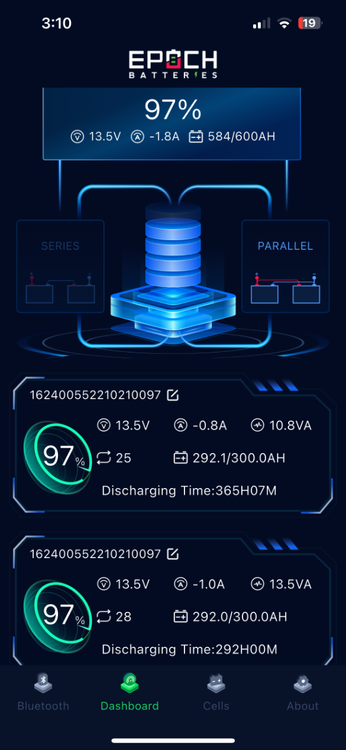

As I mentioned, I prefer not to add displays where unnecessary. This is the readout on my Epoch app today. The app is free to download.
I’m presently using 1.8A as she sits. It’s snowing this afternoon, and I rarely plug into shore power, so no sun no charging. Our Victron inverter/charger takes 1A on standby which I leave on 24x7. We also keep outside Courtesy Lights on (0.3A) and parasitic draw another 0.5A. This app is all you really need and perhaps Xantrex and/or Zamp apps. Love the apps! You cannot read a mounted display while towing or sitting at home.

Thanks @jd1923 for the info and sharing your upgrade.  Two 300aH do fit nicely in the slide out tray.  I'm having a difficult time deciding between the single 460aH vs two 300aH.  Here is a picture of the new remote monitor that only comes with the 460aH.  The physical on/off button is also only on the 460aH and seems great as I could just conveniently turn it off comletely during storage under cover.  I agree that the Epoc app seems to be everything I would need for monitoring but I thought maybe I would locate this remote SOC meter inside the pantry or in an upper cabinet with some kind of surface mount to avoid drilling any holes in the fiberglass.
You mention the consideration of upgrading my inverter down the road, allowing it to run the A/C.  I have the Dometic Penguin II 11,000 BTU  with soft-start installed.  Do you know what the estimated run time difference would be between having 460aH vs 600aH?
Also, were you able to use existing battery cables with your set-up?  I don't have the tools to make those big connectors.

Not much of a free monitor, nice promo, the app shows much more info.

You should have all the 4/0 battery cables you need. Attach a picture if you want me to verify. I needed slightly longer bolts than what Epoch included where the cables were doubled up. Simple HW store item. Finished cables can also be purchased on Amazon and companies like Powerwerx and others.

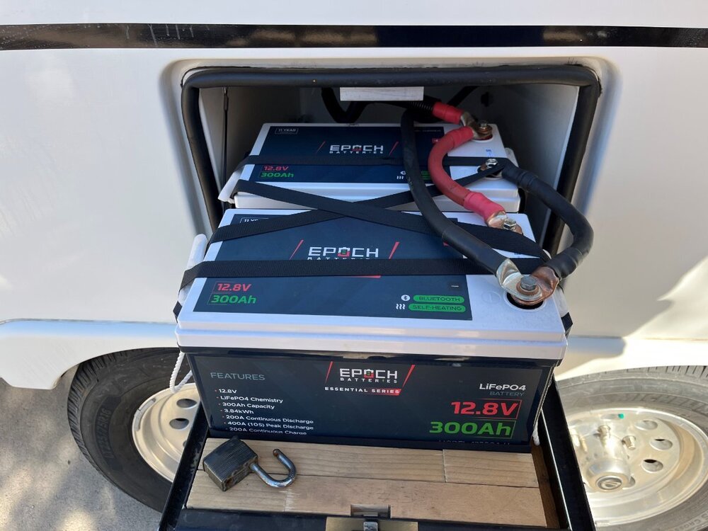

Like @jd1923 I went with the 2 - 300AH Epoch, I did need new cables for the parallel connections. My cables from my old lead acid batteries were too short. Like you I did not have the tools to crimp the big lugs and didn’t want to purchase for one job. Look up batterycablesusa.com, they will make cables in any length and gauge you want. I did a few different orders during mods for solar, adding shunt, and batteries and every order shipped within a day of me placing it.

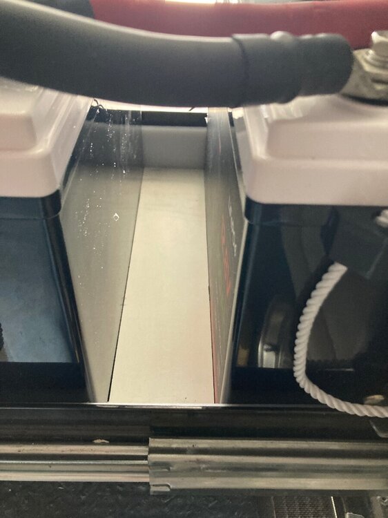

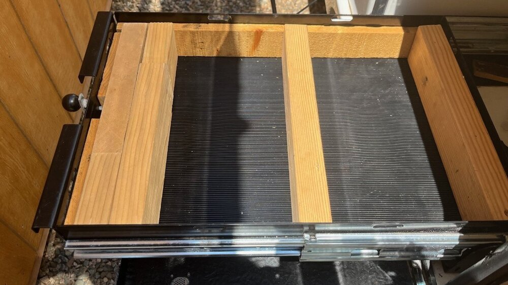

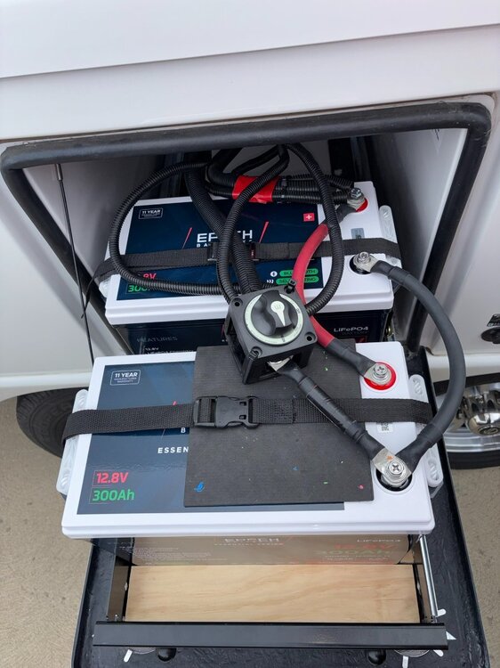

I added a 2x4 in-between the two batteries. The Epoch 300s are 7.6" wide and with the 2x4 made the terminals 9.1" apart. My OEM installation included 2 shorty cables that I gave to the guy that bought my LA batteries AND two cables were just under a foot, long enough to reuse. I cleaned them up and applied new heat shrink and did not have to buy any new 4/0 cable for my battery installation. Before and after pics below. You can barely see the original red cable I reused which is far right off the picture. The black one I reused is shown on the left. I the new installation they actually fit better, less arced.
I also added a picture of my tray design. The wood 2x4s made it easy. Notice the rubber toolbox liner underneath. I also used the same rubber to surround each battery so that the batteries would not rub on the wood.

Something important to me in determining this layout was an easy disconnect. I did not want a kill switch. Instead I needed the main B- cable, the long run back to the inverter, to be at the outer edge of the battery bay. With this layout, I can just open the battery tray to remove the closest bolt, hence removing the system ground. The B+ terminals are further in so there is little chance of me hitting them with the 1/2" wrench required to disconnect the batteries (see pic above).

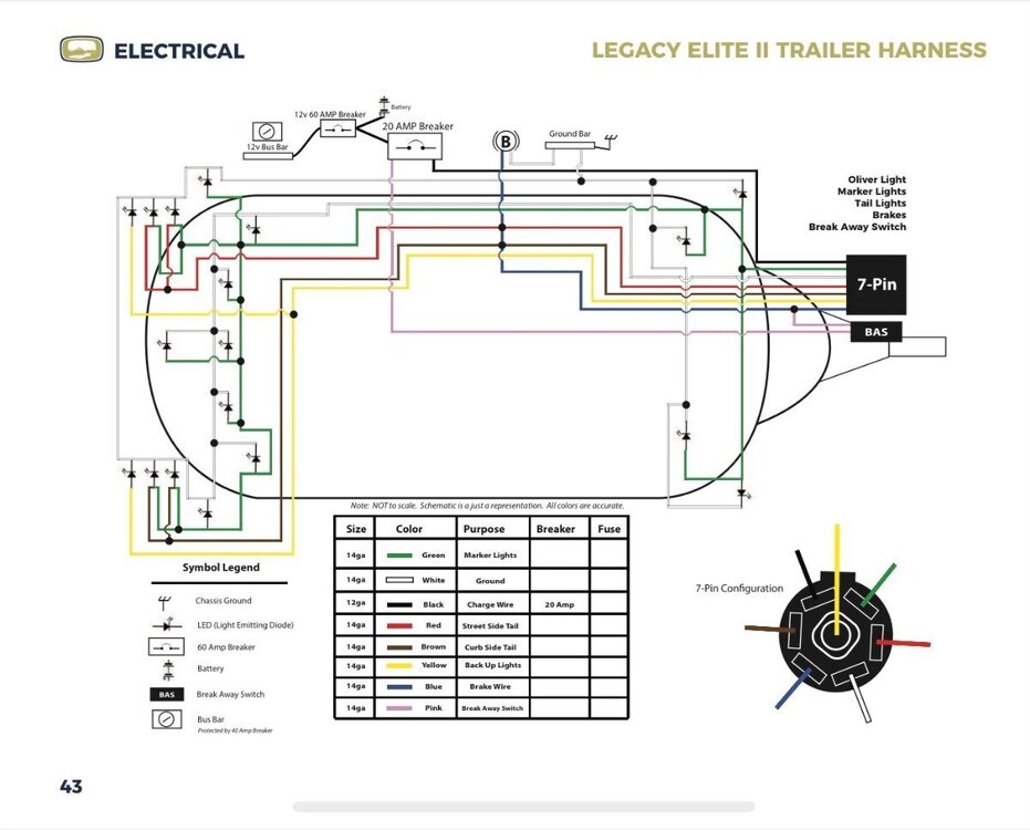

I have read that there are possible concerns about charging lithium batteries via the vehicle 7-pin connection - that lithium can draw too much and damage the vehicle alternator.  Is this an issue I should worry about.  Disconnect the DC charging wire? Did either of you make any modification?
1 hour ago, tallmandan said:
@jd1923 and @Derek B, thank you for the information and photos!
It would not damage the alternator whether the engine is running or not. When the engine and alternator are running, the B+ trailer connection is a relatively light 12 AWG wire. In the situation where high AH LiFePO4 batteries are down on SOC (and voltage), after days of camping, this connection can pull amps greater than this gauge wire can handle, which can result in overheating and could burn. And there are likely other scenarios where this connection could be an issue.
This is why many of us have installed DC-DC chargers, for charging house batteries while towing, using 4 AWG (or greater gauge) wire. Search this forum for "DC-DC" if interested in these posts.

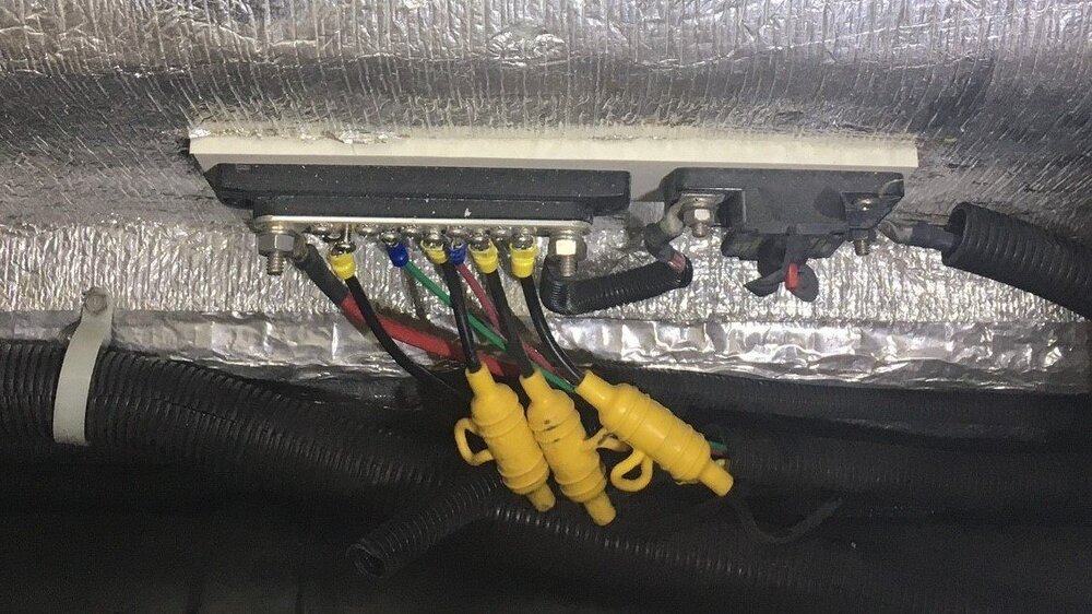

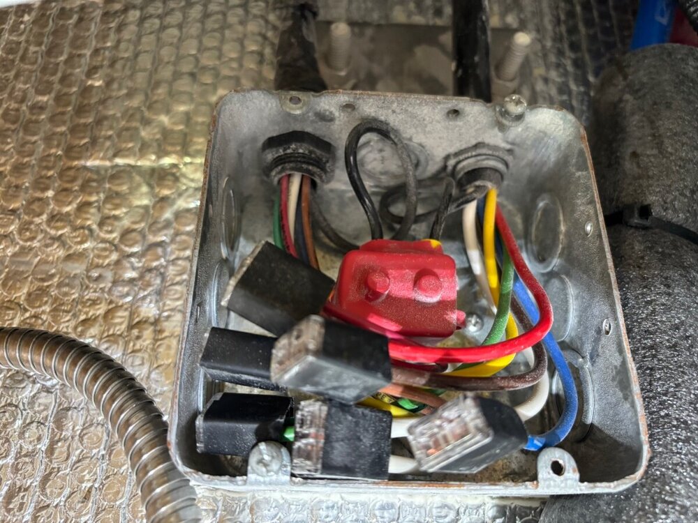

Disconnecting the B+ black wire from the 7-pin connector is easy. Something I did as soon as I found it, even before we upgraded to LiFePO4. Find your 12V+ bus which is often under the streetside bed. In our hull, it was the black wire left side of picture where you see the Phillips is unscrewed (pic 1). Afterwards, I insulated/taped the end and laid it down on the floor below. Also, on our older hull there was no extra 20A breaker as this schematic shows. Ours was hardwired to the bus.
But first step, check the 7-pin wiring diagram (pic 2) and find the B+ black and B- white wires on your trailer 7-pin plug. Use a test light or voltmeter to see 12V+ is present between these two wires. After you disconnect your black wire at the bus, check again to find NO voltage present to see if you truly disconnected the correct wire.
I disconnected the black wire from the 7-pin connector itself. Pulled back the connector housing, disconnected and taped the wire and tucked under housing upon reinstallation. The other end is still connected at the bus.
Derek and Deana | 2019 LE II, Hull #484 | 2023 F150 EcoBoost | SE Louisiana
Another way to accomplish this disconnect of the charging circuit from the tow vehicle is to simply remove the fuse for this circuit.  I know that this is available in F-150 Fords (sorry but I don't remember the exact fuse off the top of my head) and would be marginally surprised if this is not available on other similar trucks.
Of course - if you tow more trailers with some that are not equipped with lithium batteries then you might have to remember to re-plug in that fuse on those occasions.

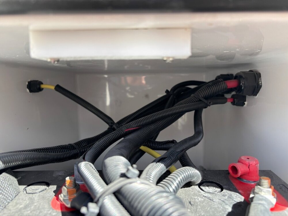

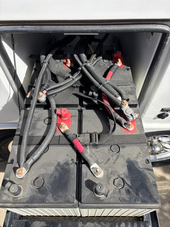

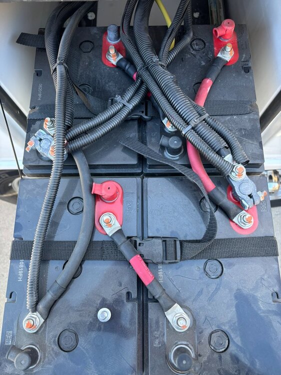

Ok so I brought my trailer home from storage today.  JD’s battery set up has a simple cable configuration.  I have more spaghetti in mine (photo) - guessing this is due to solar charging?  Do you not have solar, @jd1923?
 Looking at my main negative cable, I’m doubtful it’s long enough to reach toward far enough forward to pull out the tray as in JDs photo.  If they reach,  I suppose I would just connect all the wires to main +\- terminals and stack them…?
Now wondering if the single 460aH battery would keep it more simple with just two connection posts that could be oriented deep in the tray…

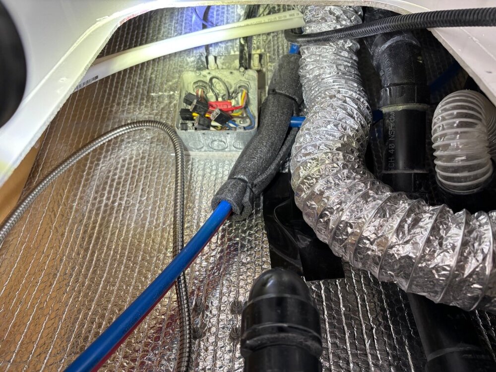

I also pulled the bathroom vanity access to see how easy it would be to disconnect the 7-pin black charging wire.  I expected to find a bus bar but instead I have this (photo) junction with some kind of permanent connector I’m not familiar with.  The black appears to be under the red rubber cover and could be unscrewed I think.  Would this be right? Has anyone done this?
Feeling less confident…
