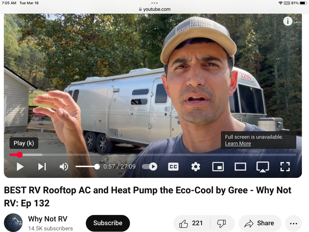

Thanks @Derek B this is interesting and I loved the fact that this YouTuber also had the Gree to compare.
My understanding is the Gree and Atmos units are manufactured in the same plant, or at least the same design and build. However, the Gree runs on 410A refrigerant and the Atmos runs on the newer R32 making it more energy efficient. @Ronbrink Ron, please confirm. Does the Gree in the video look to be very close to your Atmos? It could have a different interior plenum. We had discussions about this back when Mike @rideadeuce decided on his Atmos installation.
Geoff, you may have the noise level, dB number wrong for the Turbro unit. All I know is what was compared in the video, but watching last night I remember him measuring the Turbro at 64 dB and the Gree at 54-56 dB (which is a huge difference). He made a point of the Turbro being noisy inside (very quiet outside due to the inverter compressor) because the cold air is forced strongly down on the flimsy plastic interior cover, no internal ducting as in the Atmos/Gree. I watched another of his videos. He liked them both but mentioned interior quietness of the Gree a good 8 times!
He had me sold on the Turbro until this part. Given Gree and Atmos are similar with the Atmos being a step up on refrigerant used, I'm still in the Atmos camp. He found it to be the quietest, and I heard how quiet the Atmos is in Ron's Oliver. To me interior noise is my #1 criteria. Not working over 109F is certainly another issue, though we do not want to ever be camping when it's so hot. He also measured the Turbro using less energy (watts) than the Gree, but that the Gree was much more efficient (and obviously quieter) than the Dometic! It may take another design cycle or two for Turbro to improve their interior air handler. If a slight improvement in noise level is OK to you, this unit sure seems to perform well. Certainly better for the idea of running air while on inverter. Thanks again, Derek!

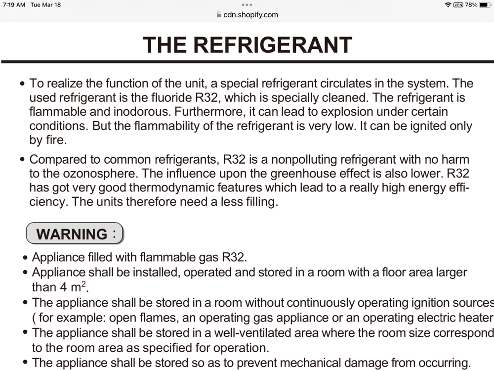

The Gree Eco-Cool Spec sheet still states R410 refrigerant and all dimensions look to be identical except Gree is stating height an inch taller at 12.2" where the Atmos states 11.14". Not all spec sheets are accurate but the upper shell can be different.

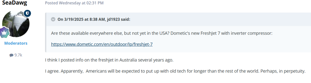

Are these available everywhere else, but not yet in the USA? Dometic's new FreshJet 7 with inverter compressor:
https://www.dometic.com/en/outdoor/lp/freshjet-7
I think I posted info on the freshjet in Australia several years ago.
I agree. Apparently,  Americans will be expected to put up with old tech for longer than the rest of the world. Perhaps, in perpetuity.
