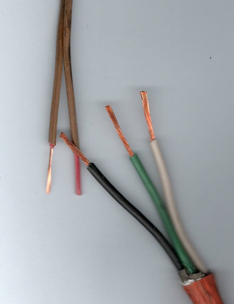

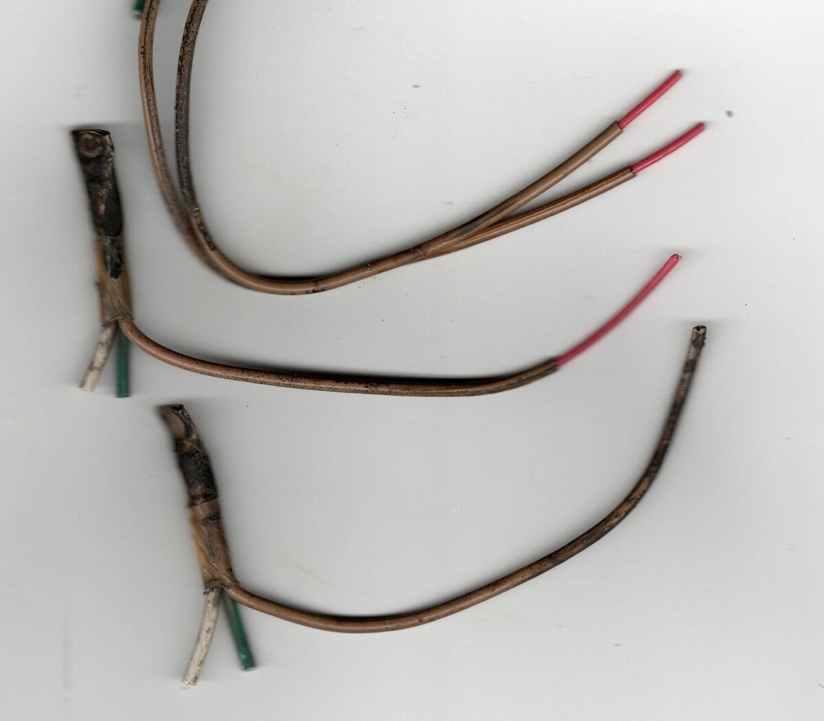

BoondockingAirstream Posted August 12 Author Posted August 12 The 'previous' mentioned Mobile Service called and their 'mobile service person' hurt his back on a previous work project and wanted to reschedule... which I passed upon. I began to self educate myself, viewing similar issues of other travel trailer owners, discovering the shorted wiring in the rear Dexter Axle 'tube'. Wow... this has been going on for decades. At $125 an hour for trailer labor... that is a lot of nickel video poker loose change for us. Our Bankroll is $20 to $40 at the three hand video poker machines and a $5 tip for a cold glass of beer on tap. Hmmm. I can get onto my 'creeper' and get to everything... now. This wiring should have been changed decades ago. A close local Travel Trailer sales and service had a two month waiting list that had, mostly, good reviews. Been under the Oliver yesterday and noticed some work had been done on the rear outside brake wiring... which indicates previous issue possibilities. The Axle Wire which shorts is the original and is the cheapest wire that you would find on an old television... in the dump. Shorted wires in all kinds of RV's and Travel Trailers, same Dexter Axle through the hollow axle and wears to expose wire and shorts out the braking system. Same issues and manufacturers continue with the same procedure. Moved the Oliver outside, onto our down hill, angled driveway to the street, for a better natural lighting. This angle gives me more space to work with than a flat garage surface. Picking up a new 7 pin plug on the trailer... just in case that may be the problem. But not optimistic that will do it. I will have plenty of experience after this... investigation. Thank You... fellow Oliver owners with the same problem and fixed it themselves, giving advice. If all fails... the options are few and expensive. 2

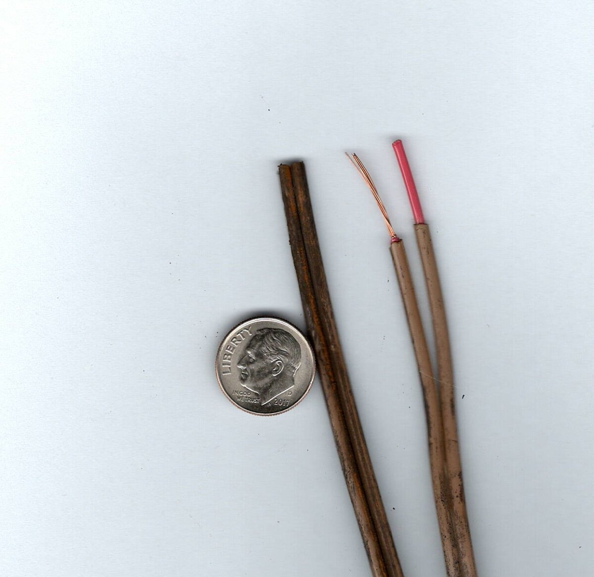

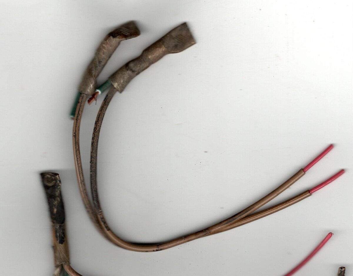

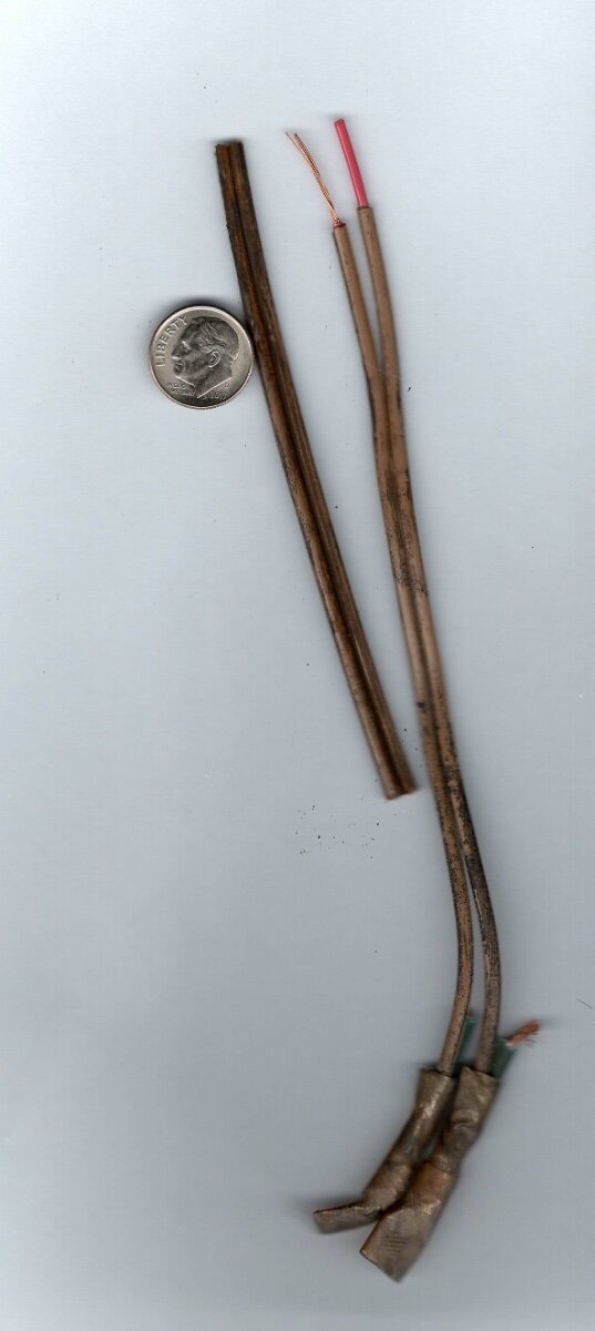

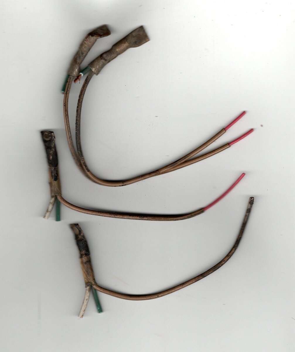

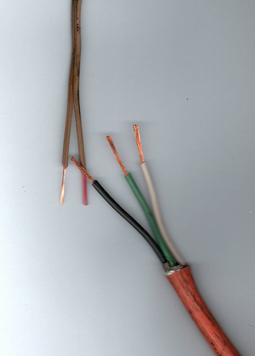

BoondockingAirstream Posted August 14 Author Posted August 14 (edited) Wiring in #448. An expensive Travel Trailer, as an Oliver, should have the BEST WIRING and be 100% RELIABLE for a decade or two decades. When removing the original Break Away Switch to test the Brakes... the eyelet for the wire to pull out... broke off. The 'bakelite' was brittle and I ordered a replacement on the Internet and it arrived the next day. Wonderful service Home Depot. All of these switches appear to be the same with different names. The switch is easy to remove, replace.. with a steel wire... got the rear wheels above the ground... Nancy my wonderful wife... spun the wheels and each wheel locked up as they should. Caveat: You may want to check yours. A year ago, it worked. The replacement was about $10 from Home Depot and delivered to our home the next day. 🙂 Many reports of the wiring going through the REAR AXLE being shorted out... should not happen to anyone. I pulled mine out and was NOT shorted. Dirty and brittle brownish in appearance. The wiring is the cheapest POS wired into a terrible location... for wearing off the insulation. I used an extension cord, picked two colored wires of the three ( heavier gauge than the Oliver option). Then had a section of a flexible water hose to run across the upper back side of the AXLE and pulled the WELL insulated extension cord through it, wired the ends to the rear brake wiring. Then six or seven nylon Zip Ties to secure the hose and inserted cord to the two electric brake wiring. It was easy after viewing a number of videos... helped a lot Lifted each side UP off the ground with my jack where a decal says where to place it... the wheels locked up after pulling the NEW Break Away Switch. I scanned the original wiring on the rear axle brakes. The RED WIRES were TINY. Maybe a bit paranoid now... but if this is Brake Wire Installations for ALL Olivers... oh Boy. I may have lost several pounds from sweat evaporation. It was 105 degrees... but I was in the... shade, so a bit cooler. Maybe. Pull off the rear Wheel to do the wiring. Much easier than working from the back side. My 'nasal hairs' are almost a thick as the RED Wires that went through the AXLE. They have the brown covering. Edited August 14 by BoondockingAirstream 1
Snackchaser Posted August 14 Posted August 14 Wiring used by manufactures for trailer brakes may seem ugly or brittle, but it has properties and insulation appropriate for the application and harsh environment where it can exposed to water, oil, chemicals, constant vibration, and abrasion. Please use caution using extension cords for brake wiring because they could have inferior wire that looks good, but with insulation that could deteriorate and fail over time. Trailer brake wire is readily available for this purpose, and it's a better and proven choice. Cheers! Geoff 2
BoondockingAirstream Posted August 14 Author Posted August 14 (edited) WHY all of the BRAKE ISSUES with wiring? On this Forum and way too many on an Internet Search. My 2019 27FBQ Airstream operates perfectly. If I have a braking issue in the Future... I will make it a point to ADD TO THIS DISCUSSION, ONTO THIS THREAD. Myself, my wiring at 75 years old, could have more experience with wire than I am discussing. Be patient... I am. Do not judge one by their appearance... Shorts of the wiring going through the Rear Axle. Plenty as well. I did not try to break the insulation, but come by and see it in person. Imagination is not a substitute for doing it. I say. But I am a Neanderthal. 🙂 Others pulling out all of the original wiring and 'upgrading'? Inferior wiring? I bet that the wire I used, was packaged and had one or more organizations giving them 100% approval. The wiring used on Antique Wurlitzer Jukeboxes from 1940 to 1949 had rayon (?) covering shielded wire and still... good. What is your experience with wiring? I may have to look over Travel Trailer wiring at Home Depot or Lowes. Purchasing from RV Dealers for an item for less at a Hardware Store? Time will tell. Ugly is not a term for undersized wiring definition. It is called POOR Choices. Will have to look over the wiring used in our 2019 Airstream. Have not had to work on the electrical wiring... yet. I am the Messenger. Everyone has a choice. I look. I saw. I removed and upgraded. Ugly is a bad paint job or poor buff. I have yet to have UGLY Wire. This wire sucked... as did some of the others. Do your 'own wire job' some day and give some experienced wiring knowledge. I did this watching others on the Internet. There are lots of excellent experience... and some... that did not really know anything... and you could tell. Several videos were like watching the person in a classroom. Made me smarter... and more confident. It worked. I stand by my results... not the opinions of others. Edited August 14 by BoondockingAirstream
BoondockingAirstream Posted August 14 Author Posted August 14 (edited) Don't confuse 20 gauge Brake Wires with a 10 gauge Extension Cord wire. (10 gauge is larger diameter than 20 gauge... in wire number confusion) Gauge numbers with larger numbers have smaller diameter copper wires. The Oliver Stock Brake Two Wires at 20 gauge are red. Gauge numbers with small numbers have large wires. My extension cord scan with Three wires at 10 gauge. The flexible cord is pliable and tough. This extension cord slid nice and tight into the 4-5 foot section of water hose. I did not scan it so you may not like white with blue stripped hoses. I do not care. I have it. I used it. I pick up pennies in parking lots. (The dime was found in a parking lot. I have good eye sight, as well.) The Brown hard material is not what I would want to use in MY Oliver if changing wires. The so called 'cheap extension cord' is what I have a few of different lengths. Look at the Diameter of the 110v+ Power Cord that plugs into the side of the Oliver. It is large in diameter. The Airstream has one that when coiled, I can barely carry it. At least I can go to a RV Park... and handle all of the Electricity that is available. When I say 'cheap' extension cord... the original on the LEFT is what you have currently. I used what is on the right. I cut the white wire back and used the Black and Green wires. I could have done it different, but I am a Neanderthal and do not care about the color. Only if it is GOOD. (The glow is not a hot undersized wire... but copper.) Edited August 15 by BoondockingAirstream

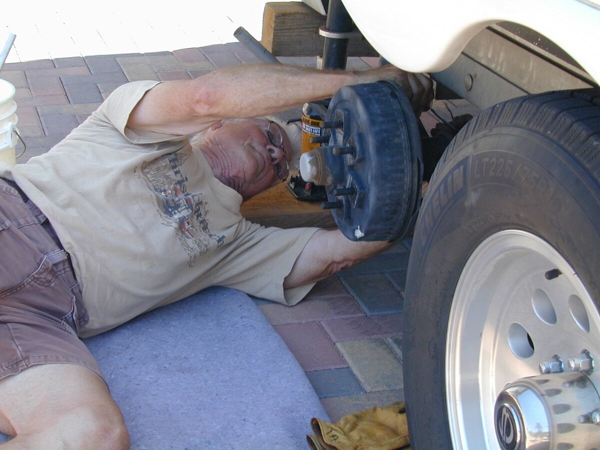

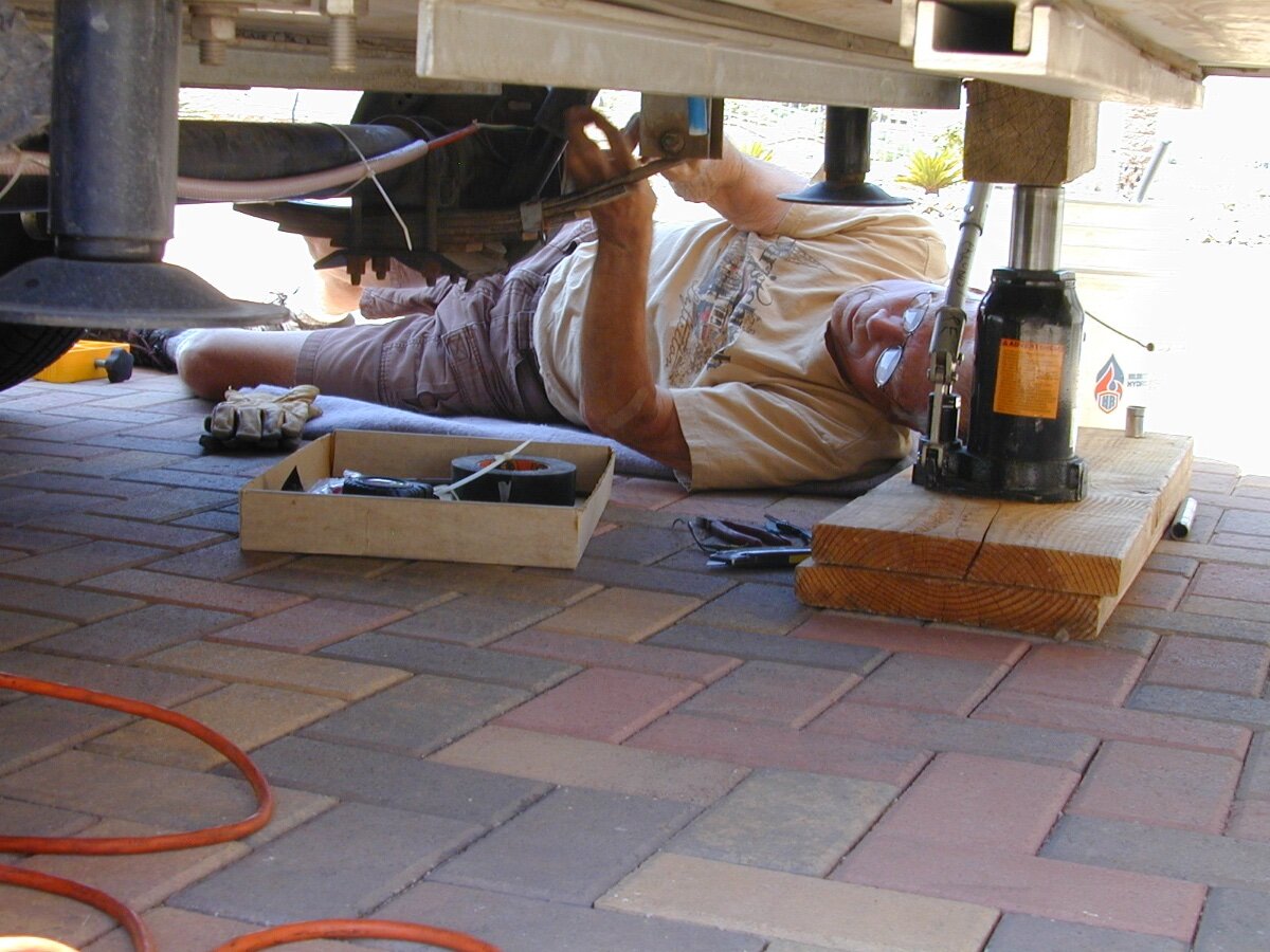

Geronimo John Posted August 15 Posted August 15 Glad you are making progress on the brake issue. Also glad you were not injured in doing so. As shown in your picture, you chose not to use your on-board jacks as safety fail safes. Yes they can get in the way, but having them down can save your life. GJ 2 1 TV: 2019 F-150 SuperCrew Lariat, 3.5L EcoBoost, 10 Speed Trans, Max Tow, FX-4, Rear Locker OLLIE: 2018 OE2 Hull 342, Twin Bed. OLLIE DIY’s: Timken Bearings, BB LiFePO4's, Victron 712 Smart, 350 Amp Master Switch, Houghton 3400, Victron Orion DC - DC, 3000-Watt Renogy Inverter, P.D. 60-amp Converter, Frig Dual Exhaust Fans, Kitchen Drawer Straps. Front Wardrobe Shelves, Snuggle Shelf. TV DIY’s: 2 5/16" Anderson System, Nitto recon’s, Firestone Rear Air Bags, Bilstein 5100’s, Mud Flaps & Weather Tech all, installed Ham Radio (WH6JPR).
BoondockingAirstream Posted August 15 Author Posted August 15 (edited) The On Board Jacks are for those who walk inside the Oliver when parked, and are sensitive to the movement once parked and inside. NOT FOR SUPPORTING WEIGHT OF THE OLVIER. We have never used them. We are not... a Prince and Princess. Myself, an OLD guy, with attitude,... and lots of previous experience doing dumb stuff when a teenager.. This is an Oliver Elite II with four wheels. The Oliver with one axle WOULD BE A DIFFERENT and you would be 100% correct. Just not this time. JACK POINT decal behind back axle tires. Lifts one or both wheels off the Earth. The hydraulic Jack was used to get the tire lifted, remove the lug nuts and remove the wheel and tire for easier access, and secure this point. Nice hydraulic jack, as well. Use it on the Airstream, as well, and... survived. I do not eat Twinkie's, either as they have too much sugar. There is a STICKER that says to USE THIS LOCATION TO LIFT THE TIRE OFF THE GROUND. There were Three Wheels still attached and a hydraulic jack with lumber stabilizing it all. When having to remove a flat tire, the same process would be used. The Hydraulic Jack makes it simple and stable. Would do the same with the F350 tires... No magic here to be confused with this. Recall I use to do OSHA inspections. Unless I have become senile... I should not be allowed to drive. The Front Axle Tires were still mounted onto the Axle. And chocked.... both sides. No need to remove them. The major wire issue all come together on the REAR Axle and through the center of the axle. ********** Added: Mike at Oliver Inc. agreed with my Wife with my process. The Neanderthal is correct and a Human Bean is Wrong. Added: I would appreciate HELP in finding the Ground or wire location from the 7 pin plug creating this short to the brakes. Most likely wires attached to the street side of the Oliver. This may have been a Factory Issue and not something that wore out or broke from use. This may have existed on DAY ONE... and I am Old and inherited this situation. Trust me. My Wife would 'kick my winky' IF I was doing something really Dumb. She is a Human Bean. I learn by making mistakes... but not stupid ones. 🙂 (I EDIT AFTER I GET THE IDEA DOWN ON THE SCREEN. I THINK FASTER THAN I CAN TYPE... SYNDROME.) Edited August 15 by BoondockingAirstream
