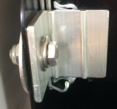

 As far as the tray slide coming open, I like Horace's (Hull 93  Maverick) Dec 17, 2020 idea.  A couple of these would increase security and would prevent movement should the slide fail.  My upgrades to his idea would be to use a Riv-Nut in place of the nut and washer. Maybe also pop rivet the aluminum angle to the tray sheet metal.  Combined, less parts to get lost when doing battery checks and service.
image.png.162130b0d21b15dd5852f14fadd41701.png    image.png.d49f8bc33f9f0af45e14fa71ecf8b512.png
GJ -
Remember that the later model Olivers have two of those spring loaded catches on the tray.  This was done to lessen the chance of failure at that point.  Unfortunately, I do not remember exactly when Oliver made this change.
As far as Horace's ideas - why not simply drill a hole for the bolt a bit closer to the sliding portion of the tray, use a wing nut on the that bolt and do away with the angle piece of metal since the bolt head will be enough to stop the tray from sliding out?
Edited by topgun2
4 hours ago, topgun2 said:
As far as Horace's ides - why not simply drill a hole for the bolt a bit closer to the sliding portion of the tray, use a wing nut on the that bolt and do away with the angle piece of metal since the bolt head will be enough to stop the tray from sliding out?
Roger on the newer sliding trays having double latches.  Likely more new ones than older ones like ours.
On the deletion of the aluminum angle:  Don't know as my Ollie is on your side of the pond.  But possible. But I seem to recall that the geometry of the area was such that just a bolt and nut was not doable.  My guess is that for our vintage of sliding trays Horace figured it out and needed the aluminum angle to make it work.  I would wager one of Art's home brews on that!
On using a bolt and wing nut: I would prefer using a Rev-Nut if it will fit.  One less thing to not get lost (nut),  Besides when leaving Ollie for some time, I would like it taking some time to open the drawer from an anti-theft perspective.  Kind of like removing the fuse from the front jack.  Make hooking up a 600# tongue a PITA.... go next door to the SOB and steal that one.

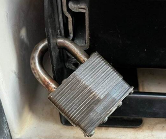

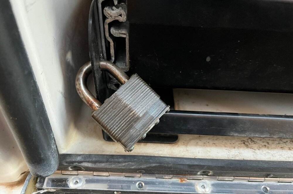

Doesn't @jd1923's post from Oct. 2024 solve two possible problems:  preventing (or slowing down) theft and locking the tray in position?

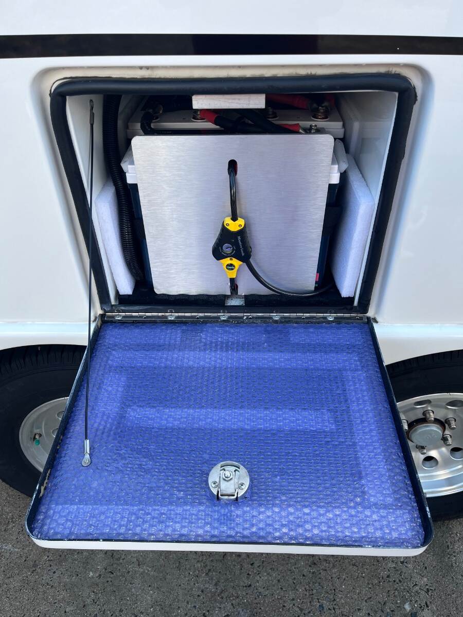

My battery tray keeper is not as elegant as Horace's or as secure as jd1923's, but it keeps my battery tray in place and it’s easy to remove and replace.
IMG_5869.thumb.jpeg.03c9efa9b2c4fa29d3ea3aff522af890.jpegIMG_5868.thumb.jpeg.7b855968e5707cfc569563119a604321.jpeg

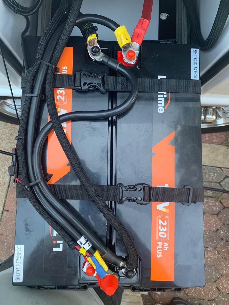

On 1/20/2026 at 5:12 PM, Geronimo John said:
Despite our OEM straps being VERY tight, twice I found one of them had gone slack and come loose from the tray hook hole.  Not good.
Early in ownership I replaced the stock 12V Bright Way SLA/AGM batteries with 6V Trojan T-105 flooded lead acid batteries. In time the off-gasses from the Trojans deteriorated the battery securement straps, both the webbing and plastic buckles. This caused the tray hooks to loosen and require vigilant inspections. When upgrading to LFPs, I made a new set of straps which have held tight thus far!
Edited by Ronbrink
Yep, and no nuts to lose either!
Not quite as cool as our updated version! 😎
Edited by jd1923
That works well for those that don't have their master switch in there.
