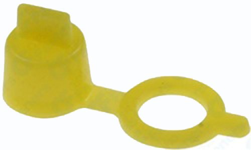

John E Davies Posted June 25, 2016 Author Posted June 25, 2016 This morning I was crawling around under Ollie and counted 12 grease fittings. Four on each of the Dexter EX Flex and one on each end of the leaf springs. (See pics below) Am I missing any?! Buzzy That should do it. How easy was it to grease those zerk fittings? Make sure each one actually takes grease, and that it squirts out around the bushing as in your first picture. Also, wipe off the excess or it will just attract dirt. Yours are installed in the "correct" orientation, as per Dexter's instructions, but many folks choose to have them face inwards so that there is no reaching past the tires, plus they stay a little bit cleaner in that location. While you do have to lie down on something to get to them, your arms will stay clean. Order a set of these, install them and keep the grit out of your fittings. Plus they will look very professional and it will tell a knowledgeable onlooker that you know what your are doing. Regardless of whether or not it is true ;) https://www.amazon.com/Grease-Fitting-Caps-Yellow-Polyethylene/dp/B0040CWX7C They make heavy rubber ones, but they dry rot, crack, fall off and are way more expensive. These will not roll into a crack or under your tire when you service the fittings. BTW how does the trailer ride with that kit? John Davies Spokane WA SOLD 07/23 "Mouse": 2017 Legacy Elite II Two Beds, Hull Number 218, See my HOW TO threads: Tow Vehicle: 2013 Land Cruiser 200, 32” LT tires, airbags, Safari snorkel, Maggiolina Grand Tour 360 Carbon RTT.
