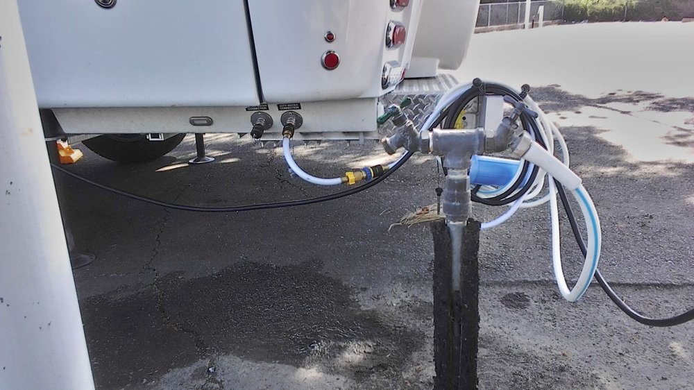

All of ours are on quick disconnects because it makes everything uniform and easy. If the water pressure is high, I will use an adjustable regulator at the faucet, then I also have the simple brass regulator with quick connects that I can add in later. I've found that the large blue filter pictured, with the carbon filter replacement, really works best when the water has a bad taste. But it also really reduces the pressure a lot on its own. So when using it, I put the regulator after this filter on low flowing water systems. I have 3 different regulators and I have left the water on all the time when hooked up for decades... Until now... :)

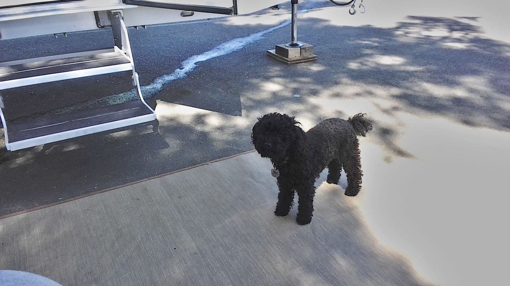

Our dog Riffles loves the water too :)
