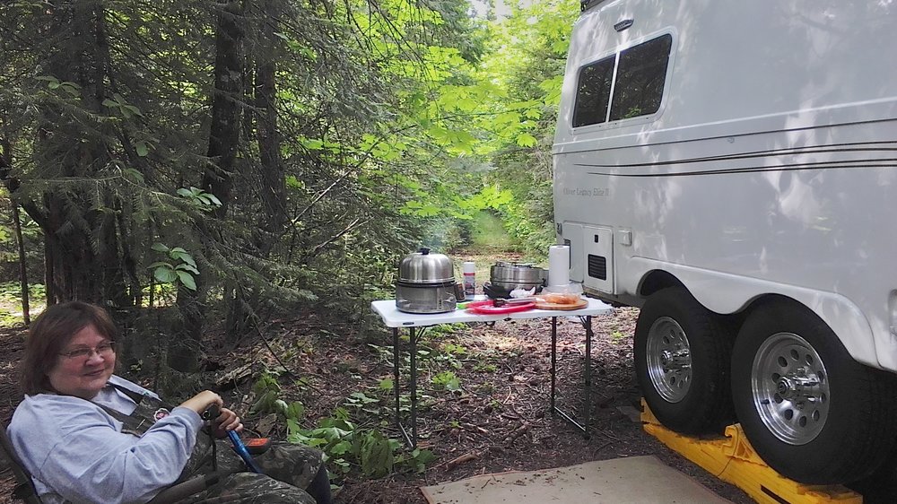

Then tonight we are using the Cobb Grill again, we really love this little Grill and have now used it to make dinner every night.
And tonight is pizza night :)

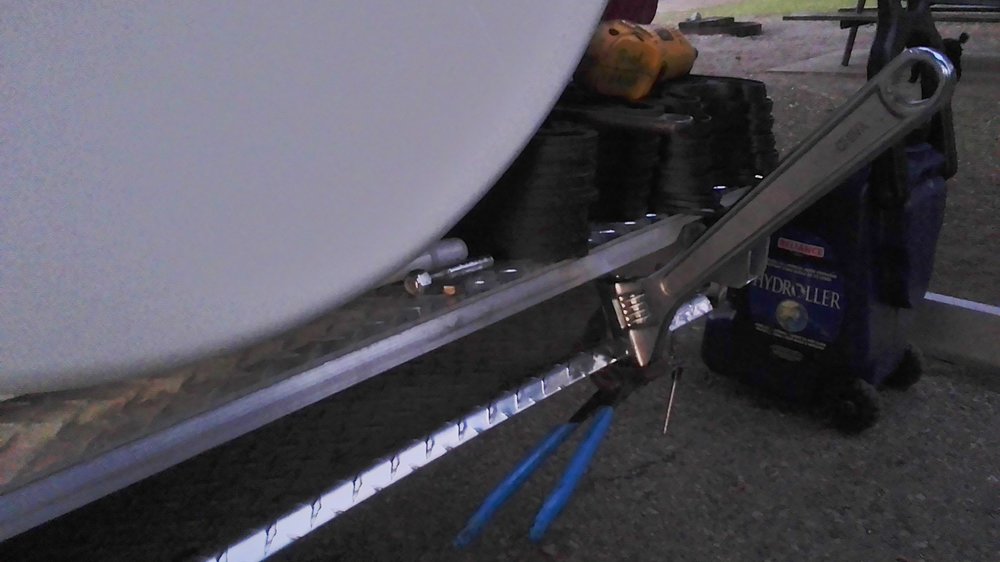

After dumping the gray tank at an RV park with the trailer leveled on full hook ups, I noticed that we were still holding 25% on the tank level. We had some good weather, so I went out and found that when we are level, the hose has to go up before it exits at the back of the bumper.
When looking at the diamond plate, you can see that it is... Or was higher on the left side
So I pulled the bumper, got out the wrenches and grinder and made a little improvement.
To be Continued...
Happy Camping,
null

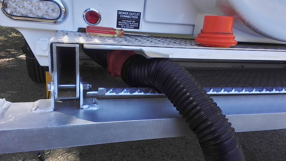

After pulling the bumper I took my 18" Crescent Wrench with a pair of Channel Locks underneath and then bent the bottom plate down to where the hose is almost level.
Then out came the grinder after rounding out the lip to make the bumper fit back on.
To be continued...
Happy Camping,
null

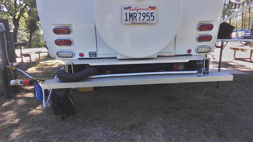

I have some more work to do, but now when emptied with the trailer level, I've gone from 25% down to 6% still remaining on the tank level indicator. I usually raise the front end when dumping before driving, except when the stations are already set at an angle for speed dumping. The other thing that we have found, is that with the shower drain back flow valve closed, this also closes off the bathroom vent. We are still experimenting, but it seems so far to really make a difference in the speed at which the tanks dump. It is a lot faster with the vent valve open, especially with the gray water.
Then also after seeing how Randy has his bumper set up, I took our Camco Sewer Slinky and separated it into thirds. Then I stack them halved again in the bottom of the hose box with the shorter section on the left, then the mid, and the tallest section on the right. Then I have the 2 10' sections of Valterra hose in back as extra. The small third doesn't get used as much and I really like it even better now, having them all separated and fitting in the bumper with everything else because it really opened up a hole in my tool closet. Enough so, that now I can fit my 8 gallon roll away water tank inside. For the drain hose I first have a 10' Rhinoflex extension, then a clear 6" section, which really does make it easy to see when the tanks are totally clean, then the standard 15' Rhinoflex sewer hose for a total of 25' that I leave hooked up all the time. I love the Rhinoflex because it is so easy to set the length with its accordion style of hose. Everything fits inside the bumper, all 45' of hose, the slinky, the extra caps and sewer connections, and a washdown wand for the toilet that we use every now and again. So far, the black tank rinse has worked ok. But we have also gone ahead and washed it out by hand at a couple spots that were set up with the water on the curb side. We just ran the hose thru the door and washed it totally clean :)

I'm really happy with our water and waste set up now. I took out the Valterra hoses that came with "Goldilocks ", (Her new name now). Then modified the waste hose opening and put in a 10' Rhinoflex extension as the main with the 6" clear piece and Valterra end on it for the usual short runs. Then I have the 15' Rhinoflex set up in the box for an add on when needed with room to spare.
So now...
It's just right... :)
