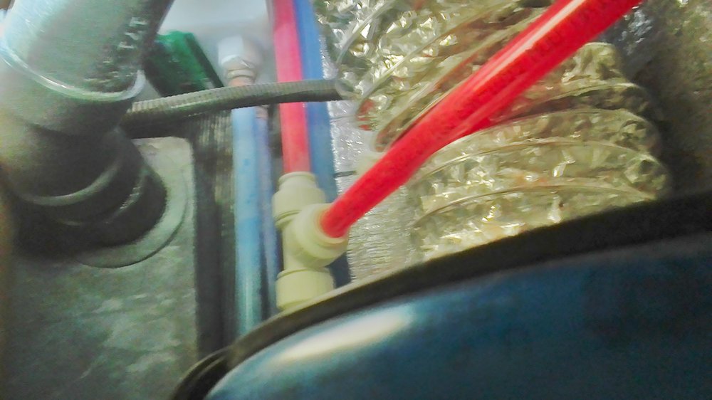

Here’s a pic of my test setup with 1/2″ copper tube. Will the comp fitting screw into my tank fitting? That I could not figure for sure until I took it all apart…. Left side hopefully screws into tank, rt. to trailer plumbing. Dave 4qp38tvzigebd9fr1eggptejos6slphg.jpg.53458369ddff6a52f49978ae954665f5.jpg
You want the 1/2" copper tubing to 1/2" pipe fitting, which looks to be what you have. The 1/2" pipe fitting will screw into the tank. Then just put another on the outside and screw it to the pex fitting that you pulled out with a 1/2" brass pipe coupling. You will want to put a good quality pipe joint compound on the one pipe thread. Screw the fitting into the tank first, then position the copper tube where you want it and then tighten the tubing nut to hold it in place. You can already have the second one tightened on the outside to the pex fitting and this will also give you a point to hold on to for tightening the inner fitting.

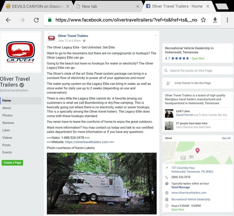

It was nice to see one of our boondocking pictures, used in an add on the Oliver face book page yesterday. Our friend Mark joined us Monday in his Bigfoot and is going to be here with us for a few days. Then we will all meet up again in Bandon, OR for the rally :)
19030363_10155154213010269_8683680875071047879_n.jpg.2e468d38b38c5510cd295ed67119f3fd.jpg

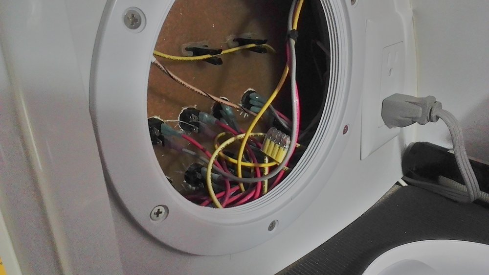

We got the Micro-Air Easy Start installed today and was surprised to see it recommended to be just held in with double sided tape. But the install was quick and easy after we got the Dometic cover off... Once again stripped out screws were installed into the cover making it a pain to get apart, but all's well that ends well and I don't need to go up there every day so that's done. The only problem now is that since we're boondocking, we don't have any shore power to plug into, so that won't get tested until next week...
Then...
The fan went out on the fridge and we had to trace that out... After running a jumper everywhere and testing everything, it was a simple fix. The spring in the fuse socket had been over compressed at one time and it wasn't making the connection. It worked fine when we picked it up but somewhere in there, the fuse wasn't touching the spring clip, so it couldn't get power. As I was going thru everything, I pulled the cover off of the switch and checked it and this was the first time that I had ever taken that cover off so I snapped a pic. So now, in 92° weather today, the fan is working and it should keep the fridge down at a working temp, I guess... I keep the fridge door by the fan cracked open so no heat can get trapped inside of it anyway, and that so far has really worked well :)
Reed

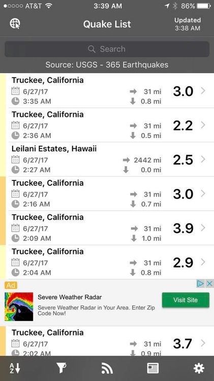

Last night I thought Karen was getting up but, she was still sleeping next to me. I knew that Riffles couldn't move us that much so I went back to sleep. This afternoon I found out that I had felt my first earth quake in a trailer ever. They weren't big, but the trailer rocked just like one of us was getting up but a whole lot of movement. We've only felt a handful of earthquakes here in the last 60 years that I can remember, but last night was a first for our Goldilocks :)
19511189_1504932932903594_8404096427034289150_n.thumb.jpg.2283ab9cdec7b679ad24a63a3fc0fd59.jpg
