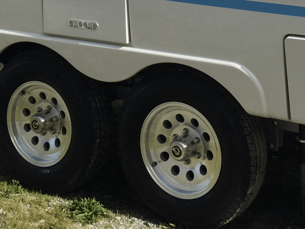

From pictures I have concluded that the supplied wheels are Ion 71 alloys with machined finish.
http://www.thewheelgroup.com/?products=style-71
Is this correct? If so, here is warranty and care information. I don't recall seeing this in the manual. Corrosion is not covered, and is due to what they call "improper care".

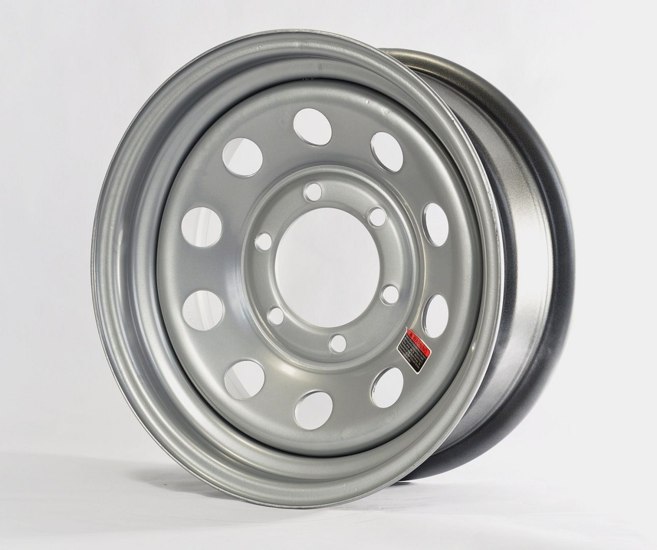

I am seriously considering replacing them with steel wheels that can quickly and easily  be refinished with an aerosol wheel paint as they get scarred up.... I would store the originals in pristene condition for a future resale of the trailer.
http://www.ebay.com/itm/2-Pack-Trailer-Wheel-Silver-Rims-16-x-6-Modular-Style-6-Lug-On-5-5-/182531823775
BTW steelies are WAY stronger than those Ions: these are rated at 3760 lbs. The Ions have a very low 2200 lb load rating. If one tire on your loaded down Elite II blows, you have immediately severely overloaded the other Ion wheel on that side. Not good!

I think you're overthinking this. Steelies are also heavier and the finish will have to have maintenance too.
I doubt anyone has had trouble wth the aluminum wheels. Remember, The 3500 lb axles are only rated at 1,750 lbs per side. So, in theory, the wheels are already stronger than the axles. Of course, the axles will take much more than that in real world conditions.

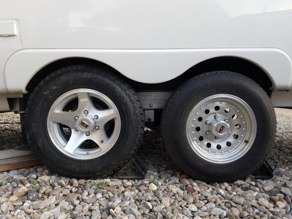

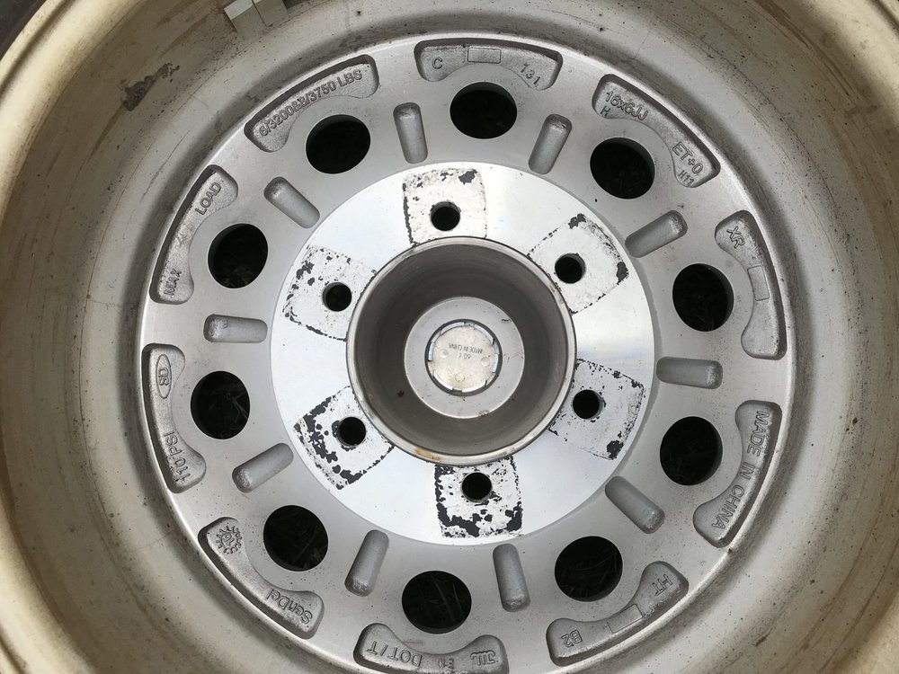

The older trailers had Pacer 162, I think that's the right model with brushed look, 16x7 with the "rivet heads"
From Yvonne's picture they've changed to something else, no more rivets. Sendel makes a similar looking wheel, could be those.
Edit-upon further review it seems they are more than likely the Sendel as theirs are 16x6 which her sticker picture specifies.
If so, they are rated at 3200lbs each

The older trailers had Pacer 162, I think that’s the right model with brushed look, 16×7 with the “rivet heads” From Yvonne’s picture they’ve changed to something else, no more rivets. Sendel makes a similar looking wheel, could be those. Edit-upon further review it seems they are more than likely the Sendel as theirs are 16×6 which her sticker picture specifies. If so, they are rated at 3200lbs each LINK
Cool, thanks, those are good wheels. I found a catalog and there is warrnty info. For wheels sold to OEM manufacturers, ie Oliver Trailer, it's four years, if to an individual, two years. I wonder why the difference?

John Davies,
For wheels sold to OEM manufacturers, ie Oliver Trailer, it’s four years, if to an individual, two years. I wonder why the difference? ???? John Davies, Spokane WA
I would have to guess that an individual owner would likely buy a product on a basis of how it looks or how much lower the price is than another, whereas an OEM would be more inclined to follow regulations and engineering standards to ensure proper setup and use, at least in the beginning before it is bastardized for nothing more than appearance

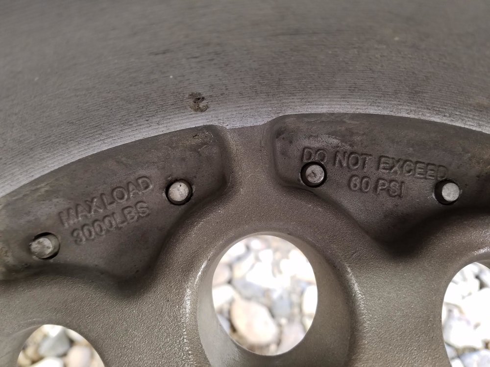

Just as a follow-up on the ION wheels.  I pulled one off this morning and looked at it.
Here are some interesting specs:
Model T-62, 16 X 7, with zero offset
Load rating 3000 lbs
Max pressure 60 PSI.
So, we can't run the load range E tires to their maximum of 80 PSI.
The zero offset number is important if going with the 16X7 size to clear the shocks on the rear and stay well within the fender on the front.
The load rating is higher than shown in the specs that were linked in John's first post.

Here is some info from the wheels on Hull #92.  I'm assuming they are ION wheels and I found T62 on them.
John
John:
I have the same information on the wheels that are on our trailer, hull # 93.

I'm pondering the 60 PSI thing too.  That is plenty adequate for the load, but it should be noted to prevent someone from going to 80 psi and then driving on a hot day to where they hit 90 PSI.

I’m pondering the 60 PSI thing too. That is plenty adequate for the load, but it should be noted to prevent someone from going to 80 psi and then driving on a hot day to where they hit 90 PSI. I bolted on a one of my new Star wheels, rated at 3200 lbs and I like them. A better wheel I think. But they sit 1/2″ inboard compared to the stock wheel (1/2″ more backspacing). A bit closer to the shock, but better as far as the fender goes. Only a small difference. Maverick: good to know you have hull 93. We may have to compare notes sometime. Do you have the Commercial TA tires too?

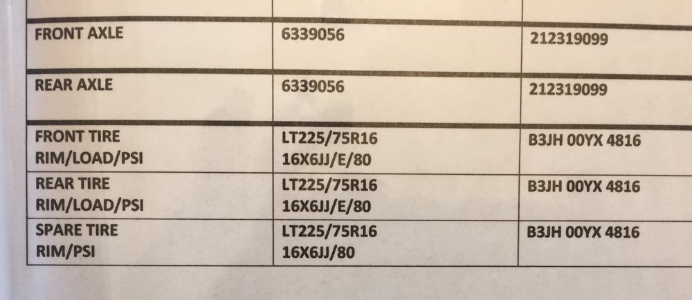

I looked closely at that picture and it says 80 psi not 60. Here is a copy with the contrast enhanced. No worries.
John davies
John,
Yep, Randy’s wheels are maximum 80PSI.
Edit:
Raspy replaced his ION wheels maximum 60PSI.
