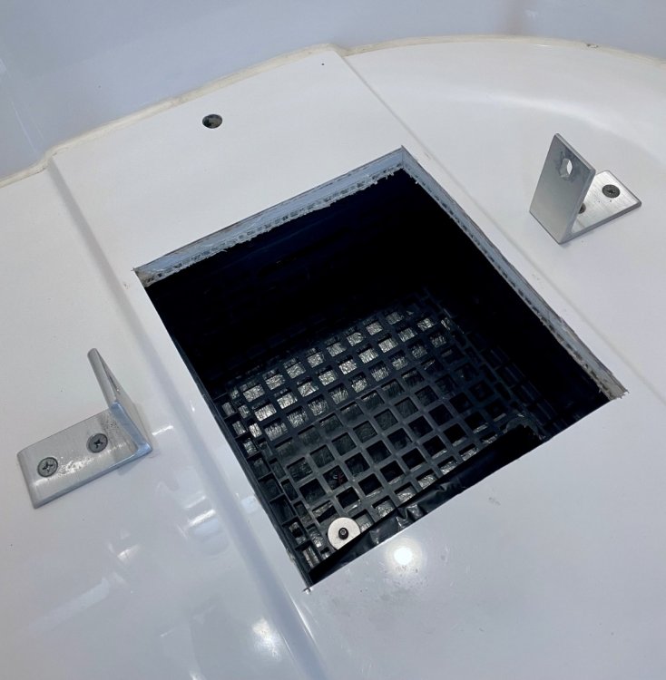

I'd be surprised if there wasn't already a strong enough floor there already given that there is a porcelain toilet sitting there whose weight is probably fairly similar to that of the composting toilet.  However, it never hurts to check!
Link to comment
Share on other sites
The floor under the toilet (the raised section) is an inch thick, with the rest being ½".  It's extremely sturdy, and in fact I've cut out a 9" x 10" opening under the toilet for easier access to the space below with no flex whatsoever in the floor (that's where I store extra bags of peat for the toilet).  You definitely do not need reinforcement.  My toilet was attached by Oliver with four screws into the ½" areas of the floor and it seems perfectly solid.  I think it would be possible, with ample patience and dexterity, to bolt through if you wanted, depending on how much of a gap there is between the black tank and the floor.  I've pulled my black tank out, but if I remember correctly I think the gap was bout an inch.
Link to comment
Overland, is the core of the floor fiberglass or wood (like the partition wall)? If the latter, it must be sealed very well, or it will get wrecked by water intrusion from showers.
I like the storage space, I never though about storing the “media” underneath. I would feel a little more comfortable with a flush fitting hatch, does water get down there, or is that even a concern? After showering I usually sluice that area pretty heavily.

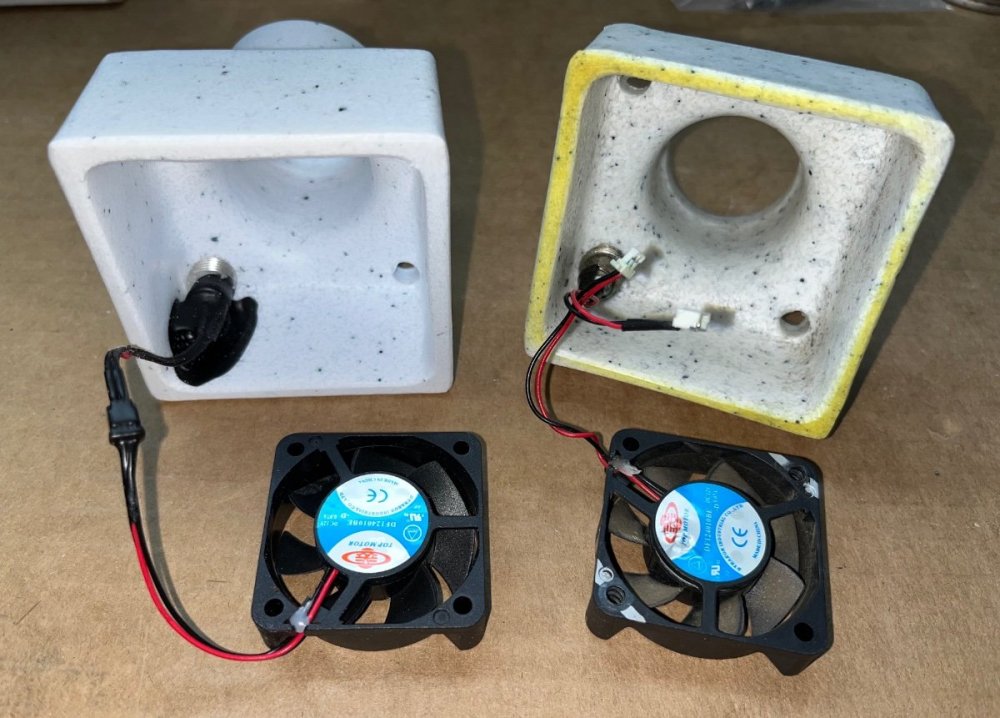

Fan failure! My fan just stopped working right before my fifth camping season.
https://olivertraveltrailers.com/forums/topic/6878-natures-head-fan-failed-the-day-before-first-trip/
An email to Natures Head resulted in their shipping ASAP at no charge TWO upgraded fan assemblies. My old fan on the right has unprotected solder joints and the tiny connector is open and corroding. The new one has heat shrink tubing over the connector and waterproofing compound applied liberally to it and to the main round connector.
I highly suggest that if your fan looks like mine, go ahead and ask for a pair of replacements. They obviously saw that corrosion was a problem and took steps to eliminate it. Bravo.
I tested the extra one to make sure it worked and added some paper towel padding inside and wrapped it all in stretch wrap, and I put it in the overhead cabinet in the bathroom for any future need.

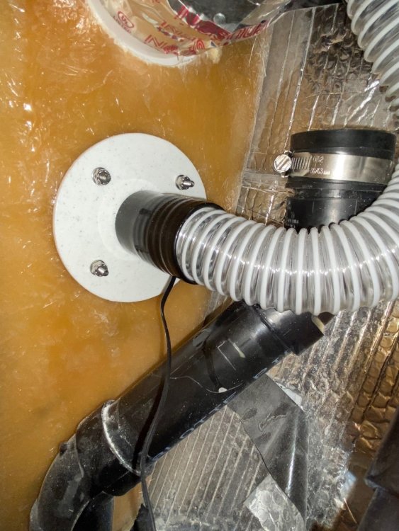

I ran a wire from the fuse box , I think I used the fuse labeled Streetside awning under the floor into the area below the bathroom sink.  We do not use the Pump switch in the bathroom, so I use that switch to turn the Natures head fan off  on and off.
I purchase an extra flange and 2 of the rubber boots for the tubing to run the compost vent into the trailer vent.  I ended up cutting out about 6" of the vent pipe from the Black tank., and you can see where I used a rubber cap to seal it.  I also drill a small hole through the flags to fish eh wire through.   On a side note, after I had finished the Nature Head Install I then decided I wanted to use the Black tank for extra gray water storage when we are boon docking.
Oops, the cap I put on the pipe from the black tank did not allow air out of the tank. So I had to open the cabinet back up, I cheated and drilled a .125 hole in the top of the rubber cap, so the black tank would vent.  I set a timer when ever I am pumping from the gray to the black tank, and only fill to 80% capacity.  I know it is venting into a open cavity. I haven't any bad smell yet.  I clean the black tank out good after use.
This is the upper portion of the tubing that goes into the camper vent system.  I used a rubber reducer to go from the camper vent size down to the  Compost vent size, and then used a piece of white PVC pipe to connect the two.
This is not good! It violates code,  and may cause serious  problems. You should seal the cap properly and install a 3/4” vent/ overflow line which connects near the top of the black tank and goes out the belly (just like your fresh tank). Your design allows somebody to connect unregulated city water to the black flush port, which will probably rupture your tank or drain plumbing, which is not designed to contain that kind of pressure. A large drain line will also allow your tank to drain correctly, which it won’t do as it is now (it will “glug glug glug” back through the drain pipe).
Also you need to add a 2.5 or 3 amp inline fuse to the toilet power wire, as per Natures Head’s instructions, to protect that small gauge wire. The awning fuse is probably 15 or 20 amps!
The water pump switch is fine, but I am not sure why you felt it was needed, you can simply unplug the round connector from the toilet vent fan, you have to do that when servicing the compost tank anyway. Normally you leave the fan running 24/7 when there is human waste in it, otherwise it gets gross inside.
Thanks, how easy was it to run wire from the fuse box to the water pump switch, and isn't there an open spot on the far right of the DC fuse box where you could add a 2.5-3 amp fuse and run the wire from there, I believe that's where Oliver run the wire from when they do the install right?
35 minutes ago, John E Davies said:
You should seal the cap properly and install a 3/4” vent/ overflow line which connects near the top of the black tank and goes out the belly (just like your fresh tank). Your design allows somebody to connect unregulated city water to the black flush port, which will probably rupture your tank or drain plumbing, which is not designed to contain that kind of pressure. It will also allow your tank to drain correctly, which it won’t do as it is now (it will “glug glug glug” back through the drain pipe).
Very good points John. Would it be possible to connect the toilet vent to the black tank vent with a "wye/y" type of connector? Also, I was thinking of replacing the black tank vent on the roof with a solar powered vent for additional venting, would that work?

This is not good! It violates code, violates common sense, and may cause serious  problems. You should seal the cap properly and install a 3/4” vent/ overflow line which connects near the top of the black tank and goes out the belly (just like your fresh tank). Your design allows somebody to connect unregulated city water to the black flush port, which will probably rupture your tank or drain plumbing, which is not designed to contain that kind of pressure. It will also allow your tank to drain correctly, which it won’t do as it is now (it will “glug glug glug” back through the drain pipe).

John ,
 I appreciate your feedback,
1. I did not like my kludge to the trapped air problem.  Sorry I do not have your common sense.  I have NO experience at cutting and adding a vent port to tank like this.  I do not know where to begin.  Maybe you have resource information on how to do this.
2.  The awning fuse slot was the ONLY fuse slot not being used on my 2020 Oliver.  I replaced the fuse with a 3 Amp when I set it up, but thanks for mentioning it so someone would just assume you could use the higher amp fuse.  Natures head states to use between 2-5amps.
3. We like to get out and camp about once every 2 months, with our schedule it hard to go out more than that, so what we normally do is let the fan run for about 2 weeks after camping during that 2 week period we are in/out the camper doing things so we turn the agitator when we are out there, then the fan is shut it off until we start getting ready for the next adventure.  We clean it out once a year at winterizing time.  In a years time, we probably have around 5 BM's in the head. So far it has not got gross inside. I always worry about having a connection failure from plugging and unplugging things all the time. I know this violates the KISS principle, but I have seen to many connector failures in the my past, and for me the redundant pump switch was not needed.
You can connect the NH vent flex hose to the existing ABS vent plumbing any way that works and meets code, what is really important is that the old black tank vent pipe is completely terminated, and that a new overboard vent line for the  black tank is added. If you are just going to add grey water to the tank, that is all you need to do. If you want to carry fresh water in it, you need to disconnect and cap the big black tank drain pipe and add appropriate PEX plumbing from that point, back to the water pump area.
I don’t know what effect the solar roof vent cover will have on the airflow through the toilet. It might be beneficial, but OTH I don’t thing it is actually needed. Have you been having issues with smells from the existing roof vent?
