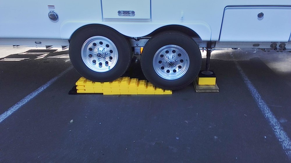

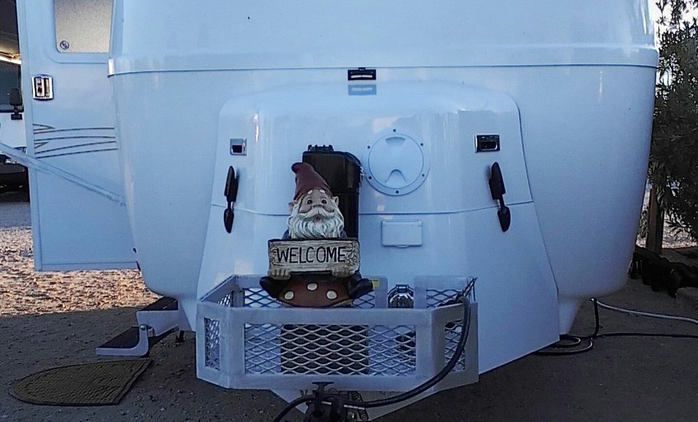

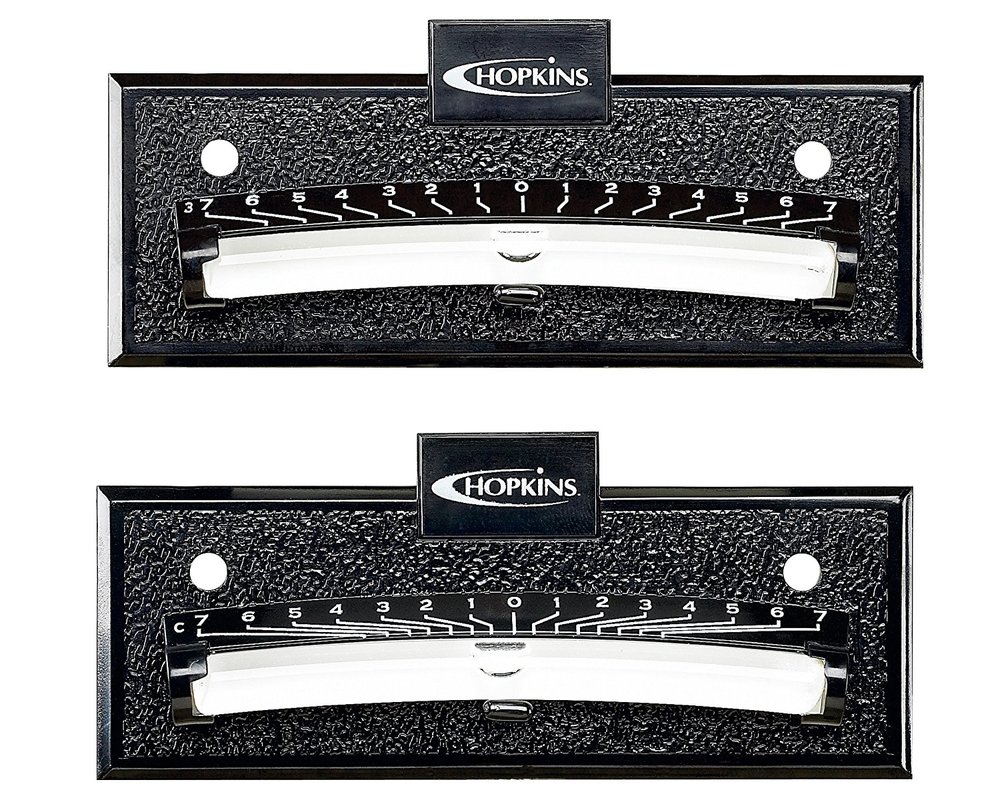

Let's start by making it as easy as possible, and that comes with the right Level on the front of the trailer. Walmart, Camping World, Amazon all have graduated levels. I can see really good so I use the Hopkins Graduated Level and have it placed where I can see it in my rear view mirror. For my tow vehicle, right below the seam is perfect.
These levels are numbered, and when the level has the bubble sitting on say #3, that means that you will need 3 blocks under the tires. I try to get it with in an inch and then use the rear stabilizers to level it out the rest of the way.
When installing these levels, one is marked for the side to side level and the other is marked for the front to back, so be sure that you put the right level in the right place. I bought 3 packages of them and have the one in the front, one behind the door when it's open, one below the bathroom window and another in the storage compartment, above the outside shower. This way, no matter what side I am putting blocks under, I have levels that I can see. Then I have 2 inside, one over the bathroom door and the other above the switch panel to the right of the kitchen.

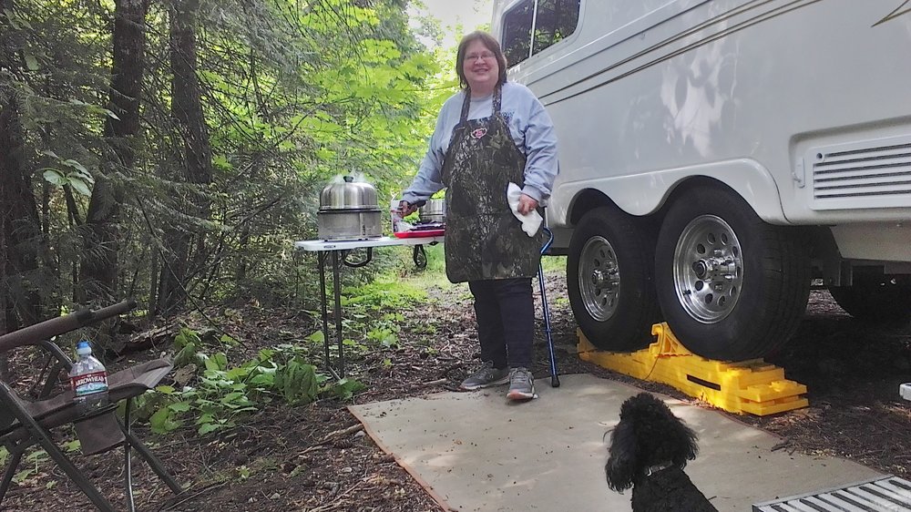

If you are using the store bought blocks, then keep using them and don't get discouraged. You can just put blocks under the tires and not make a ramp. Right now we have one trailer on top of a 7 high stack, where we started out with 2 blocks, then put 4 blocks 3" in front of the first stack. Then our friend pulled onto the 4 stack and we put 3 more for a double stack of 7 under both of his tires. For extreme cases, you will need up to 4 sets of the 10 block stacks, because you will need enough to raise the stabilizers also.
Basically, if you want to get it right the first time, then the levels are the key. You will want to take your trailer to a really level parking lot and use at least a 2' long level along the seam to get the trailer as close to perfect as you can. You want it on level ground for this so that you won't have any frame flex at all. Level it and check the level on all 4 corners of the sides and front and rear. Once leveled, take out your new Hopkins RV levels and place them accordingly. Then just use them every time and before long, you will have it right the first time, every time :)
Lot's of times I will use a full stack of blocks under each stabilizer and the front jack to keep set up time to a minimum when pulling over for one night.

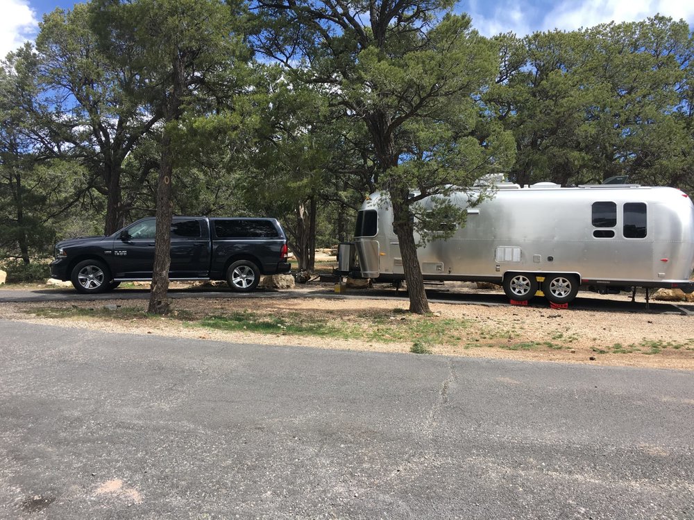

Andersen levelers.  Work great.  photo at Grand Canyon on a very uneven site but we were perfectly level. https://www.amazon.com/s/ref=nb_sb_noss_2?url=search-alias%3Daps&field-keywords=andersen+levelers20170330_195833829_iOS.thumb.jpg.10a2fd59bcddb52414515bbb95634736.jpg

I checked out the Hopkins level on Amazon. I especially like the idea of one level placed at the front of Ollie so as to be able to view it in the rear view mirror (or perhaps our Tundra's back-up camera?). While reading customer reviews, however, many commented upon the need to screw the levels to the trailer, writing that the adhesive causes the levels to slip out of level or even fall off after awhile. Did you screw yours to your Oliver? If so, do you know how screw holes affect the Ollie's gel coating? Does it easily take the screws or is there a chance of spitting or other damage? Do you know a way to cover up the holes well, masking them, if later one decides to remove the levels? Any insight(s) before I go ahead to purchase these will be appreciated.

Reed– I checked out the Hopkins level on Amazon. I especially like the idea of one level placed at the front of Ollie so as to be able to view it in the rear view mirror (or perhaps our Tundra’s back-up camera?). While reading customer reviews, however, many commented upon the need to screw the levels to the trailer, writing that the adhesive causes the levels to slip out of level or even fall off after awhile. Did you screw yours to your Oliver? If so, do you know how screw holes affect the Ollie’s gel coating? Does it easily take the screws or is there a chance of spitting or other damage? Do you know a way to cover up the holes well, masking them, if later one decides to remove the levels? Any insight(s) before I go ahead to purchase these will be appreciated. –Jeff
Just be sure the hull is really clean and stick them on... I've never had a problem with them and there's plenty of adhesives also if needed. I have the same style that I had on our Casita and they work great as is, BUT!!! the hull must be cleaned first. I just used 409... :)
Use the supplied self adhesive strips, then mask neatly around the perimeter. Seal with a good quality white RTV silicone adhesive sealant, a marine UV stabilized one, not a cheap one. It won't fall off and gunk won't collect in the gaps.
It is always smart to leave some little gaps where needed at the bottom for moisture to drain.
My level is sitting in my Honey Do box, maybe I will go ahead and install it and post pics. I am going to mount mine _above_ the horizontal seam, so it will be visible above the nifty Raingler cargo barrier net that I installed in the back of my 200. I think many folks install them below the seam, it depends on your vehicle and if you carry tall stuff in back.
BTW with gelcoat, drill your hole, then countersink the hole though the outer gel coat slightly using a bigger bit, or an actual countersink. That should prevent cracks and chips. Use sharp bits. Most gelcoat chips are pretty small and covered by whatever you install, so it isn't a big concern. Tho I don't like putting any hole in the hull unless I know the attached part will be there forever. Any hull hole gets 3M 4200 or 5300 for safety, not silicone....
