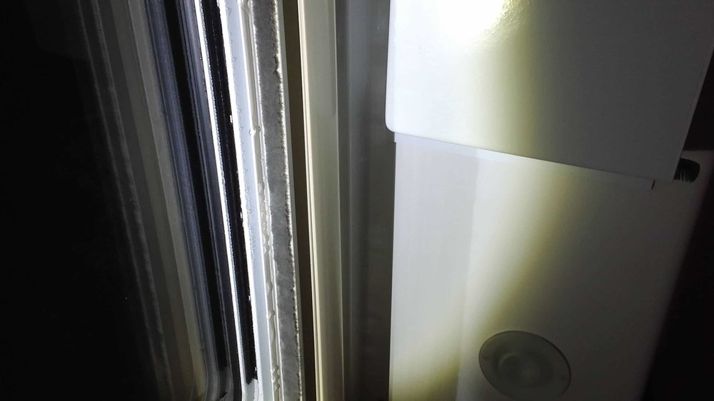

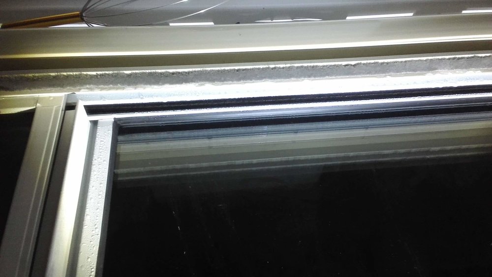

Here is a couple pics of the top inside window frame, I put the ceiling light in the picture for reference.
Lot's of water sitting there and you can't see out because of the tarp.
