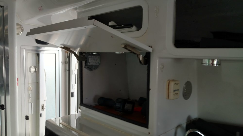

We picked our trailer up on 12/19. We opted for the storage cabinet rather than microwave. The plan was for a toaster oven but none that I wanted would fit so we made a bar out of it. I love it! Here is a picture.

Trish & Jack, I am so jealous of those white blinds.... I wonder what it would cost to replace the yellow ones..
The frosted doors look great with the "bar"

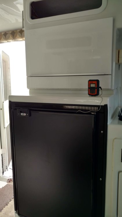

So, I've kind of mixed up the threads on the cabinet and new fridge, but, they were done at the same time...

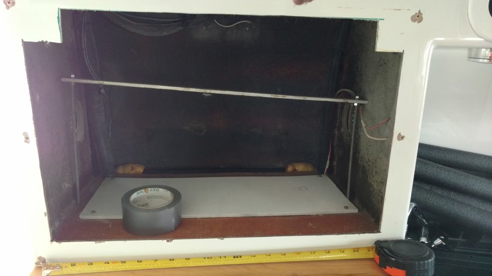

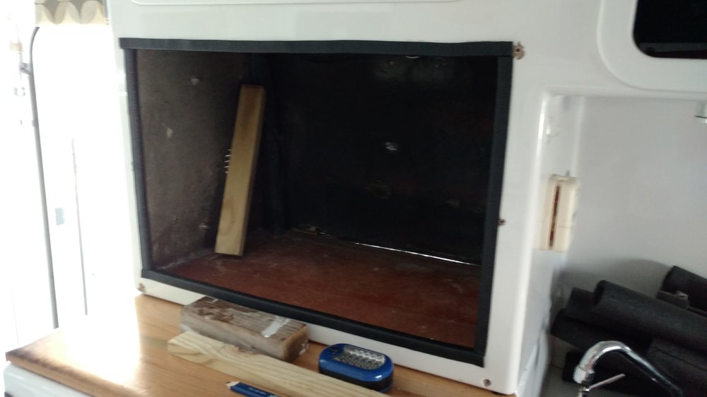

We opted to forgo the complete cabinet inset box to gain more space. Paul epoxied some strips into the sides of the cavity after squaring up the odd shaped face of the opening. The nailing strips are just thick enough to protect the wiring runs and conduits running down the sides of the cavity.
He made templates, and cut scrap 1/2 inch play to fit each side, then fastened them to the epoxied strips with stainless screws.

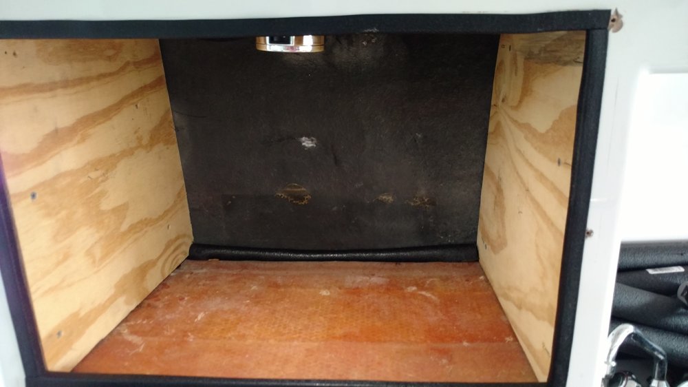

We trimmed the raw fiberglass edges with truloc 3/8 grip edge, one side grip, automotive PVC trim in black. I painted the plywood sides, and fiberglass hull top, back, and floor with two coats of white enamel. Finished the floor with some scrap Ikea heavy drawer and shelf liner.
Paul ran a 12v wire into the top of the cavity from the upper cabinet, and installed a switched led light in the area. I love that! We had one left over from a project on the boat last year.
Finally, he installed the bottom lip face, a cutdown Ikea high gloss white drawer front. Then, attached the Ikea swing up hinges to the 12 x 24 drawer front and the plywood cabinet sides. We adjusted the hinges to be quite stiff, but hopefully that will keep them closed as we travel.
An Ikea Blankett linear pull on the 12 x 24 door breaks up the big expanse of white, and matches the new drawer beneath the fridge.
We more than tripled the storage of the interior of the old microwave... I used the microwave to store paper plates, aluminum pans, and a few odd items. I think I have about 2.5 to 2.75 cubic feet of storage now in the old microwave cavity.
Sherry
And, the finished product...

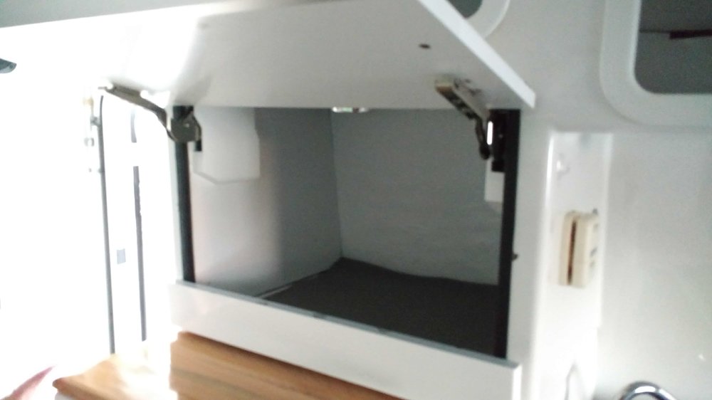

This is the option from Oliver for the no microwave and cabinet instead on Hull 364 delivered in July. There is a cable fitting on the top of the cabinet  and a chord could be run from the microwave replacement cabinet to the upper cabinet that has an outlet.
