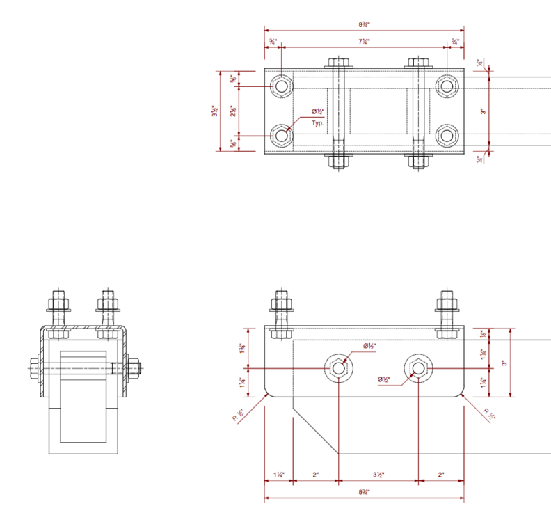

Overland Posted March 25, 2018 Share Posted March 25, 2018 John, you might be able to work out something similar to what I had to do to mount my hitch, but make the saddle longer and weld the receiver tube inside. It bolts into the existing holes for the bulldog, so you don't have to do anything to the trailer at all. You could also extend the saddle back to give it more leverage against the tongue and take some stress off the bolts. Whether you can extend it far enough for what you need I couldn't say. Link to comment Share on other sites More sharing options...
