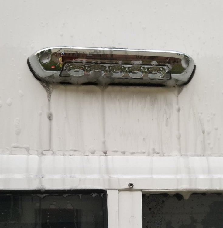

After a recent job of cleaning and waxing followed by a rain I am noticing some "fairly minor" black streaking from the rubber gaskets behind the exterior lights. It seems to wipe off pretty easily so far (since I am catching it early) - wonder if anyone else is having an issue with streaking and if so, what are you doing to prevent it or correct it?
I was told when I asked about streaking problems during our delivery that we might want to apply a bead of clear RTV sealant around those seals/gaskets in order to better seal and prevent any streaking. Has anyone done this and do you have any advice about whether to do it or not?

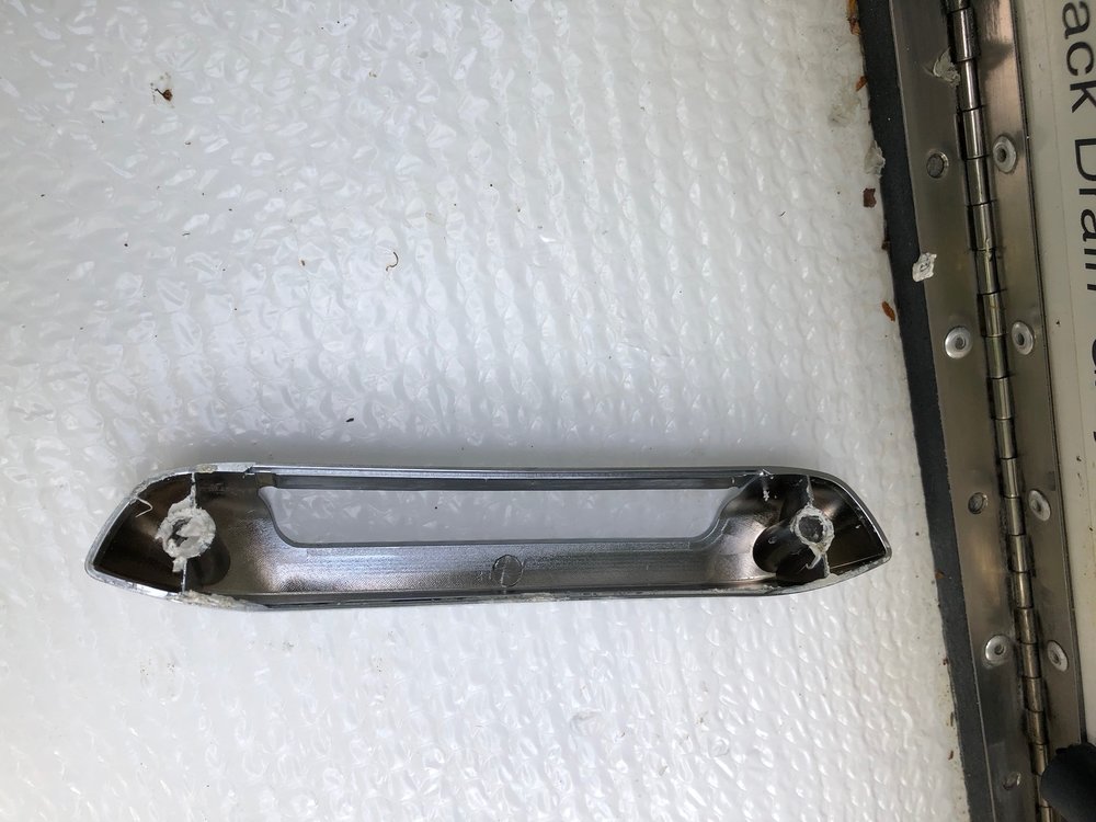

Well I decided to look at my outdoor lights and surprisingly I found that one of the was loose. It seems that when the silver plastic that is the cover for the light was screwd too tightly and broke the plastic that grips the screw to the gasket. So they ‘fixed” it by putting silicone to hold the screw in place. Now that it got loose that fix doesn’t work.
So I am waiting for a replacement cover that should solve the problem.
