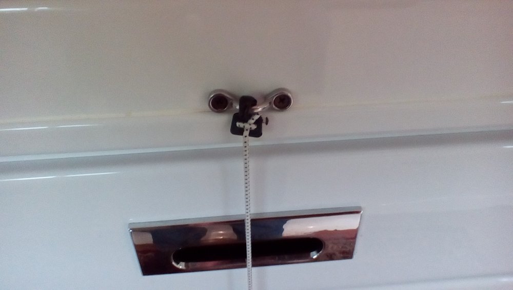

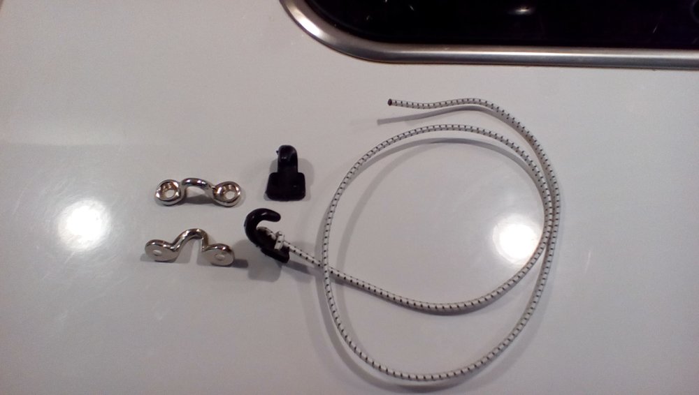

Mainiac Posted May 27, 2018 Posted May 27, 2018 There was discussion on here awhile ago about drawers opening while underway. At that time the factory was also using real short screws to attach the drawer glides. Under certain circumstances the drawers would end up in the aisle, and usually something would break. A search of the forum should show several methods of preventing. We got our supplies from a fabric outlet that carries material for boat upholstery. We used about 1/8" shock cord. Underway it just pops on. When stopped they coil up real small and fit in top right drawer. In the 5500/6000 miles since installed we have had no further incidents where we have had to repair a drawer... 3

Hikegsm Posted May 29, 2018 Posted May 29, 2018 We have had no problem with Hull #305. Don’t overload the drawers. We had no problem either...until we did. We were on pavement coming home from the factory after a service visit. Not sure why it failed then since the road was smooth although it was curvy. Anyway, as you can see the drawer was not overloaded. Oliver repaired the drawer. We have since installed the footman loops like John Davies has. I don’t want to worry about what I put in my drawers all the time. 1 Yvonne & Doug 2017 Legacy Elite II, twin bed Hull #223 2017 Ford F-250 Lariat, crew cab
