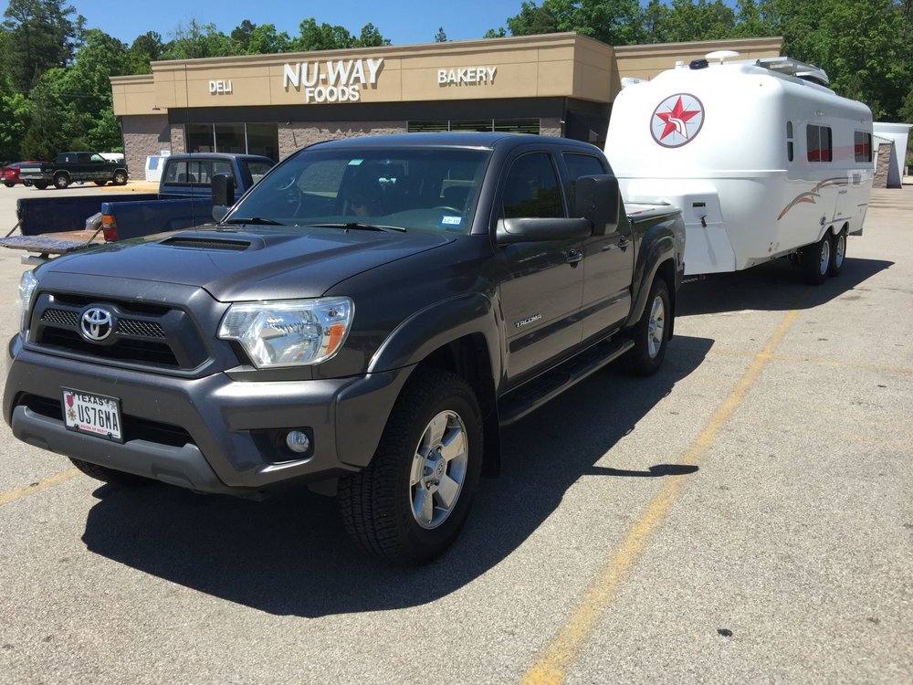

My initial TV was a 2012 Tacoma TRD Sport. It had a TRD supercharger. My Oliver weighed 5100lbs when I picked it up. I towed for about 6,000 miles with my Tacoma and it did fine. Uphills in the Ozarks were not a problem. I ended up trading it for a Ram 1500 for several reasons. The gas tank size made it necessary to stop for gas every 150 to 200 miles. The bed was not as big as a full size pickup and it was a trick fitting in the stuff we wanted to carry. Plus, it had well over 100K miles and I had the new truck itch. Mike

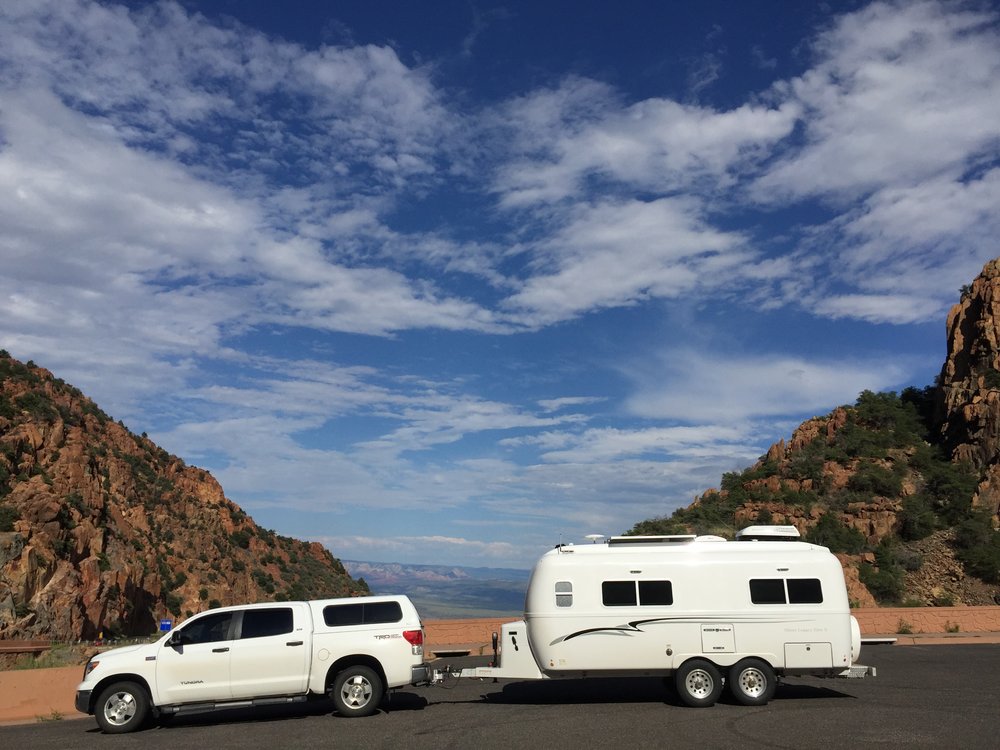

We own a Tacoma and a Tundra. Love them both. I would not consider pulling our Elite II with the Tacoma. The Tundra is perfect.
We traded in our 4Runner (we are devoted Toyota customers)--which has the same chassis as the Tacoma--for the Tundra when we knew we were getting the Ollie. At first, we thought that we wanted the Sequoia, but then realized that for much less money we could get what we needed--something to haul the Ollie, us two humans, our Pyrenees mix, and cargo--with a Tundra and camper shell. We told our local Toyota dealer that we wanted a used Tundra 5.7 4x4 in
any color, as long as it was white.
We are extremely happy with what we got. In our opinion, the Tundra is the perfect tow vehicle for the Ollie.
We weighed our Oliver II mostly "fully loaded" at  about 5600 lbs, right within Dave Phelps' 5000-to-6000 lbs range.
